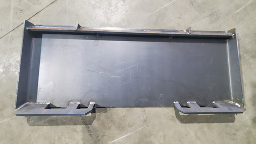

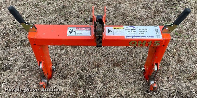

Maybe you're confusing two different pieces of equipment. A SSQA plate goes on the front for blades and stationary equipment. A Quick Attach Hitch goes on the 3pt. for the box blade, ballast box or mower.

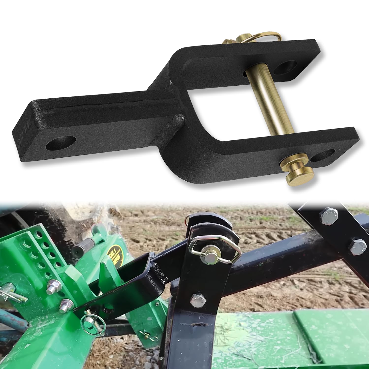

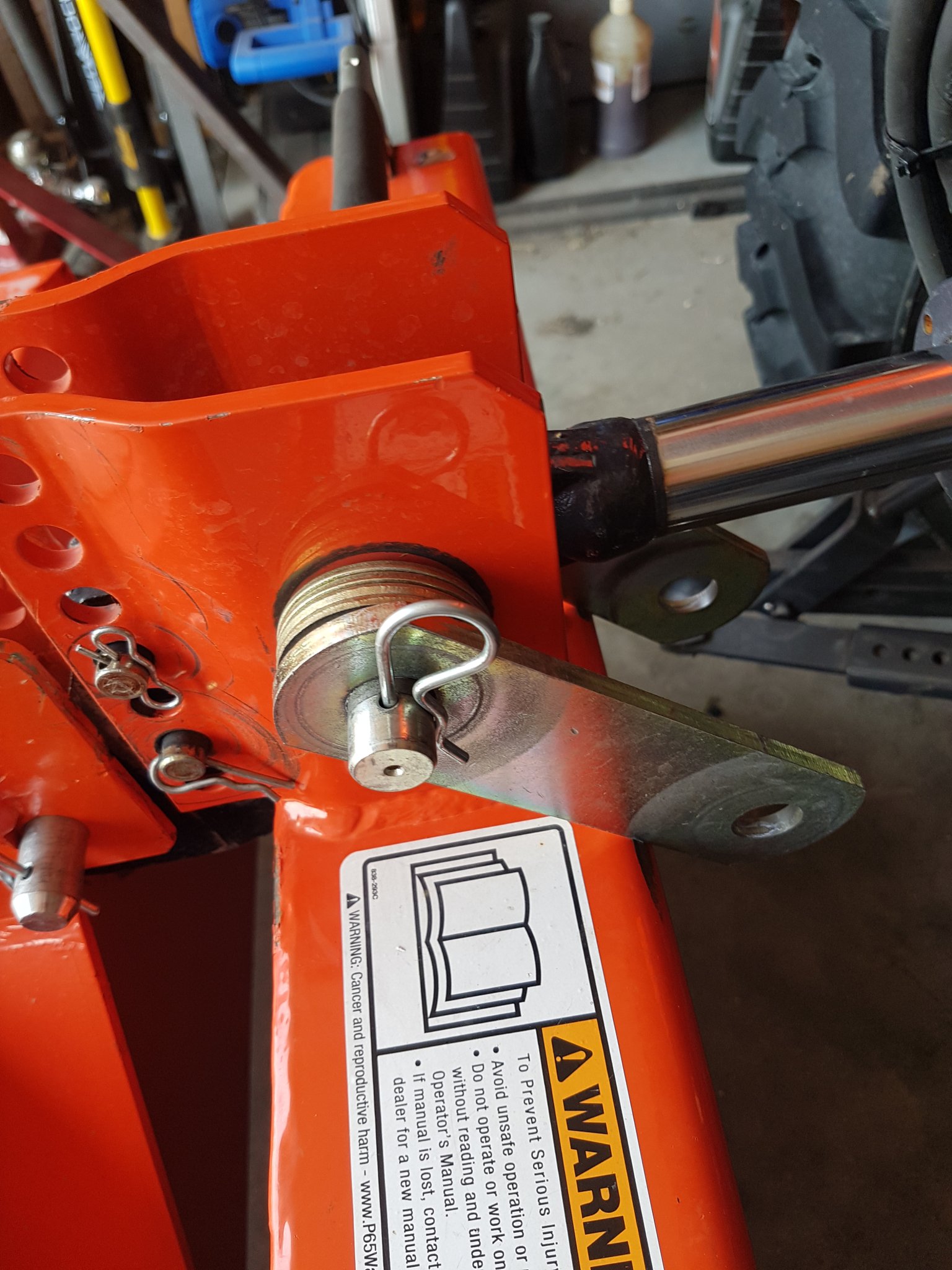

The short answer is yes you need the extra plates for a LP quick hitch. They can stay on permanently and just flip out of the way as in this picture. 20230714_131539[1].jpg
6,665
2,225
The short answer is yes you need the extra plates for a LP quick hitch. They can stay on permanently and just flip out of the way as in this picture. View attachment 160883

No the mower link is pinned to the other end of the plates and is not in the hook. This arrangement allows the mower to flex up and down behind the tractor. Other QHs can come with a similar type of arrangement as this one apologies for the green color and no pics of my setup
6,665
2,225

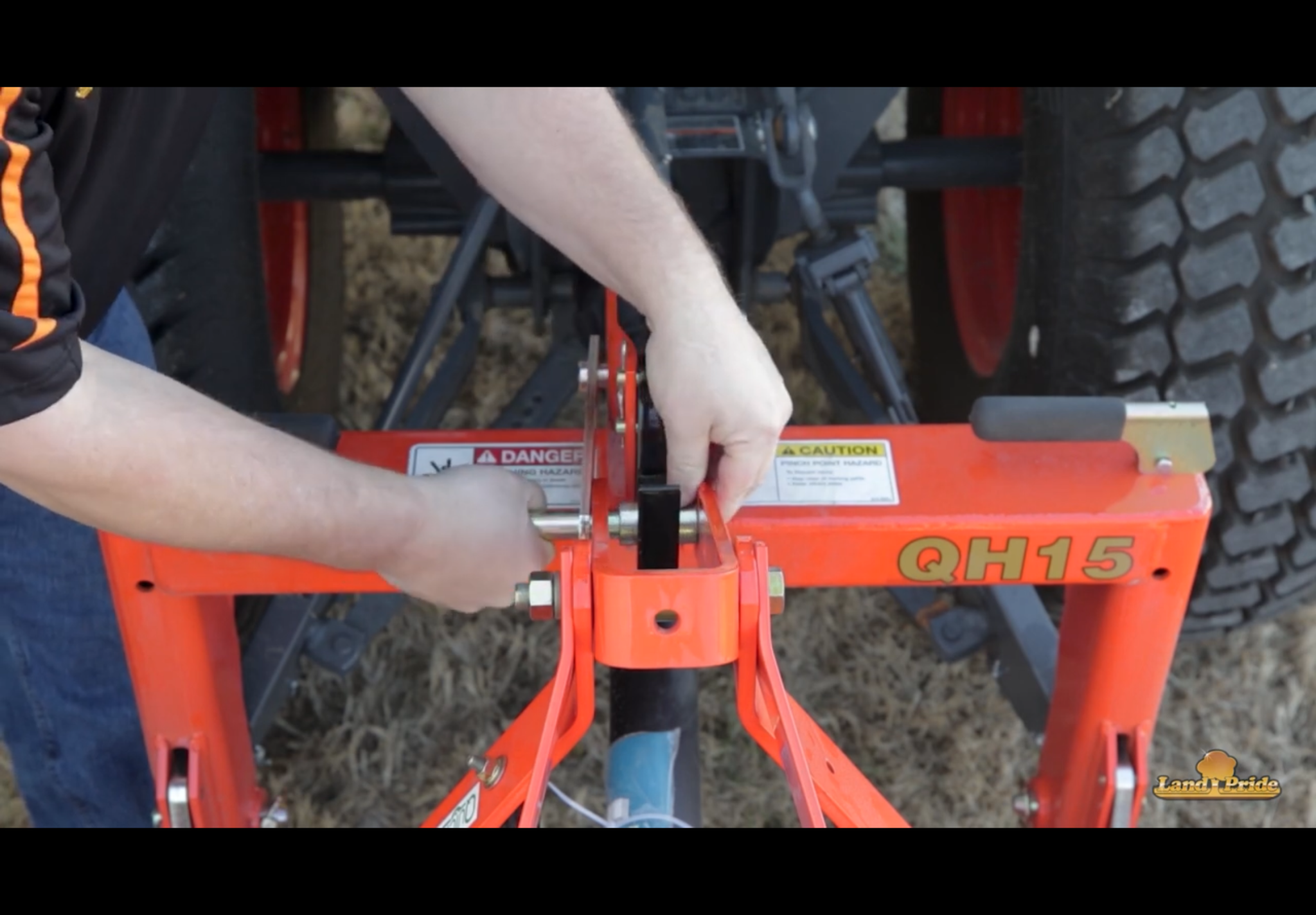

I disagree that the hook is not used. Look at the video above. Start at about 1:13 and watch him install the pin and bushing. He then makes some statements about adjustments to the top link.
This picture from the video clearly shows the bushing inside the hook. I guess I should try to find an owner’s manual and see if that explains the attachment to the quick hitch.

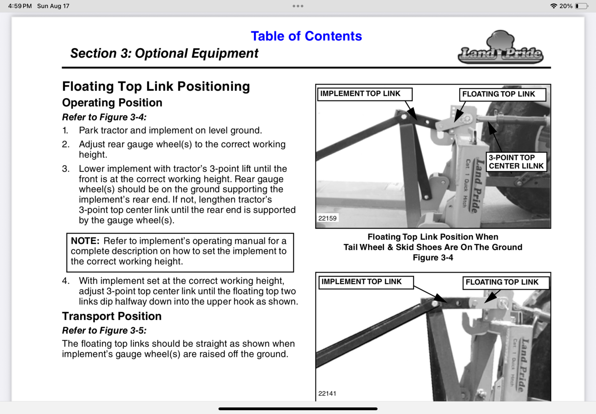

okay I found a manual and the hook is really NOT involved in lifting the implement. See the manual photo below
