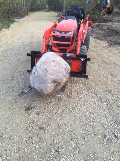

Here's a couple pics of my B2601 running some rocks around. This is pretty much the largest rock it's capable of moving due to lift capacity. Just barely gets it off the ground. Rear tires are fluid-filled so there's no issues of lifting.
I recently received a load of stone veneer for the exterior of my house and found out the loader will "hold" a load of approximately 1200lbs, with the rear getting pretty light, but will not lift at all. Definitely a little sketchy.
All in all, a great little tractor, works well, perfect size for my needs.

Nice shot; I picked up my 2601 last October after my 2620 "retired".
Love the upgrades; get yourself some ROPS LEDs and its just about the perfect set up!

... Rear tires are fluid-filled so there's no issues of lifting.
Fluid filled tires do little to nothing to ballast the machine properly to use the FEL safely, you need weight BEHIND the rear axle to do that-like on the 3PH, your box blade is most likely to light for proper ballast. The purpose of rear ballast is to transfer weight off of the front axle and onto the rear axle, so the weight needs to further back to do that. Filled tires are wonderful for traction and overall stability, but not as FEL ballast.
Those 2601's are great looking machines :thumbsup:

All this commotion about ballast and weights with lever arms and such. What really is the basic principle about best places for given weights is moving the enter of gravity to such a place as it helps the job you are working on. Take all the components that have weight and lump hem all in one place is then resulting in one weight at that location, the center of gravity. Saying weight in tires is no good is really saying that if that weight were farther from the work area, it moves the center of gravity back farther then if it is located at the rear axle. Slide your seat back and that helps some also.
It's easily possible to determine where the center of gravity is. Take any point on the tractor and multiply the weight tending to tip it backwards by the distance from that point. Any weight forward has that product shown as negative. Add em all up and divide by the total weight and you them determine where that center of gravity is as distance from that reference point .
So yiu see that rear ballast results in a bigger product in that addition, meaning it is more helpful in moving that center of gravity back.
