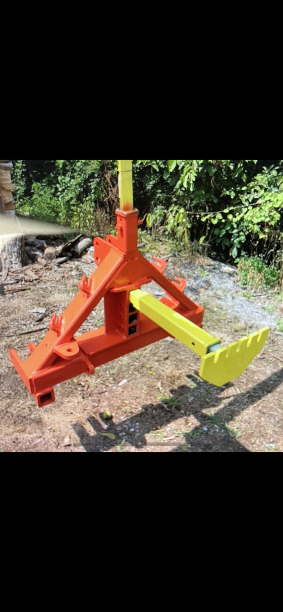

I bought a Small wood Lot three point grapple. Works Great! Never have to get off the tractor, keeps 95% of the log clean and pulls from the draw bar. One of the best three point attachments I’ve purchased.

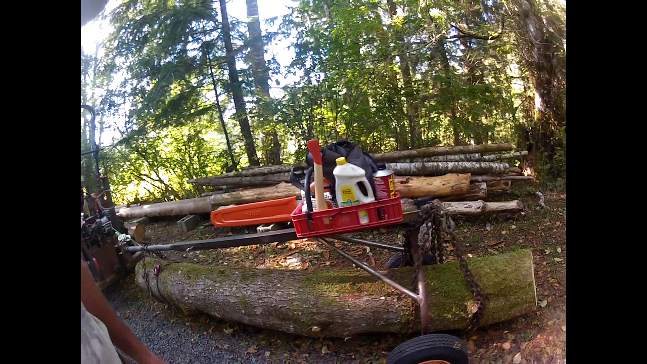

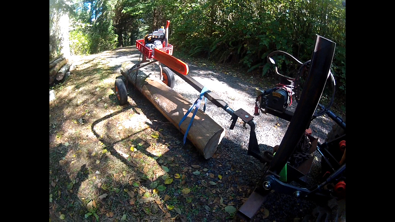

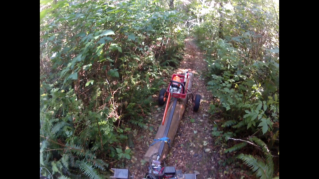

I put together this log arch from an old cement mixer, and stole the wheels off my wood spliter.

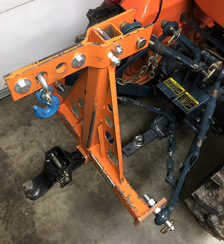

My 3-point with hitch receiver log-skidding setup. This setup helps harvest 5-8 cords of tamarack a year.
Moves trailers nicely, too.
