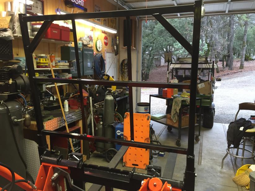

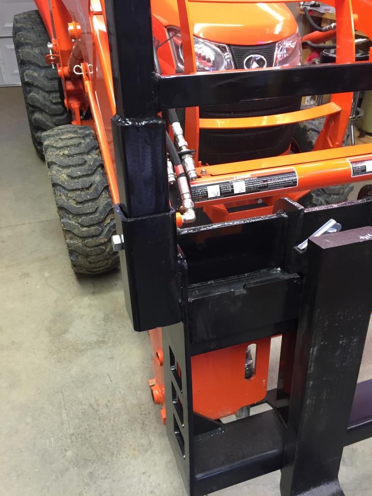

I received my 48" Titan Forks last week and just finished making the pictured back guard. I made it so it can be removed by pulling two 1/2" bolts. I have a giant home made debris box that I move around with the tractor and I needed a tall back guard. I had the material so I don't know the build cost but $100 should cover it, and about six hours labor, man I am getting old:(

That back guard looks really tall. What are you planning to carry with your forks?
And be sure to lower the forks all the way down before heading into the garage :)

I made it tall because I have a large debris box that I made and move around my property. I use the box mainly to dump leafs and branches onto a burn pile which requires raising the load as high as possible then tilting it. The box attaches to the guard.
I made the guard removable (pulling two pins) so the forks can be used in a garage where overhead height is limited. I purchased the no back guard forks so I could make my own guard and have the option of no back guard when it is not needed.
Looks good. I was thinking the same thing but mounted inside the frame edge rather than the outside..... and not quite that tall:D
