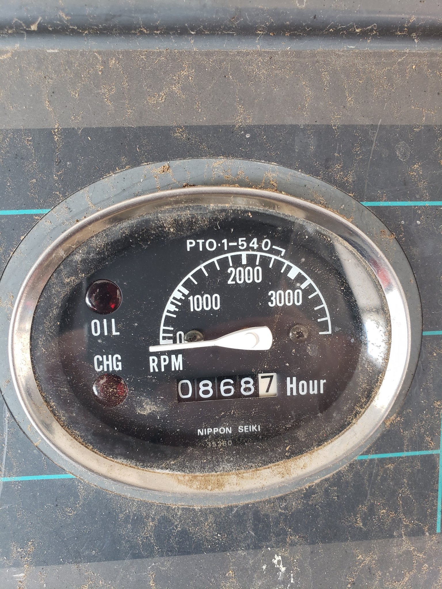

Hello. I have a L2500 thats overheating. I searched through the forum and found a bunch of solutions people have mentioned. I am in the process of going over all those now. After blowing out the radiator some of the fins still looked clogged. Has anyone ever taken a radiator out with the front loader still on? Looks like it may be doable but a pain. ALSO..where on this gauge should the needle be for the pto be at the correct speed.

According to the marker after the number 540, I would say 2625 rpm's if I'm reading the tach correctly.

If it was mine then PTO speed would be the bold line near 2800 RPM.
On mine the 540 marker points more exactly to the bolder mark
