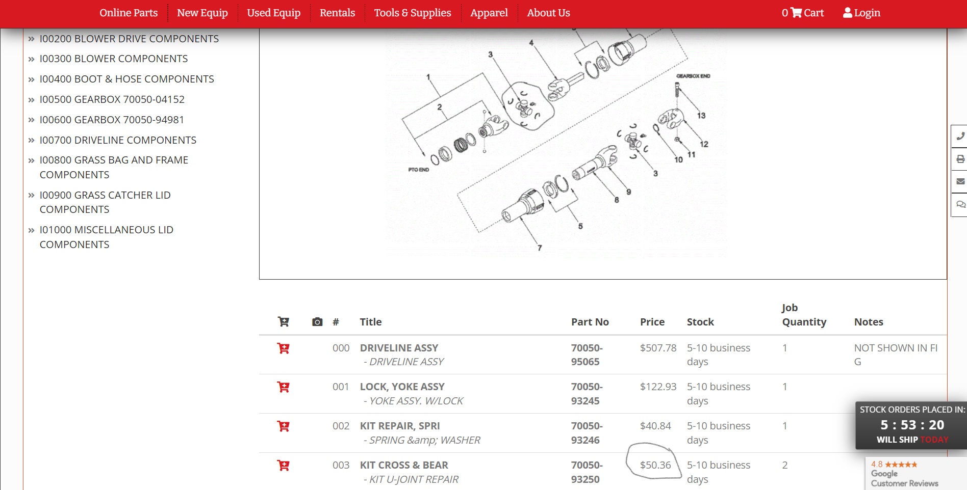

I have a gck60-23bx grass catcher and need to change a u joint kubota wants over $100 for the part does anyone know of a alternative any help would be great thank you

Firstly, what's broken? Cross bearings are relatively cheap and easy to replace, that's what usually fails and it's one part. If you broke a yoke, that's what gets more expensive because you are now replacing possibly two yokes and a cross bearing.
$100 for a complete assembly isn't really that expensive.
12,726
5,529
again, post the part number, ANY 'bearing supply store' can easily cross it to probably a $20 part....
you can walk it in, they'll measure it, 'old guy will walk to back, grab one', 'young kid has to use computer...)

Ouch, $150 for a cross bearing that doesn't weigh 20 lbs sounds a little on the steep side! Must be a real low volume oddball part made by New Holland out of unobtanium.

It's both yokes and the u joint. Kubota like so many other Japanese companies run odd ball sized stuff. If you find a cross to a standard bearing please let us know. I know on my old yanmar and the u joint I just replaced on my B series was an odd ball that didn't cross over to anything standard.
