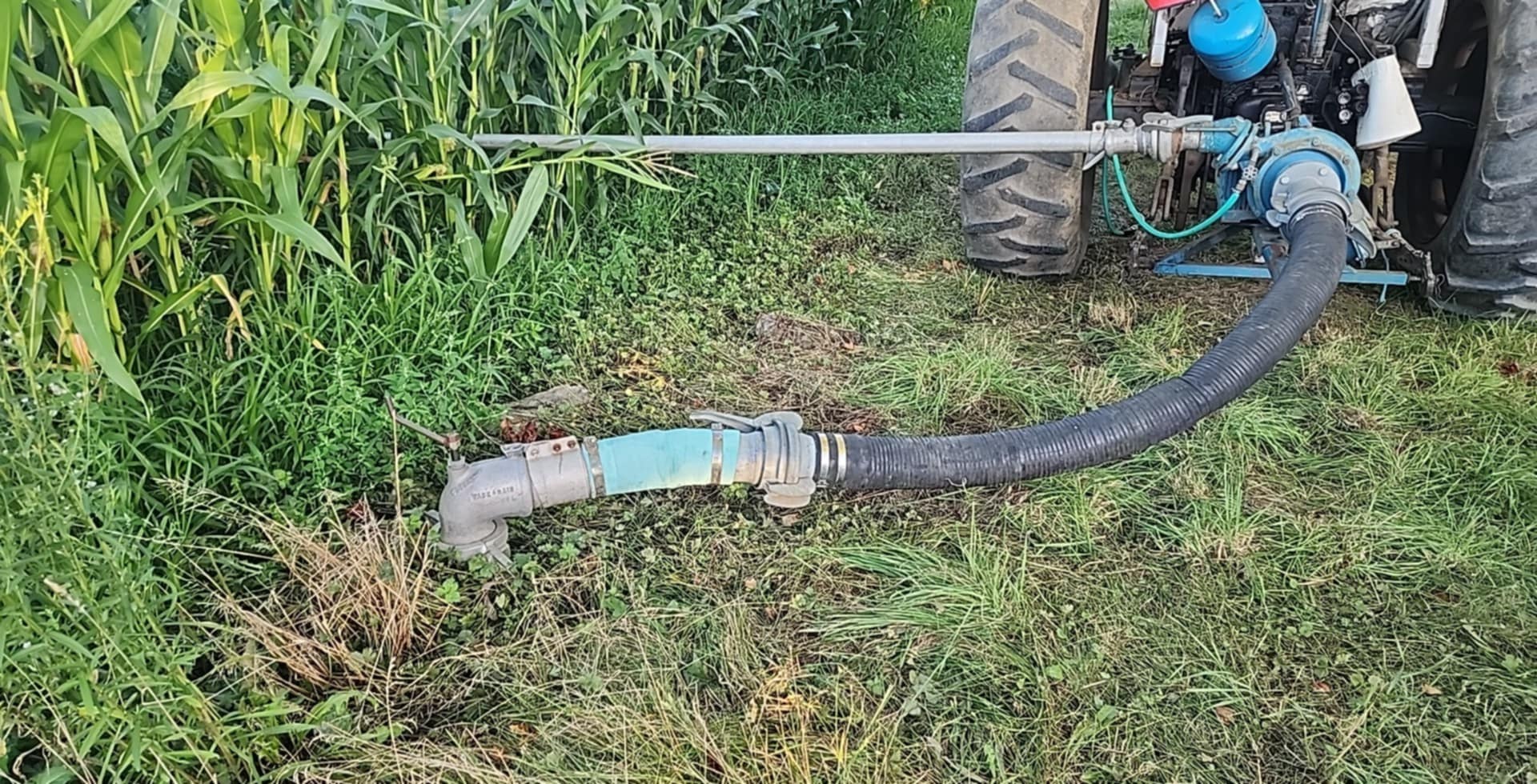

Pto pump shaking badly? Why

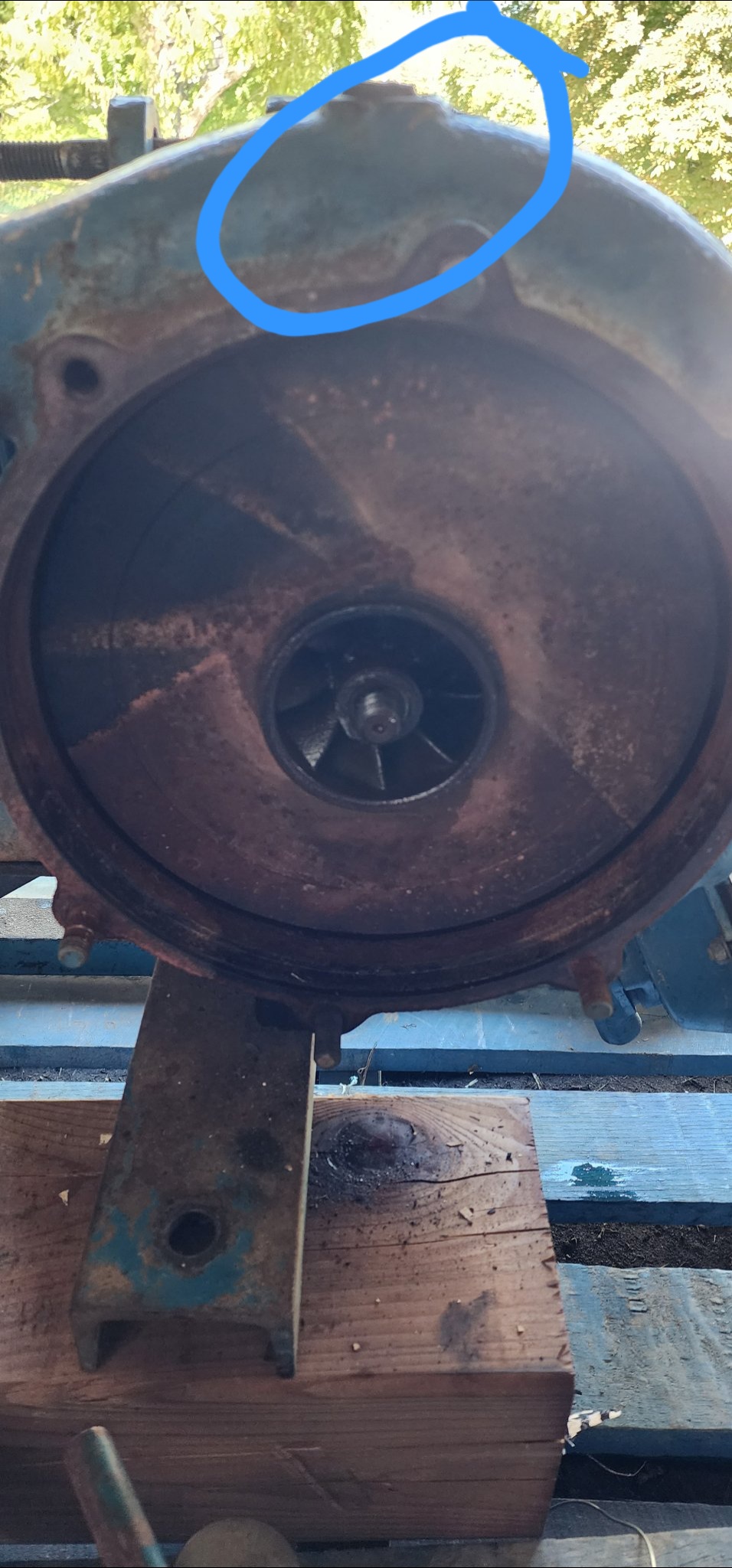

I circled the top portion of your photo. Is that a plug or something you can remove to look down inside the volute/ impeller vanes??
Based on your two videos, I think your getting cavitation in there. I'm not hearing the tell tail sign of pumping marbles, but with all the vibration and bouncing, I think one or more of the vanes on that impeller are plugged.

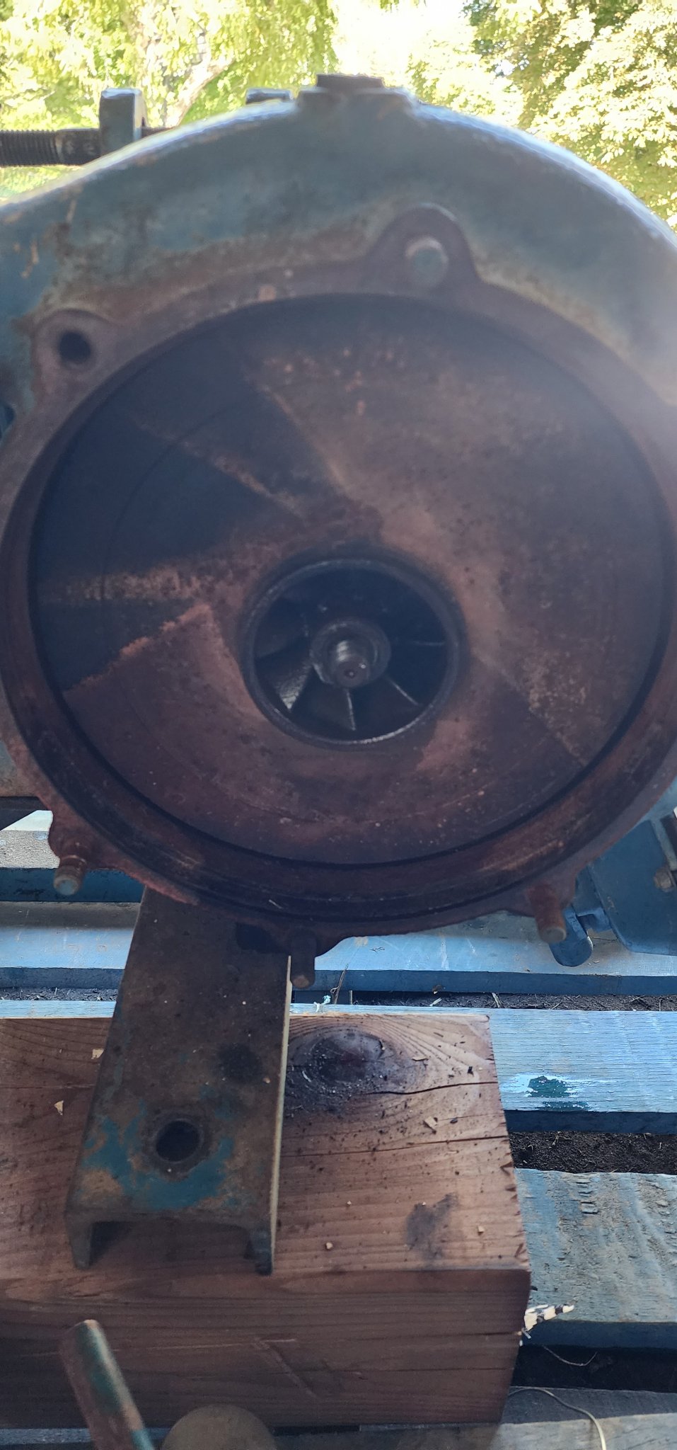

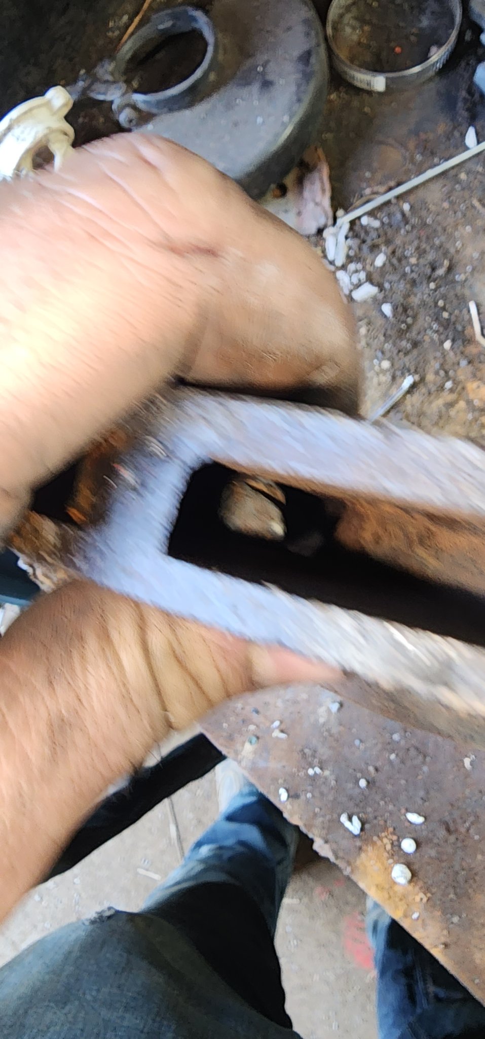

I can look in through the side outlet. I can get a wire through each slot though
Then It's probably some internal issue then.
Bent shaft, bad bearing, or it just rattles like the dickins and there ain't nothing wrong with it.

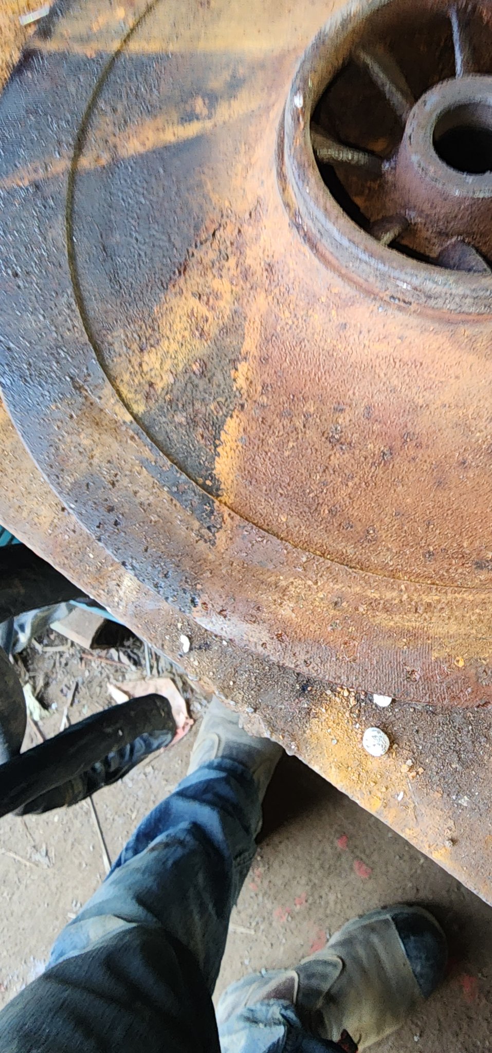

Got it, rock in there
10,873
8,478
I wouldn't begin to know where to get an impeller for it. The parts site I found showed the impeller out of stock.
Might be worth it though to take the impeller to a machine shop and have them check it for balance before reinstalling it. Of course, thats after you remove the rock from it.
As far as the wear marks go..... I have know idea without seeing a photo of another impeller.
This is where i found the parts for it.
Edit: looking back through the parts, it does show an impeller available on page 3 🤷‍♂️🤷‍♂️🤷‍♂️ I wonder if one's stainless and the other is cast iron.

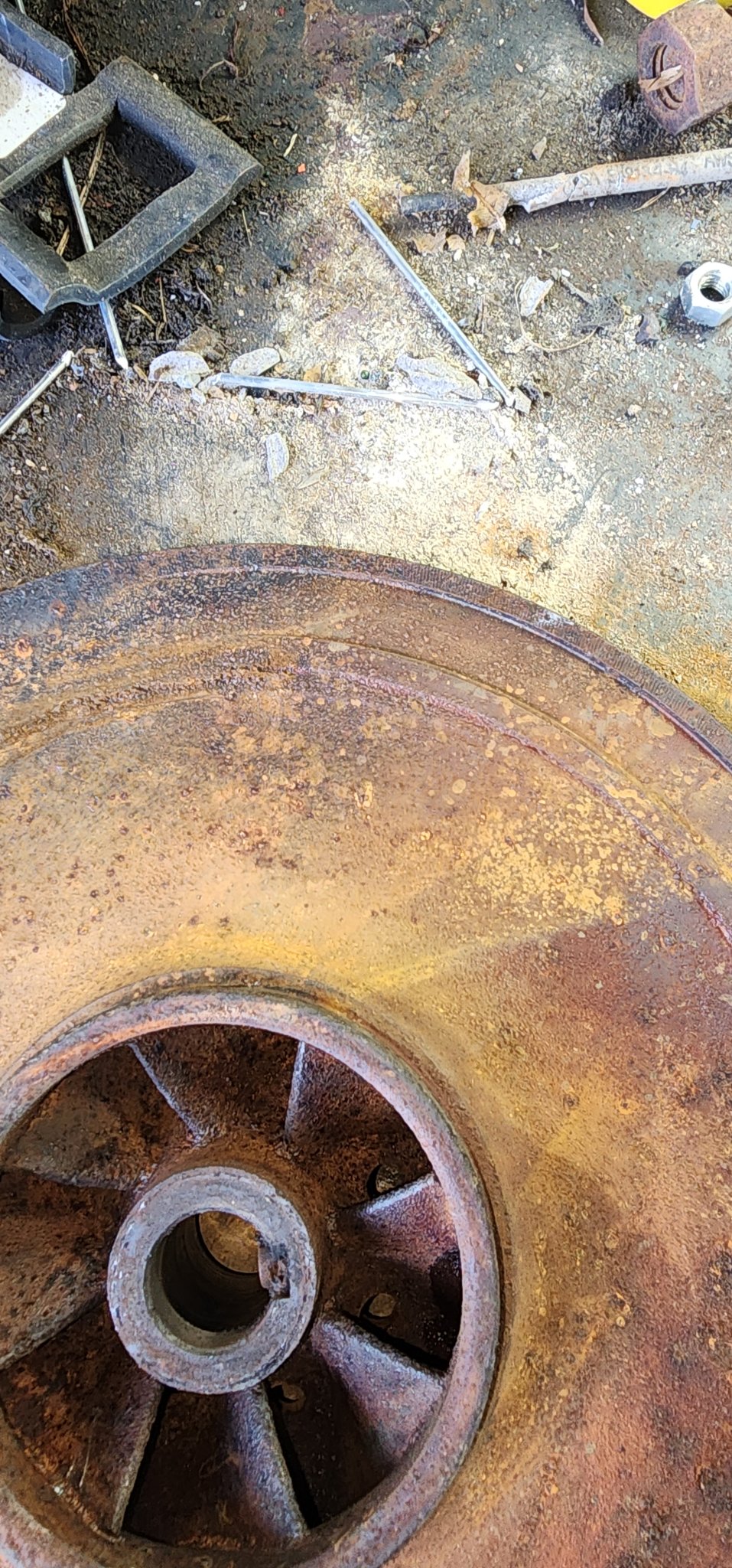

It makes pressure so maybe just balance it
6,694
2,245

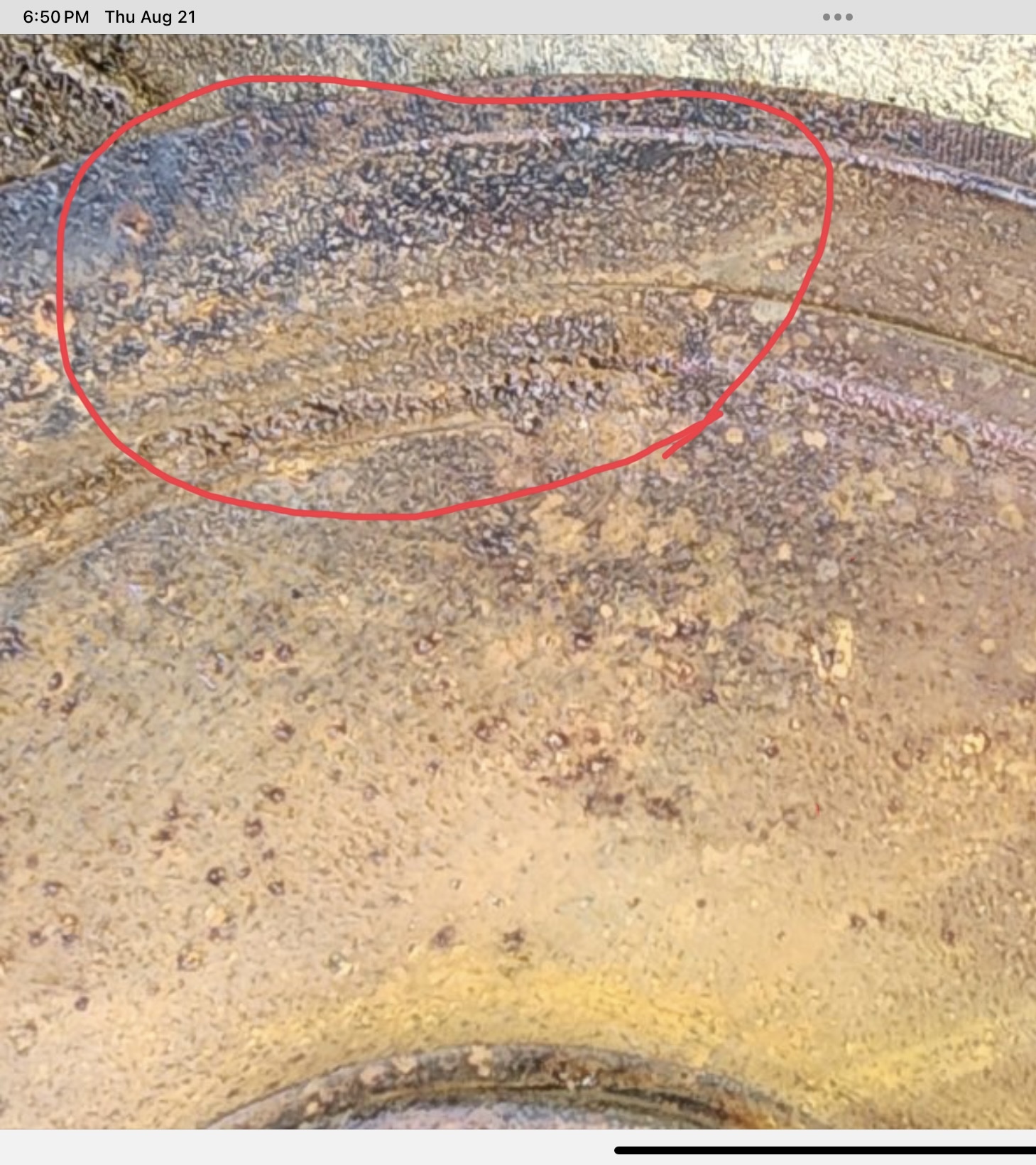

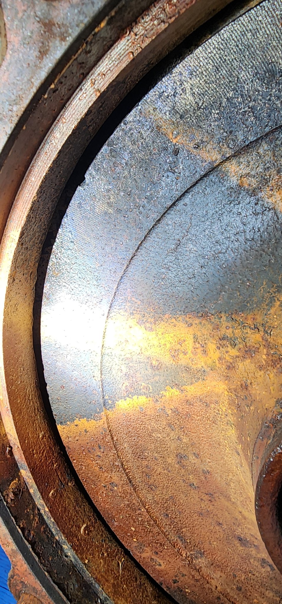

Also I assume it's by design but there's this weird groove that's not the whole way around too
To me it looks like the impeller has been rubbing on the case and has worn down the impeller. That rub would certainly create vibration. I circled what I think you are talking about in red.
Look in the case if you can and see if there is evidence of a rub on one part of the case.
I think that would be from a failed bearing or two letting the impeller hit the case. Are you replacing the bearings?
Hadn't planned to theres no play or movement in the bearings and the seals are good. There's no signs of wear on the casing.

I took it to the machine shop nearby they work with alot of pumps. He said that grove is likely a bearing failed and someone fixed the bearing but didn't fix the damage. I figured I'll have it balanced while it's out. The wear ring is most important and that's still good.
