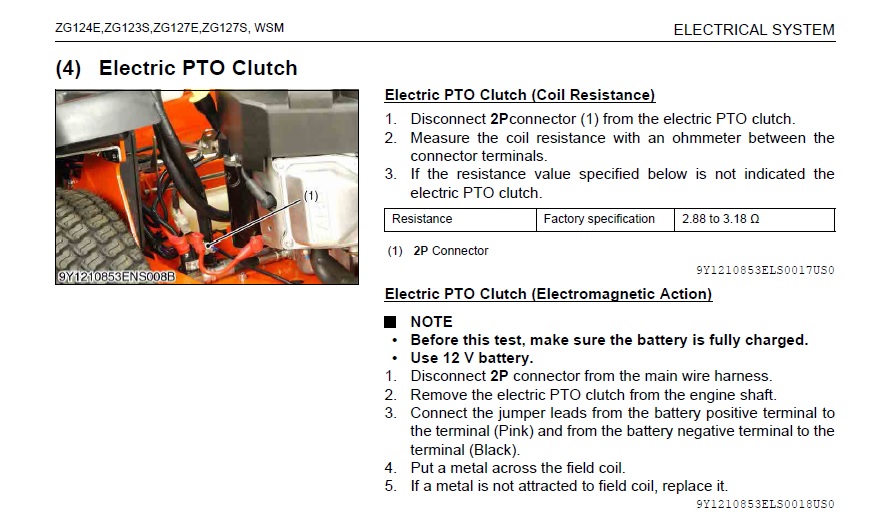

I have pulled some pages from the WSM.
The first test is to measure the electrical resistance of the clutch coil. If it does not meet spec then do not use and and decide how you are going to repair it.
Between the two leads of the coil you should read 2.88 to 3.13 ohms.
A lower reading would indicate an internal short generating lots of heat
A belt with a flat spot burned in it will cause lots of vibration.

Yes you measured the ohms correctly and the reading is far too low meaning the coil is shorting internally and producing the heat and smoke

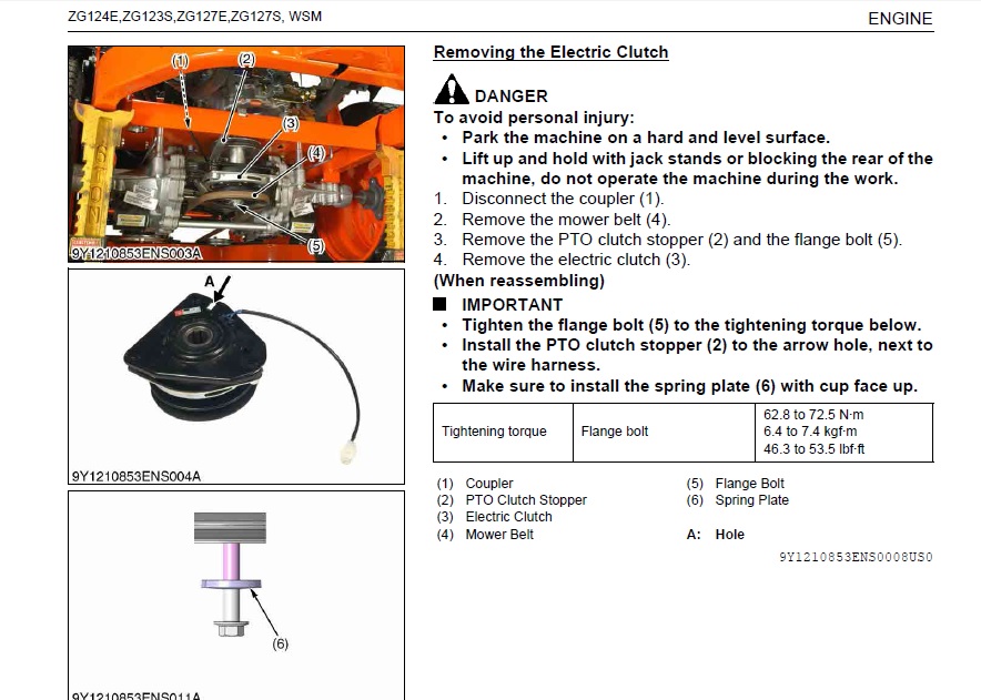

How does one hold the crank from spinning when torquing the clutch bolt.
Last time I took off I had no problem wedging a 32mm wrench against the roll cage. Not so much this time. Any other tips?
I have a 32mm socket but it is not deep enough.
I have the torque ext kit from harbor freight add that to the earthquake air wrench with 2” head plus the 9/16 socket. I cannot slip the gun under the clutch to tighten. So I have to use regular torque wrench set at 110 lbs. This scares me because last time I broke the bolt from over tightening. Does it take a lot of muscle to torque at that? I am just wondering if my wrench is working.
I am also scared in just using the air wrench because I don’t know how much torque is being applied.
