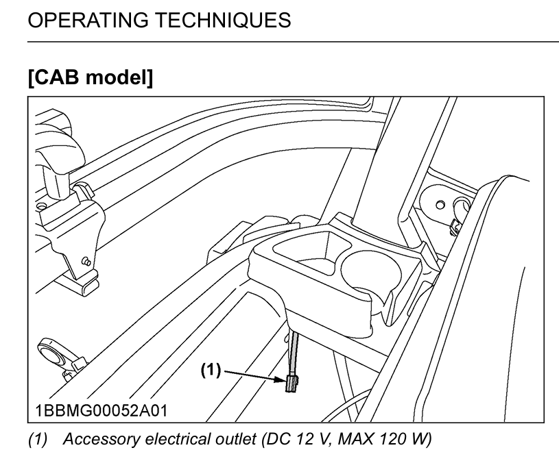

Greetings!
There is a power tap in my LX2620HSDC in the rear left corner of the cab. A wire with a "T" connector.
Pg 63 of my owners manual states "Accessory electrical outlet (DC 12 V, MAX 120 W)"
Thats it. No clue as to what would be able to plug into the "T" shaped connector hanging by a wire.
Does anybody have any idea?
Thanks
Todd

Whatever you'd like as long as it draws less than 10 amps.
Lights, fan, backup monitor, etc...

Nothing stopping you from cutting it off and putting your own connector on.
It's just standard 1/4" QD crimp terminals on the inside if you wanted to de-pin the connector and use QD terminals.

I have the same connector on my lx2610. I just used a single insulated spade connector and plugged it into the hot side of the tractor connector. Then feeds a 3-way ctr off switch that feeds a rear camera system or the added hydraulic oil cooler of my BH77. Mine has a 15-amp fuse as original.

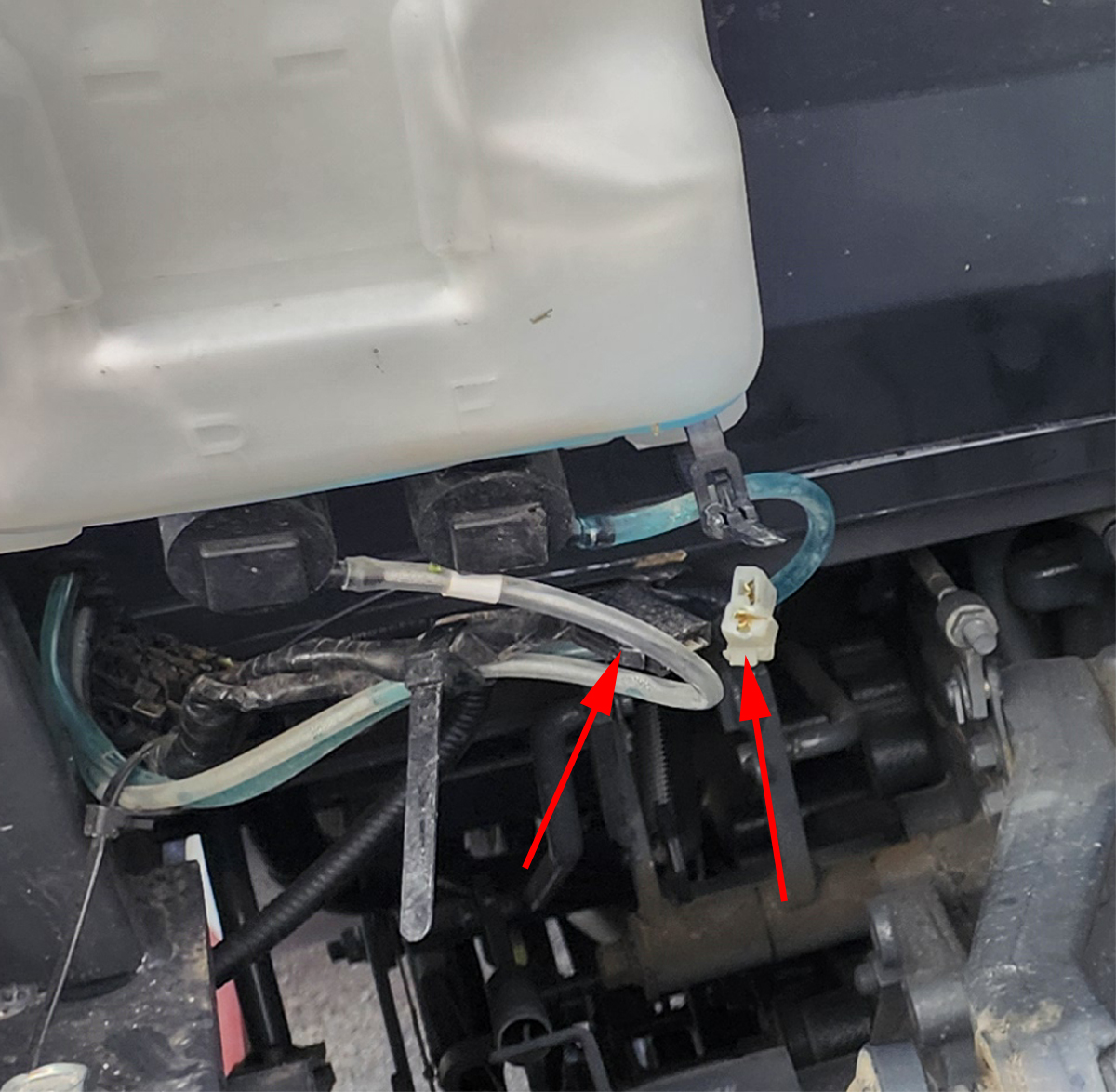

Could be for the windshield washer pump or pumps, but I would expect it to be external rather than internal. I have two of those connectors on both tractors that supply power to the pumps that are "housed" in the washer fluid reservoir.
You can see a white and black "T" connector in the photo below and I haven't traced back into the cab to see how they connect to the main wiring harness. I had to replace the windshield washer reservoir on the MX recently due to my stupidity, and had the connectors unplugged while waiting for the new reservoir to show up. The reservoir comes with new pumps which is a good thing since one of the pumps was damaged. I was able to fix the white connector which also sustained a little damage.
