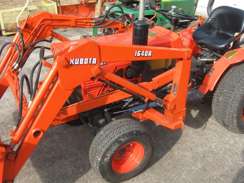

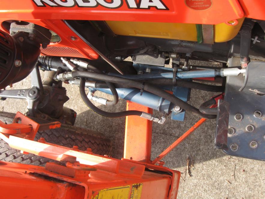

I added power steering to my 1995 b7100hst using a control valve from a john deere 400 lawn tractor and a hydraulic cylinder, I was going to use a car pump to power it but could not bring myself to cut the side panel and hood to run the belt out to the pump. Ended up running it off the tractor hydraulic. I am very happy with it. At the time I did mine the guy who offered a kit was out of business ( he was not happy with the clyinder he was using from over seas and he was trying to make his own cylinder/control valve) I got tired of waiting and just made up my own.

I am not clear who you are asking, but if it is me , yes you can do the same as I did, and either run it off the tractor hydraulics or add a power steering pump from a car and run it off that. I will see if I can include a close up picture of my set up.

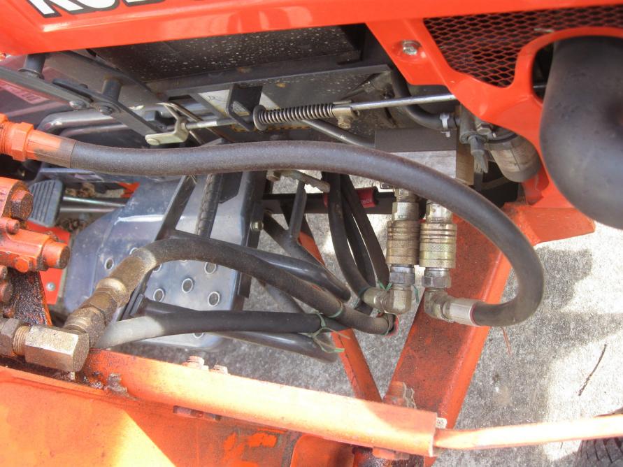

I have a front end loader on my tractor, so I am taking pressure from the power beyond port to the power steering valve , and returning it to the right side of the tractor to the rear port on the block you get from your kubota dealer. the rear port feeds the three point hitch.
I don't know if that makes sense to you or not , feel free to ask more questions. I will see if I have any pictures of hydraulic tap block that you get from the dealer.
The first picture is the hydraulic block, the line towards the front of the tractor ( right side of picture) is the pressure going to the fel , and the line towards the rear is the return from the power steering valve, and it feeds the three point hitch.

The system I installed, I put together myself, control valve came from ebay, it's off an old john deere garden tractor, hydraulic cylinder from surplus center, hoses and fitting I bought local. Total cost $250.00.
One of the nice things about my system , and the one that James is using, is that you don't cut the pitman arm and both systems can be removed and manual steering can be restored in about 10 mins.
