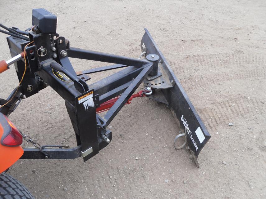

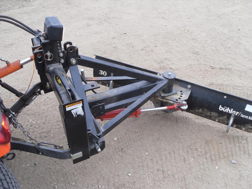

I have built one, However Not a professional fabricator... It has gone throught a couple of versions, here is the latest.
There is deffinatly better rear blades to chose from than the one I have for such a project. This blade has the pins below the pivot assembly making it difficult to put the cylinder at the top. I tried that last winter, and it bent very easily (1/2"x3" bar). This year I put it at the bottom, hopefully less stress.
It is a 60" Blade, the fixed side of the 8" cylinder is centered. The moving part, is adjustable (part of a top-link). I Chose the 8" because it had pleanty of stoke, and an adjustment thread at one end.
Im sure somone could do better, and if so I would be interested in the design.
I am still looking for a way to put the assembly at the top, but do not want to remove the ability to replace the blade. This would allow me to use it as a powered blade both forward and backwards.
It looks like you have a cylinder on the top link, so I assume that give you the ability to apply some down pressure? Looks handy
