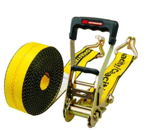

I used some really big straps I bought on sale at Costco that were rated at some enormous amount, like 5tons or some such. I bet they are 3" wide or wider.📏
Similar to these straps.
