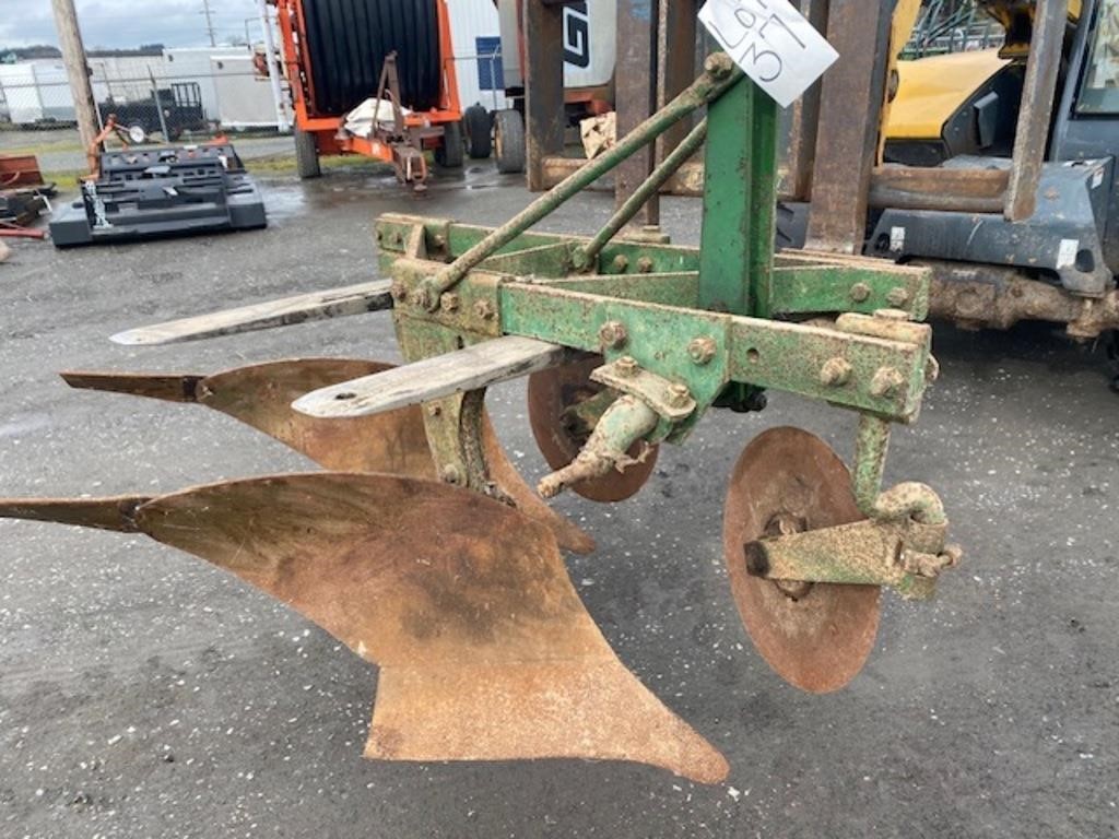

I have the opportunity to buy a plow and the choose is between a single or a 2 bottom plow and I was wanting to know what is a better choice from my 50 hp mx5000. Both plows are 3 point hookups if that makes a difference. Also I'm plowing though sandy clay soil. The 2 pictures are of the plows I want to buy

Your MX should pull a two bottom well. What tires and transmission do you have?

Your MX will play play with that two bottom plow. You have your FWA if the going gets tough. I wouldn't even consider the one bottom.

I have a 2 blade bottom plow and my mx5000dt pulls with no problem
