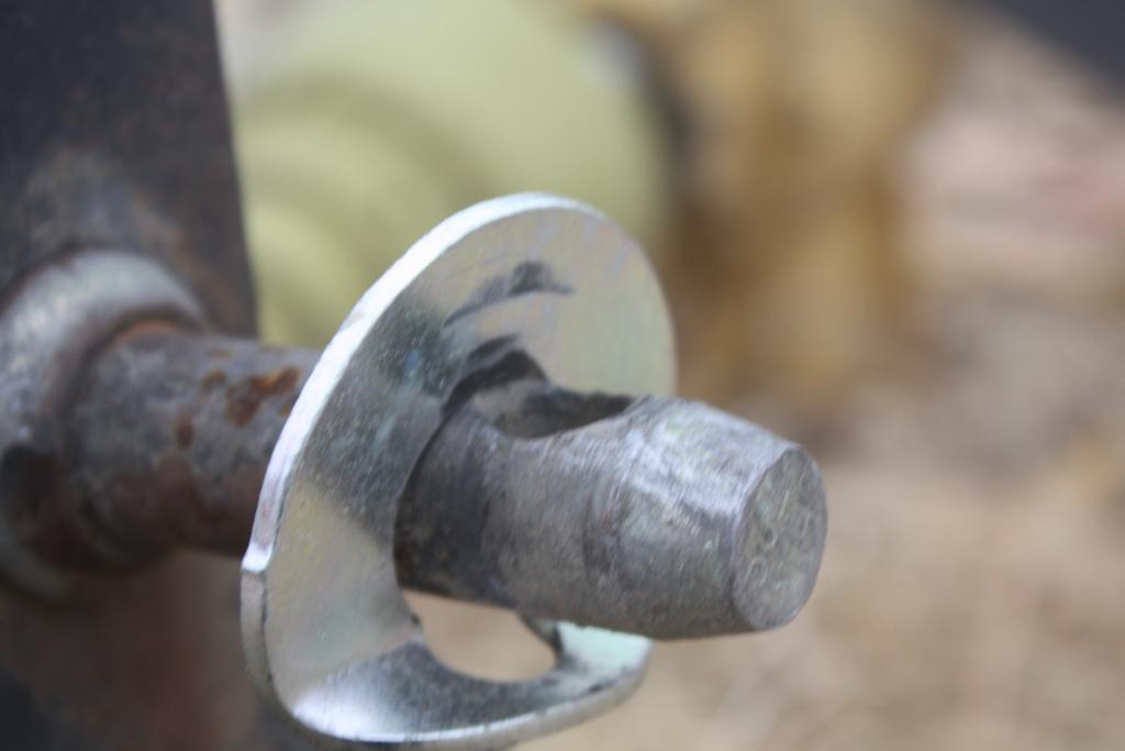

I'm not sure I understand the entire problem. The pins on my mower have Pat's washers on them and they're held in place by lynch pins or whatever you call them. Pat's hitch goes between the washer and the frame of the mower. Properly installed I don't see how it could come off the pin even if it wanted to. I took pictures and hope they attached properly. As far as the hold down tabs I think their primary purpose is to ensure the hitch is held open while connect the tractor to the implement. Once connected they are rotated out of the way and the hitch closed. I don't know that they actually hold the hitch closed, the latch must be lifted against a spring to release the pins. The pins pushing up against the latch would not release it as it takes more of a sliding motion to the rear to release. I bought my Pat's Hitch last July and it is of the newer cast variety.

I have the washers installed on mine as well, but 180 out from what you have. I'll change that up and see if it makes a difference. Won't be until this weekend since it is dark now by the time I get home

The swinging bracket on mine is slightly bent forward and has a slight drag. At worst use one of those tiny bungees.
I needed a couple washers and didn’t want to wait for them to be shipped. I went to tsc and picked up two washers ID 1” x OD 2 1/4”. I drilled them then bent them over. They are bigger than the washers that came with the hitch and work better. I won’t ever buy pats washers again.
