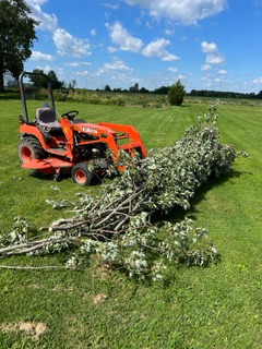

I think a set of pallet forks are in my future. While I could do everything I needed with bucket hooks chains, forks would have made it even easier.
Moving brush from some downed limbs.

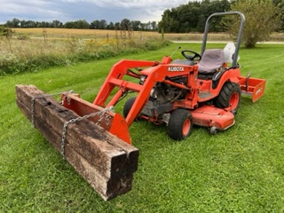

It may have been hard to see in my pic. I was lifting 2 RR ties at a time, not 4.
Not sure exactly what they weigh, but Google said the used ones are 100-200lbs each. My BX showed no signs of having an issue lifting the 2, although the way I did it I didn’t lift them back up high after getting them off the trailer. Even if I could have lifted 3 at a time I would worry my ballast wasn’t enough. I usually remove the MMM when doing any loader work and just use my BB as the ballast. It usually work fine, but since I was having to raise the bucket fairly high to unload the RR ties on the top of the stack I left the MMM on for some added weight.
Process I used was to have the bucket slightly angled down. Wrap the chain so it looped the RR tie evenly at each hook. Then I would curl the bucket to lift the RR tie off the stack. Ease back slowly and lower it as smoothly/slowly as possible prior to transporting them to their final location.

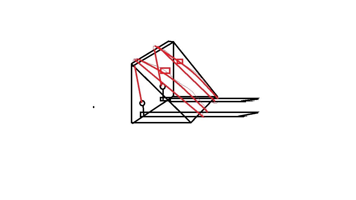

I couldn't find a photo, so whipped up a really cr@ppy picture in Windows-Paint(tm) just now for you or anyone else who wants "$20 pallet forks".
I am no artist.
One end of the (red) strap is "hooked" to the TOP lip of my bucket (not really shown)and other end goes through the aforementioned big eyebolt. Big red squares are the ratchet handles. I might have even gone all the way around the bucket one time. (Can't recall - been 6 months since I've used this method) as I recall I went to remove my SSQA bucket and couldn't as the straps prevented it.
As long as you are not doing any side-to-side motion, I find the forks stay in place and are very strong.
I used some really big straps I bought on sale at Costco that were rated at some enormous amount, like 5tons or some such. I bet they are 3" wide or wider.📏
Only 1 thing I would do differently if I built again would be to use longer pipes. The one I had was maybe 9' long, and you lose some length due to the fact part of it is under the bucket. I used pretty big pipe. I think it was 1-3/4 or maybe 2" galvanized fencing pipe that I cut in half, at a very sharp angle. You can see the sharp end prevents digging into the ground. (or bottom wood on pallets). If it's not obvious from my horrid sketch up, the forks go UNDER the bucket. o_O
I didn't have extra (eyebolt) nuts, but if I had, I would've adjusted them so there was almost no bolt threads sticking out the bottom of the pipes as anything that hangs down catches on the ground and it doesn't take long to rip up your lawn. It was a minor annoyance. This would be a real driveway killer if you were on asphalt or concrete (compared to real forks). The other thing you might try is only bolting through 1/2 the pipe (nut on inside of pipe) or maybe adapt a U-bolt instead of a through bolt.
I wanted max strength so I didn't try either method, just in case.
Overall I was very impressed with myself ;) on just how well it all worked (except for not much in the way of being able to "see" out front like real forks. For $20 it was awesome to use, until my real forks arrived from my dealer. I didn't lift anything super heavy. I lifted my utility trailer, some light logs, some pallets with maybe 200lbs on them etc. and the "forks" never moved, nor bent. Worse thing that happened was I ripped up a little lawn and driveway until I figured out my u-bolt ends were dragging.
Like I said, not my idea. Got the idea from Bob Kelland youtube channel, but used all different parts, but the idea was his.
Link>> bob kellands forks
I know I am not the first to do this kinda thing. I am sure many others have made forks like this, probably for a long time.
I couldn't believe how easy it was to fab up.
Hope this helps. Someday I'll put it all back on and document it for those guys that want a $20 solution, but for now, the real forks do most of the work.

Did the strap go through the eyebolt or did one end of the strap hook to it?
From the pic I was thinking one end hooks to the eye bolt. Then the strap runs up and over the top of the bucket. Then it wraps under the front part of the pipe, back up to the bucket and hooked to the top of the bucket lip.

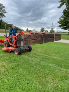

Unloading the trailer. Lifting stuff with the bucket that high always takes a little extra caution.
The guy I bought the RR ties from had a fork truck and just set the whole stack on the trailer at once. Took me a little while longer to unload it, but happy I didn't have to do it by hand
My straps have big "hooks" on them. Not traditional hooks, but kinda doubled up. (someday I'll post pics) but here's a picture that similar to my straps.
I hook them on the top lip of my bucket, go down and around the pipe 1 revolution, come back over the top of the bucket, then behind the bucket and hook into the eye of the eyebolt with the other hook.
That's the best of my recollection.
The reason I used eye-bolts on the back-end of the pipe was I didn't want to leave anything to chance. I could've just tried wrapping the strap around the back of the pipe, same as the front of the pipe, but seemed risky, like it could slip off.
When I <ahem> made (made! ha ha) my bale spear, I used no eye-bolts. The wood seemed rough enough (friction-wise) and my strap never slipped when I wrapped it around. I wouldn't trust that method on a slippery metal pipe. I only had 1 small job for my "spear" and took it very easy. All went well.
HTH
