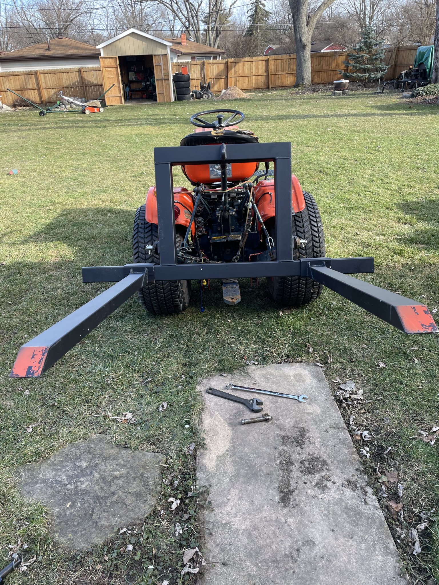

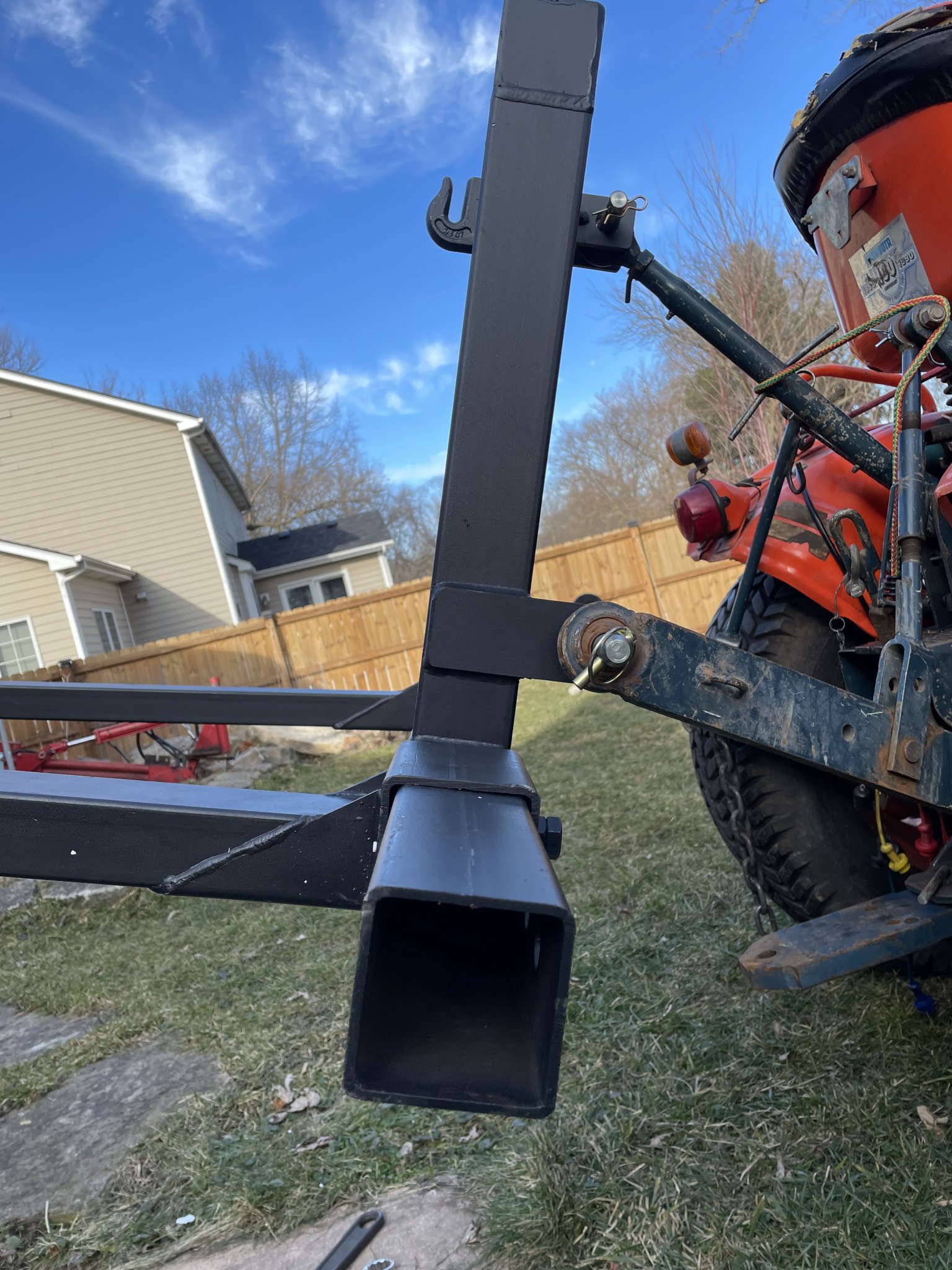

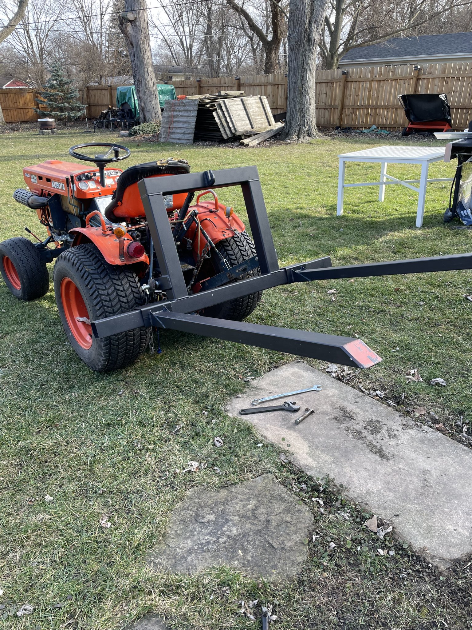

I purchased the Amazon forks. They arrived yesterday via UPS. Driver was not thrilled they went UPS. Too heavy and in a cardboard box that was failing.
No visible damage to the equipment. Connected up to my B7100 and loaded up some large pieces of limestone.
Forks are definitely oversized for my little tractor. Need weights on front end. Standing on the unloaded forks I can get the front end bouncing but not off the ground.
Bottom bar already splitting along the seam. Will work for my simple purposes but would not recommend unless you planning on fixing with some welding up of any failures. Fortunately I have a brother with a welder.
I also purchased the 3 PT hitch forks from Amazon but ended up building my carryall on it, it was cheaper then the carry all frames at the time.
I also have 36" forks for the front and your right after forklift frame and forks it limits loader power for us, me more then you. Carry_All_5.jpg CarryAll_4.jpg Ended up shortening deck because of overhang weight. Still able to lift.

I have a similiar set of 3 point forks. I modified the frame with a couple of 3/8" holes on the horizontal bar so I could bolt my chain harrow frame to them along with the chain hook on top. Works well.
