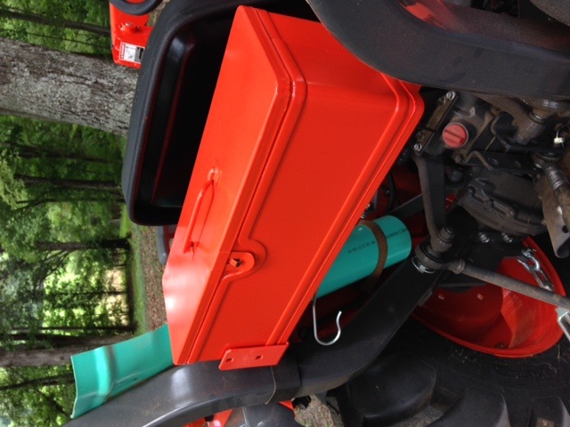

I just used the Kubota "touch up" spray paint the local dealer had on a tool box. Beautiful enamel finish, very high quality and the best spray paint I've ever used. Very hard and sturdy once good and dry it seems. RWR
