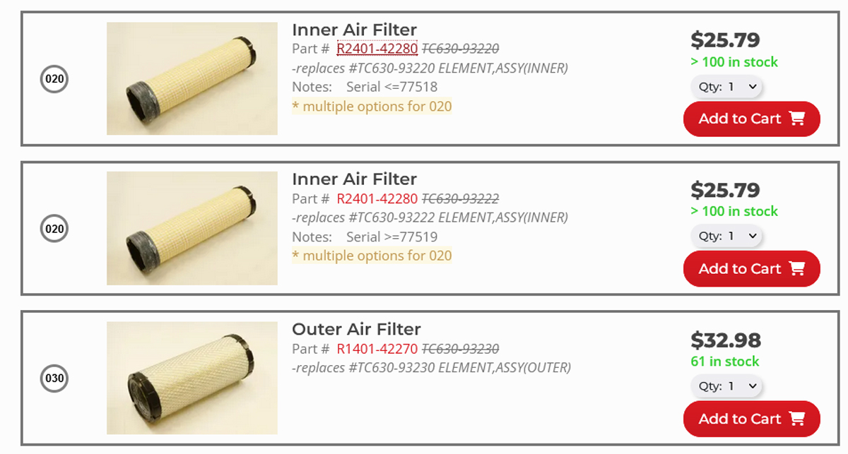

Those two air filters (inner and outer) are used on a lot of Kubota models including some excavators. My MX6000 uses the same filters. I would switch the old filters and new filters in and out a few times and see if the error code tracks 100% of the time. If it does, it would imply an issue with the new filters. Stranger things have occurred in this world.
If you look at the Messick's website you can see that many parts replace earlier parts and the filters are no exception. Who knows what the differences are but could be dimensional changes, different vendor, different materials etc. If nothing else, the OP should verify that the part numbers match the latest versions as listed by Messick's.

Unfortunately, I don't have the old filters anymore. The new ones match the correct part numbers.
