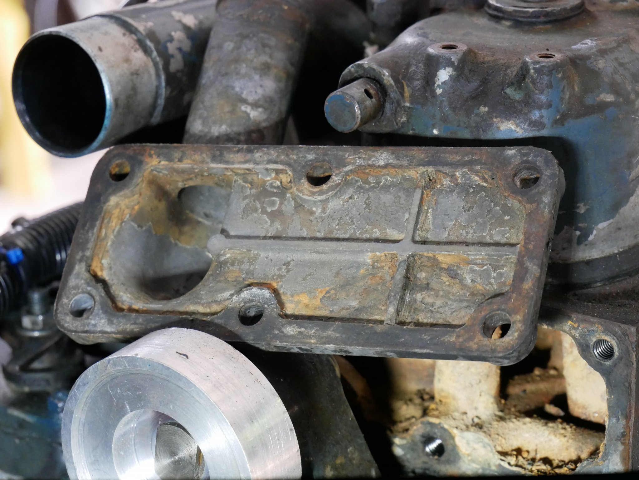

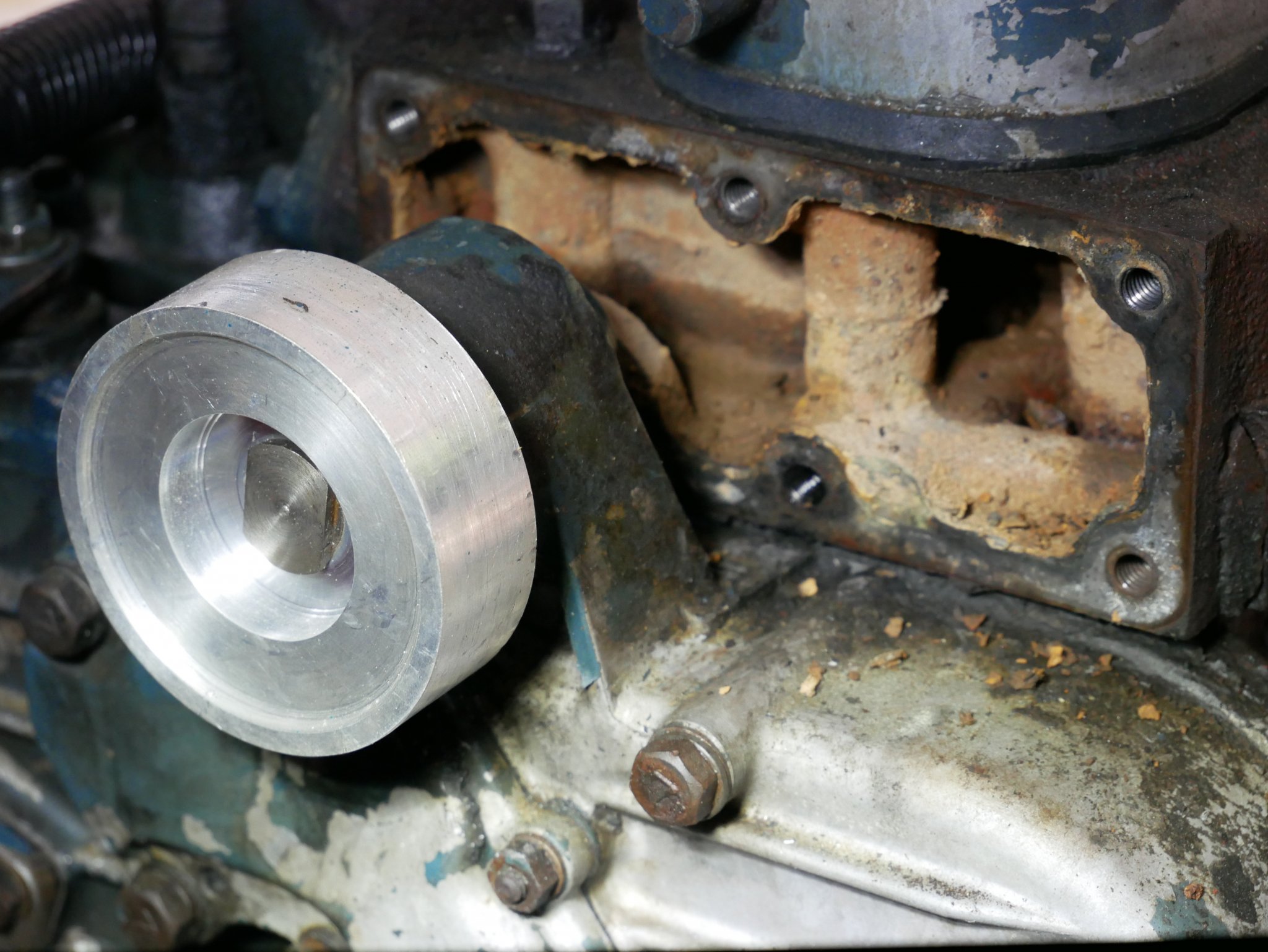

These engines are also bad about scale buildup inside the water jackets, I just took the top plate off mine and got some pics of the buildup, I will post them tomorrow after I bring my camera home.

Here are a couple of pics showing the scale buildup inside my engine, they only show a small spot but you can get the idea.
