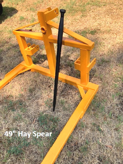

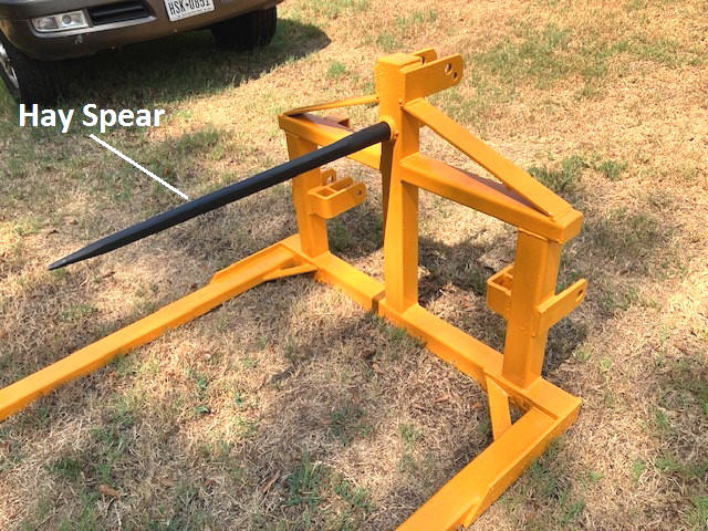

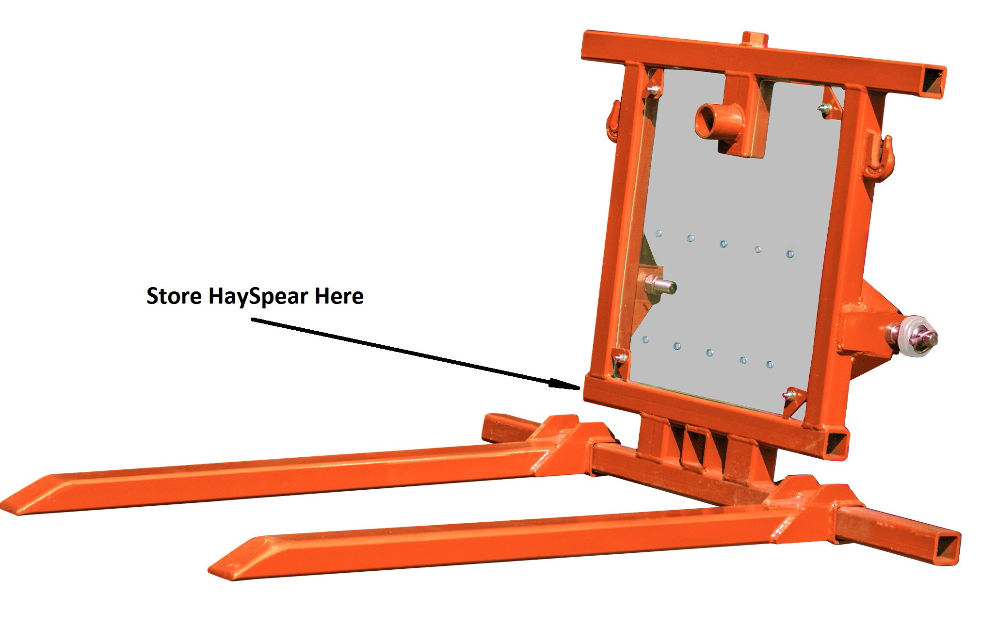

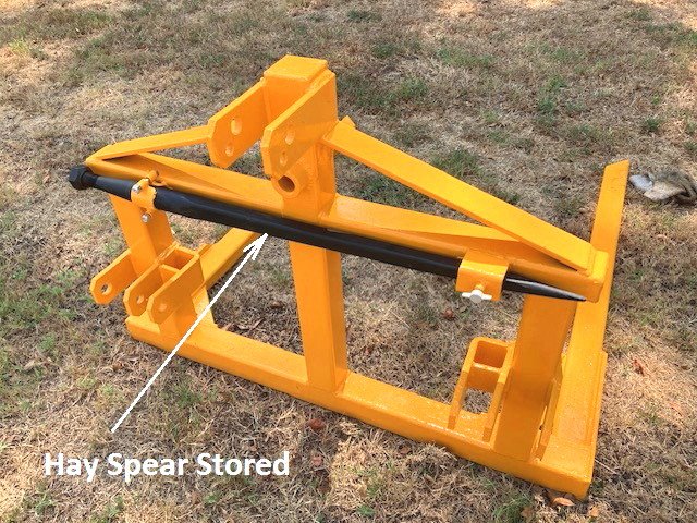

Not too shabby.
Might add a way to store a HaySpear as well. It might fit inside the square tubing and only require a way to 'capture' it.
I added a HaySpear to my Haybale forks using a 'sleeve' (same as your product) but wanted the option of easily removing it.
Installing it and taking it off is easy enough (if you can remember where you put it).
To remedy that issue....I made a way to keep the unit and HaySpear together.
IF the spear would store inside the square tubing it should be easy to come up with something to secure it.

Not too shabby.
Installing it and taking it off is easy enough (if you can remember you put it).
View attachment 150280 View attachment 150281 View attachment 150282
That's a great idea! You nailed it on that one for sure, looks super clean.
This is exactly the type of feedback I'm hoping to receive from this community. In fact, i'm going to speak with our engineering team now about this!

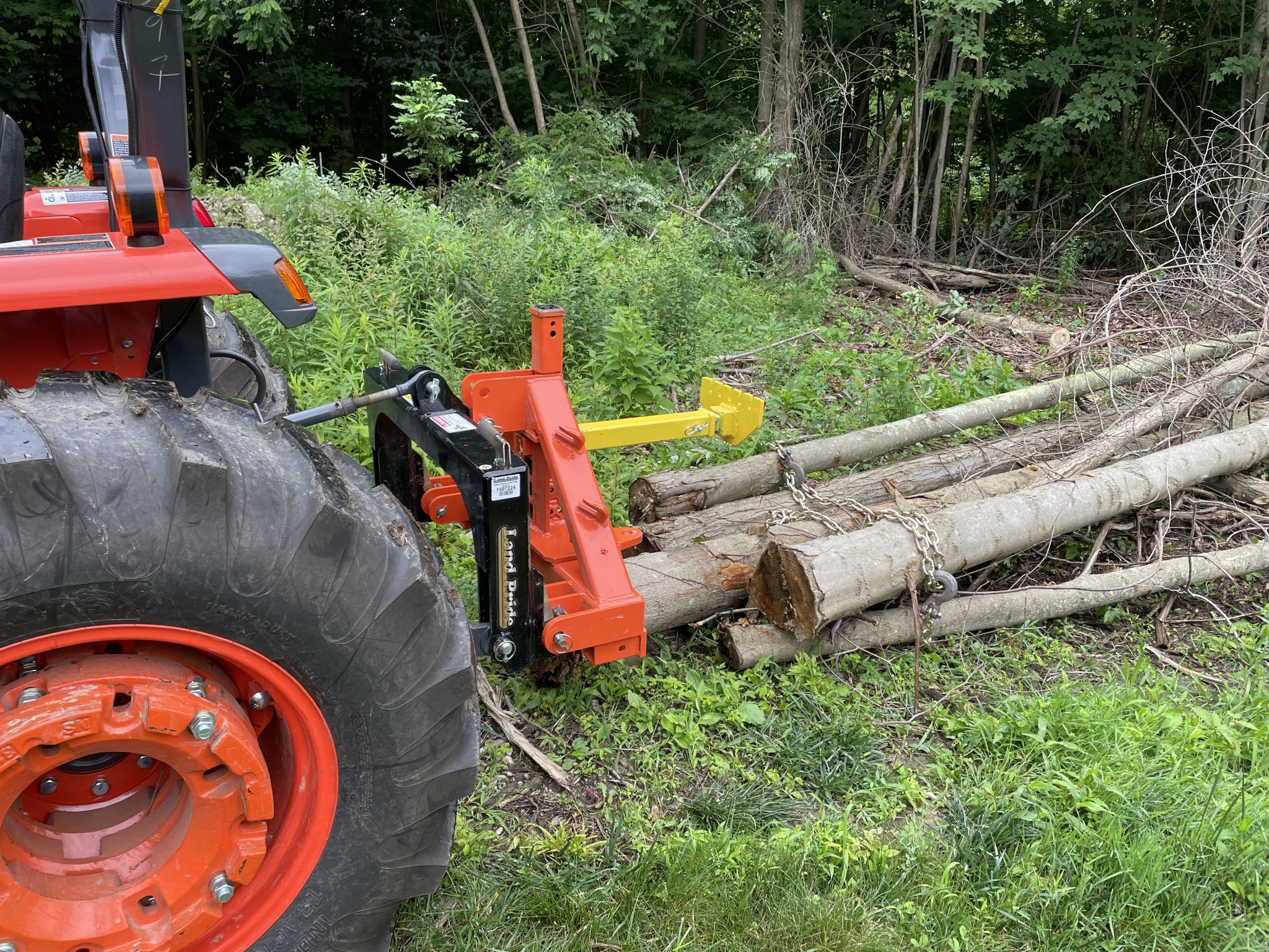

1. If we’re still in the market, I’d be interested for a simple way to hang weights for ballast. Or, maybe add some pins on tip of forks so a pallet with weight or a carry all box could be kept from sliding off.
2. What I made is primarily for pulling logs, but maybe another hitch or something to help in choking / lifting a log. (I understood that is not what your description of the implement is for…but maybe that’s some additional function/uses for folks?)
3. If it would readily go on the front (SSQA) loader as well as the 3pt that would offer some other uses as well IMO (ie. Carry stuff up front or a work platform, as well as pushing trailers/wagons and as fork applications.
I really like the concept you have. I think it has more uses than what I tried to make…Nice job.

Couple comments for my normal uses:
Thanks for the feedback!
I want to say when we were determining max weight capacity that there was mention of what adding weights would do to it. When you get into that legal territory you tend to be overly cautious of what you are willing to say limitations are. But it's certainly worth bringing up to my team and getting their thoughts on it.
As for the pins on the tip of the forks, that's actually something we've talked about recently. Some sort of locking mechanism on them would be great for hauling a load on there when you're going over bumpy terrain. I'll be following up on this one with engineering soon to see what we can come up with.
I'm actively taking notes on all feedback/suggestions and taking it to the folks it needs to go to and will absolutely report back with any potential outcomes we're able to identify and improve on.

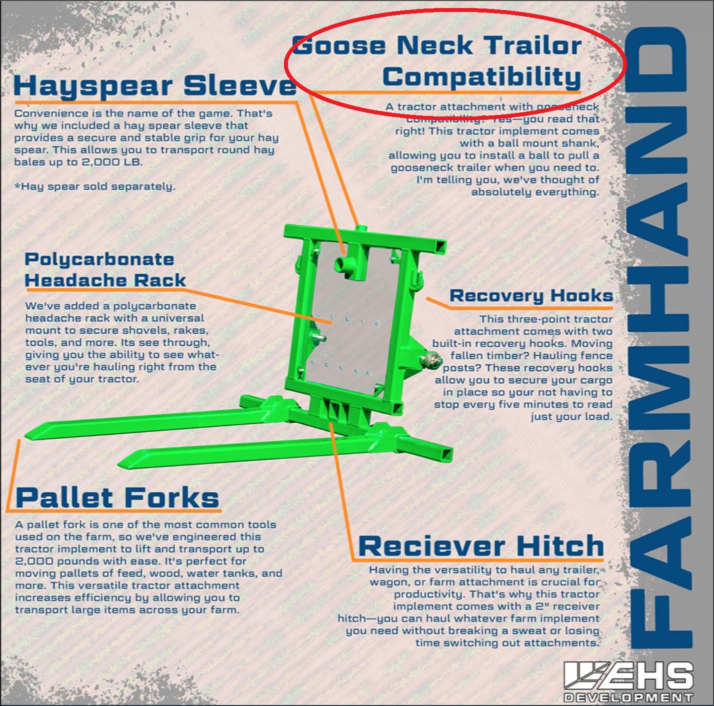

I like it. Looks very useful.
However...I hope that it's not too late for reprinting your marketing materials. I didn't read it all but would suggest that someone do so before you finalize it.
see below. I don't know what a "Trailor" is.
As much as I'd love to blame the marketing team on that one, I manage the marketing team lol.
Good catch on that, thank you for pointing it out. I'm getting that changed right now!

Proof read the rest of it....I didn't.
It looks like a great product. Best of luck to you.

Yeah, there's multiple other typos in the text.
I before E except after C! Receiver is spelled incorrectly in the heading but correctly in the main text. 😂
I often have to correct my use of it's vs. its. That error shows up in the text under the Polycarbonate heading, not to mention the missing hyphen for see-through. Good grief ... I need a nap!

Sorry about that guys. Our graphic designer was kind enough to revise the graphic for us.
If you do decide to forgive us, use the code "2MANYTYPOS" and you'll get a 10% discount on a farmhand from now until Sunday at midnight. :ROFLMAO:
