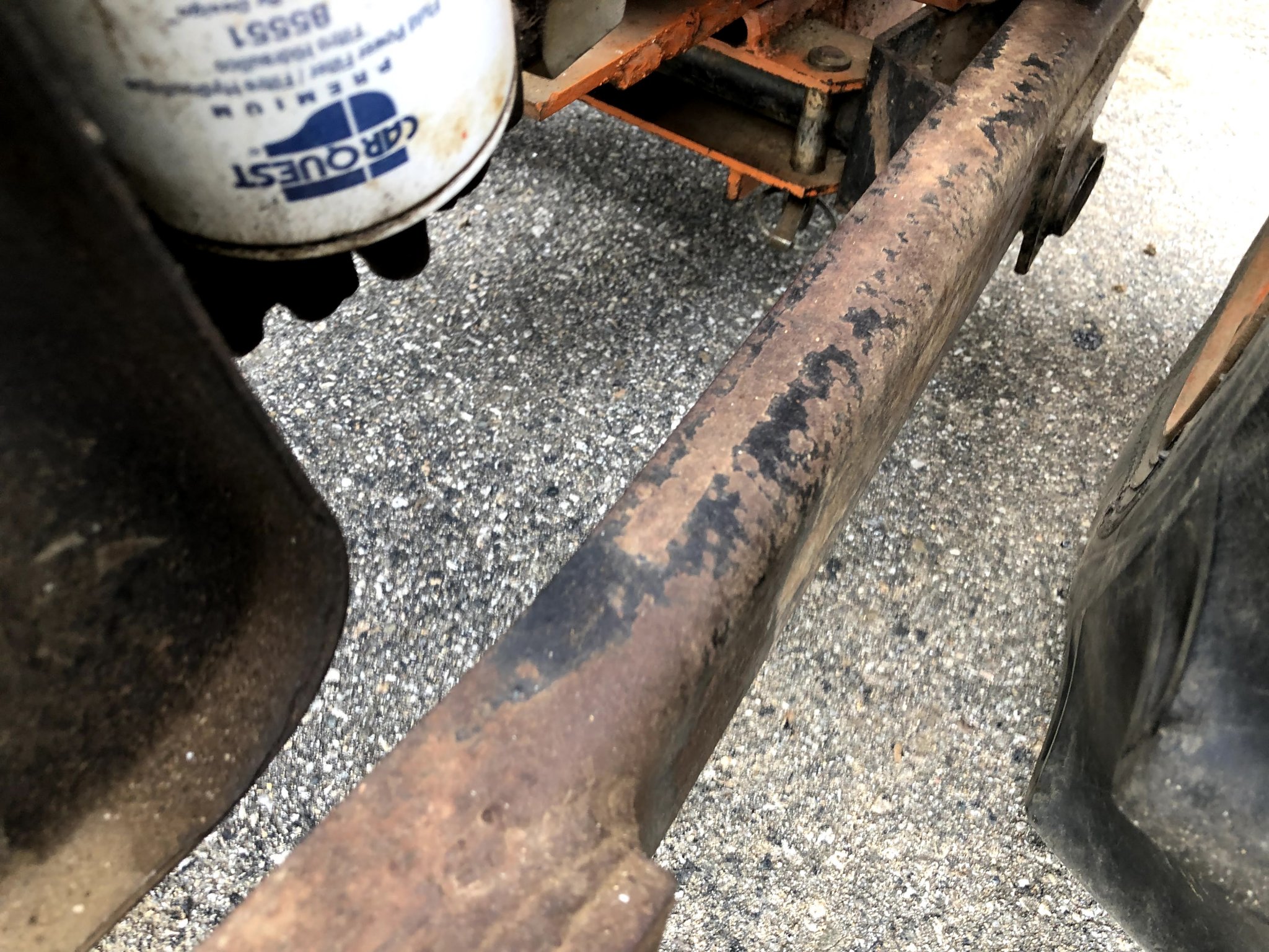

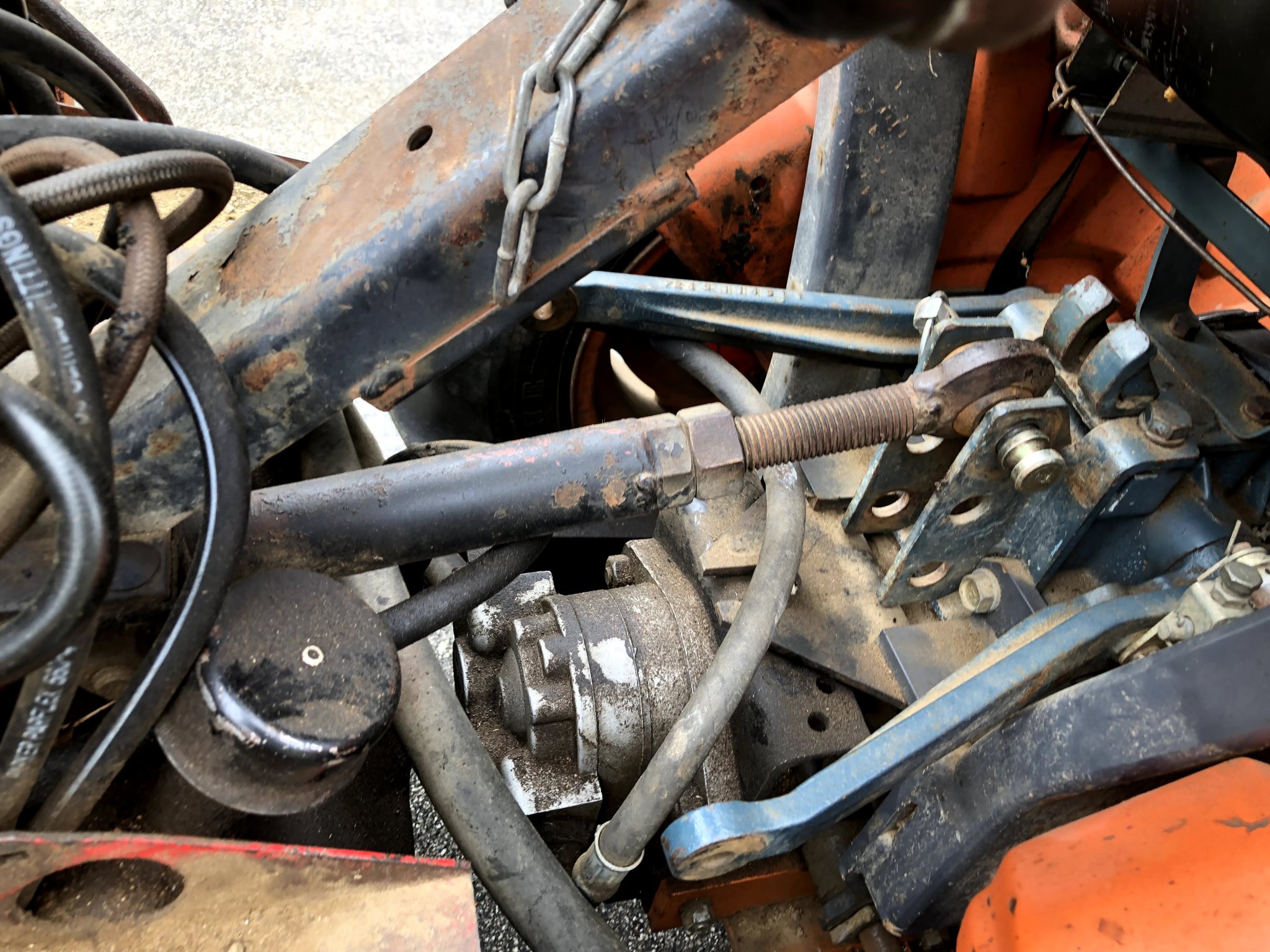

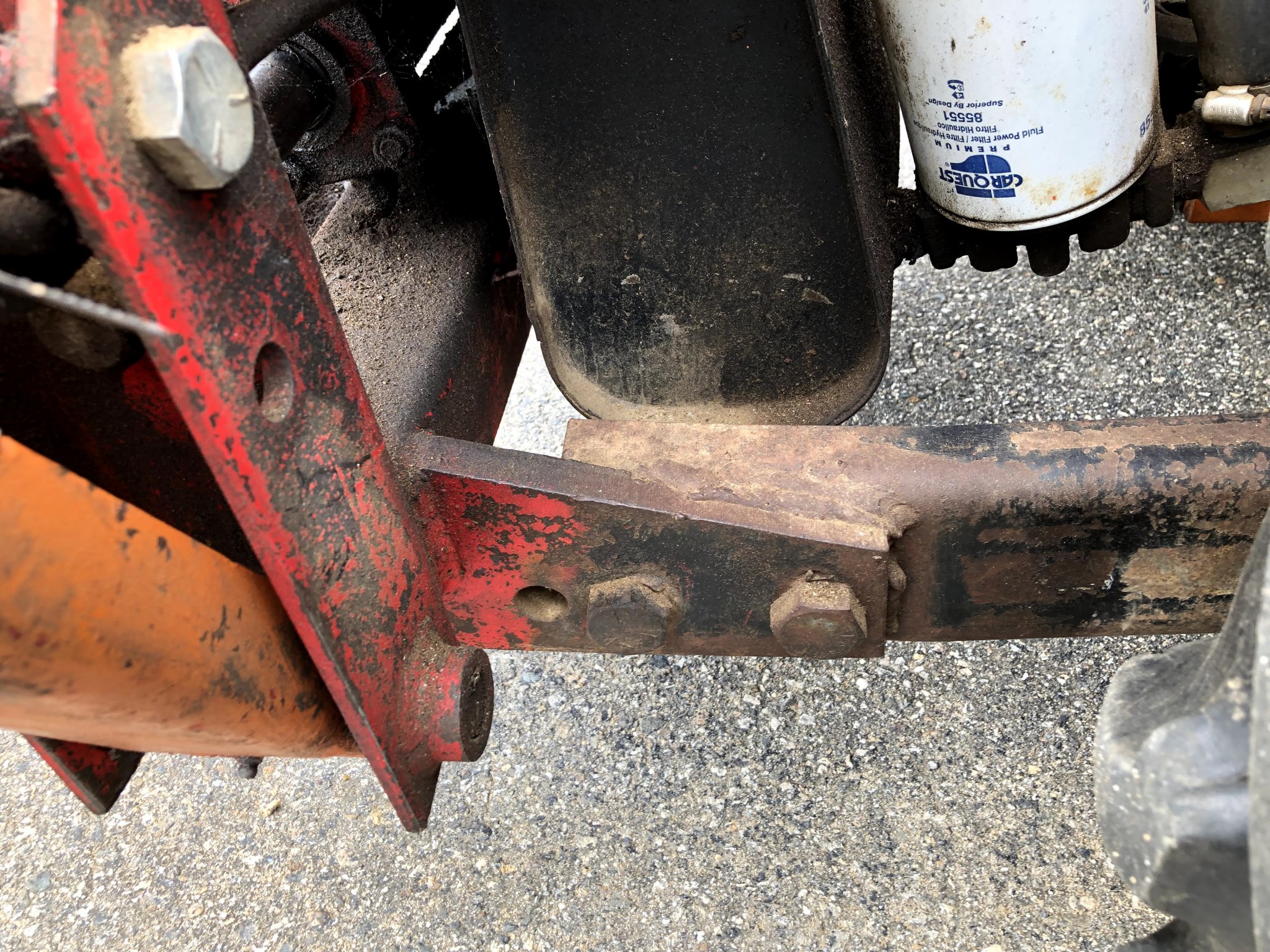

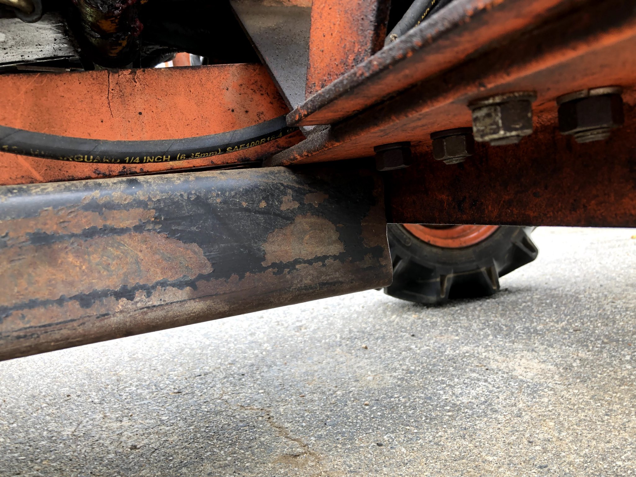

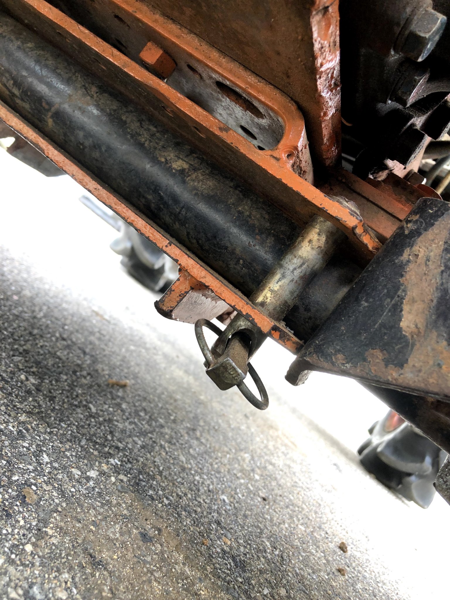

-----------describing the pictures in my above post----
1st picture shows subframe bolted (and welded) to backhoe where the lower pins would go on a 3 point hitch application.
2nd picture shows the subframe heading under back of tractor.
3rd picture shows the rear receiver on the tractor that the subframe slides into and gets pinned.
4th picture shows the front of the subframe under center of tractor. It is bolted to the crossmember of the front end loader subframe.
The picture below shows that this setup still uses a top link. I don't think there is ever any load on it. The subframe is very strong.
The pictures show the Woods BH750 mounted on my B7100
