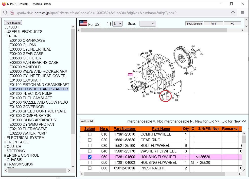

Looking at the Illustrated Parts Lists don't miss the two bolts into the oil pan at the bottom of the flywheel housing coming through from the back. By the time you get the axle and bracket off, you'll be good at navigating the parts drawings.
Best luck ! :cool:

I had located the two from flywheel housing. Also there are two bolts coming from front axle direction

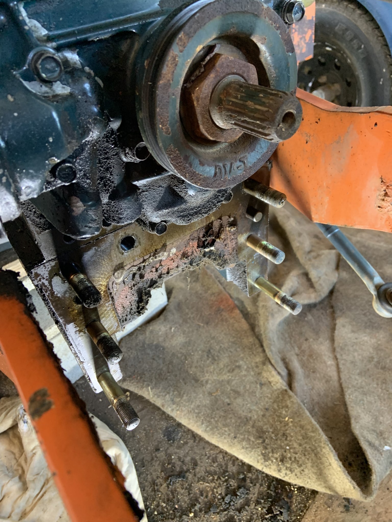

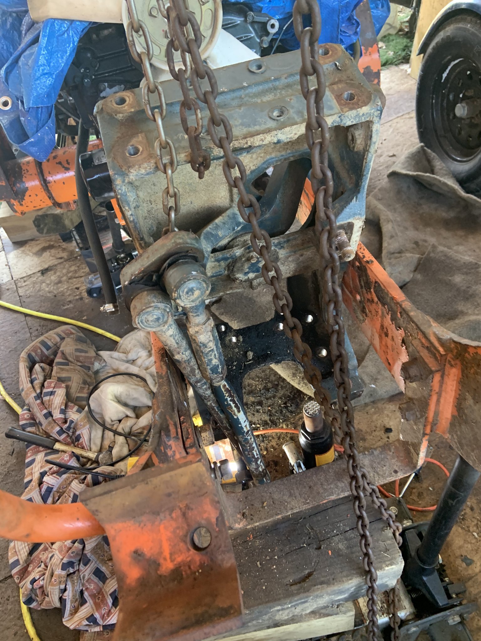

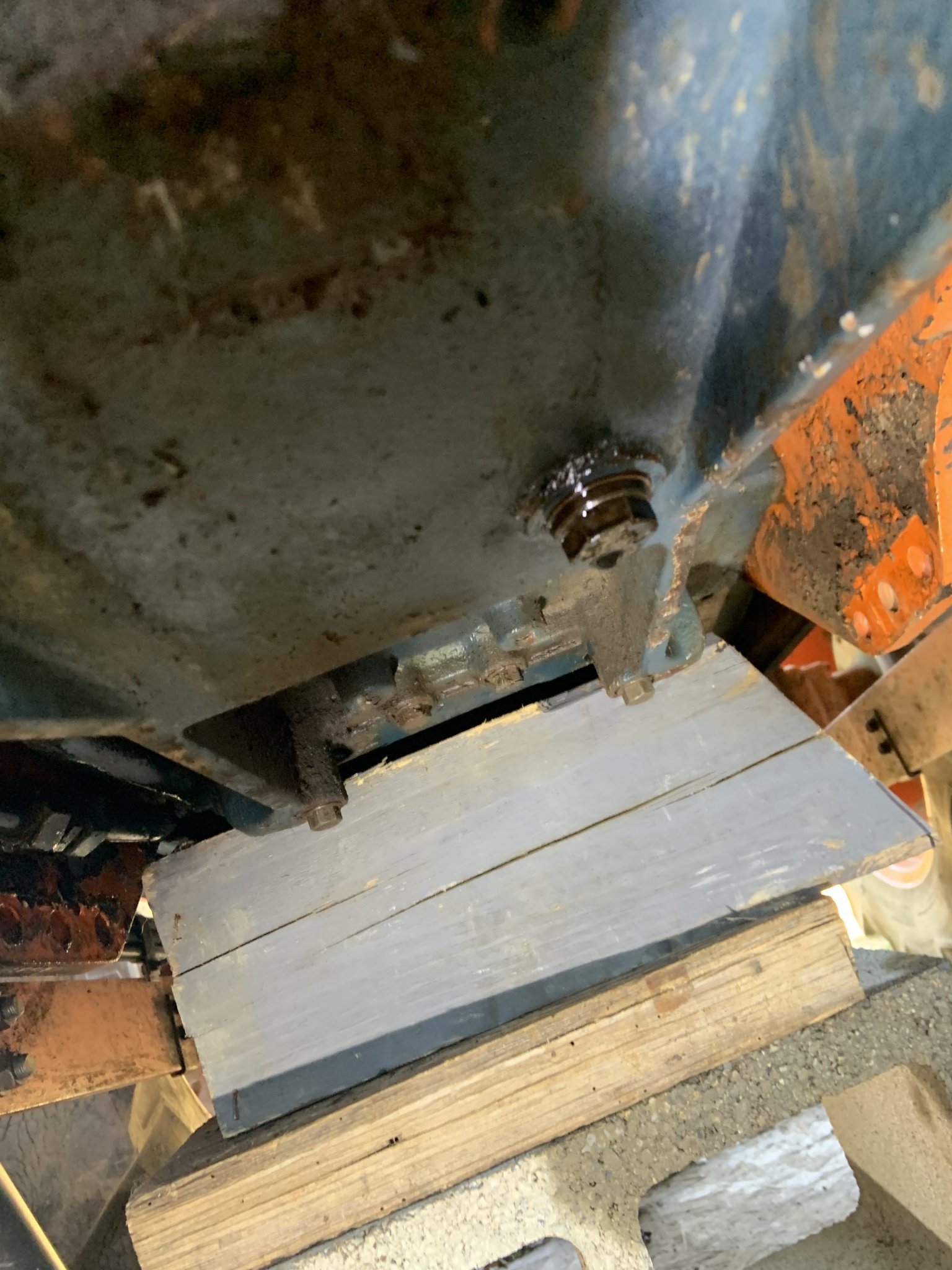

No one indicated that they had dropped the oil pan without separating the engine. I have almost accomplished it. The front axle and front axle bracket had to be removed. Now ready to unbolt the 60 lb oil pan. Lots of work. Pics attached

Great progress! Yes, lots of wrenching - looks like that steering bracket is a hefty chunk too!
Thanks for posting pics - looking forward to seeing more.

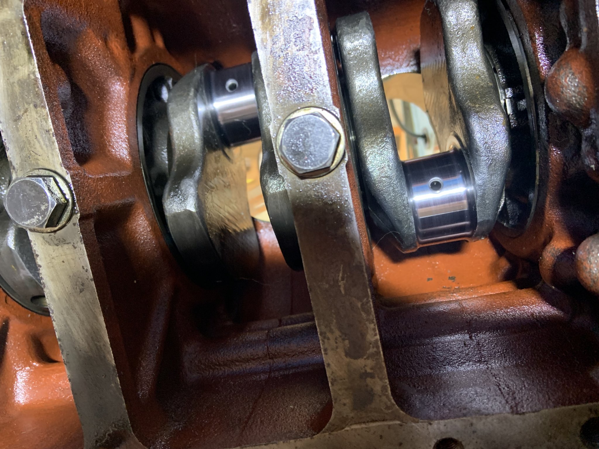

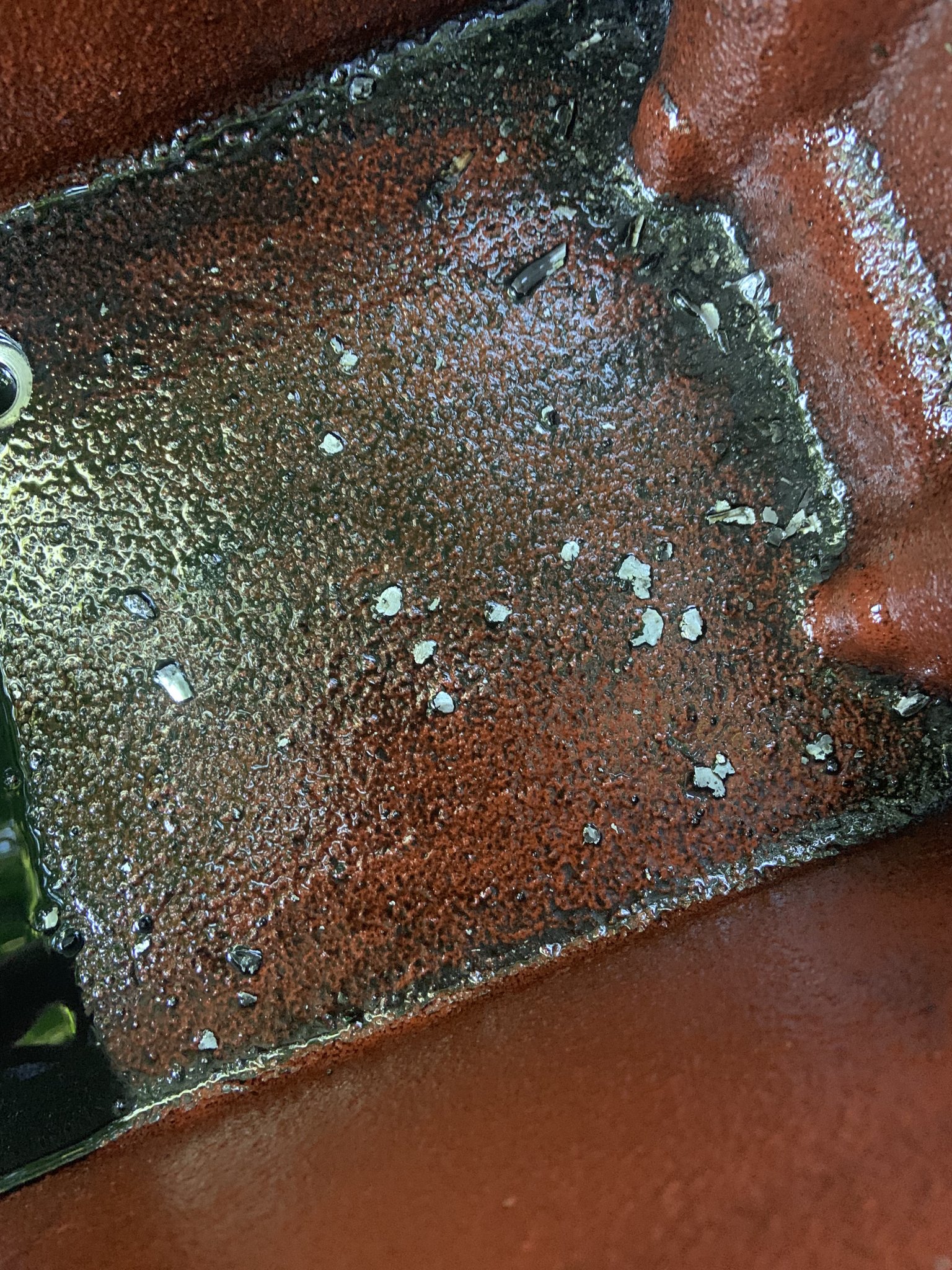

I removed the oil pan and only found aluminum flakes (pic). Proceeded to unbolt and remove pistons. The #4 piston was broken just below top ring. I would say that is the cause of the blowby. Now to confusing issue; all 4 rod bearings were scored and #1 was spun. The #1 connecting rod bolts/rod were bent. I have started to polish the rod journals. My dilemma is whether to inspect main bearings, which means I have to split the tractor This nullifies the objective of removing pistons insitu. Unless there was an oil problem, I don’t know why all rod bearings were damaged. Would like some opinions
