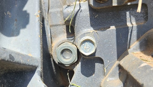

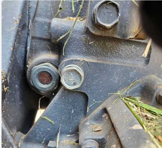

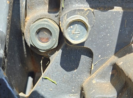

The hyd oil level on my MX 4800 never seems to stay the same, it shows nothing, quarter or half, and over full. Never consistent, and it does not matter if the loader is up, down, or half way.
I worry about it being over filled, but when it does not show on the sight glass for a few hours I worry about it being low… so I add a quart or half a gallon, pretty soon it is showing half or over.
Any ideas? Thoughts? Suggestions?

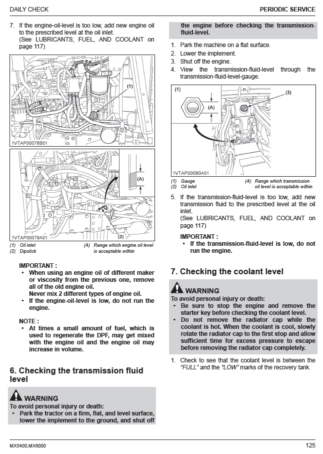

Kubota says nothing in the owner's manual about oil temperature when checking hydraulic oil, only to lower the implement to the ground (for safety I assume), to park the tractor on level ground, and to shut off the engine. So now I wonder if the difference for an MX as indicated by A below is around 3 Qts. That would make sense to me.
I think you are correct, around 3 qtss. Pretty much the same for the MX. It does state not to start the engine if the oil is below the indicator, but I have that happen often. System holds 11.6 US gal. so it is a LOT of hyd fluid.
