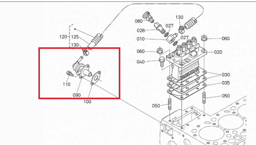

There are several variants of the L4600 so check carefully to see if I have the correct engine mounted fuel pump.
Check attached parts photo. It shows a fuel pump attached to the side of the injection pump.
This "lift pump," style of pump is known to have diaphragm failures which can lead to fuel entering the engine. It could also be failing to deliver fuel to the engine in adequate amounts to run properly.
Agree with advice not to run engine with diesel mixed with oil.
