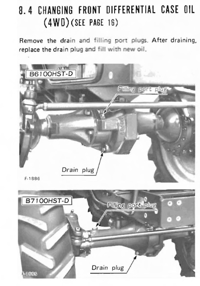

I am changing sealings in my front axle,
is the filling hole the same as right level
Does anybody know the right amount oil?

I have attached pages from the B7100 owners' manual showing how to fill the front end.
In short, each end of the axle and the center need to be filled until oil is starting to come out the fill port.
I have attached another page showing quantities but these are only a guide and filling should be as described above.
Dave
Dave
Thanks!
