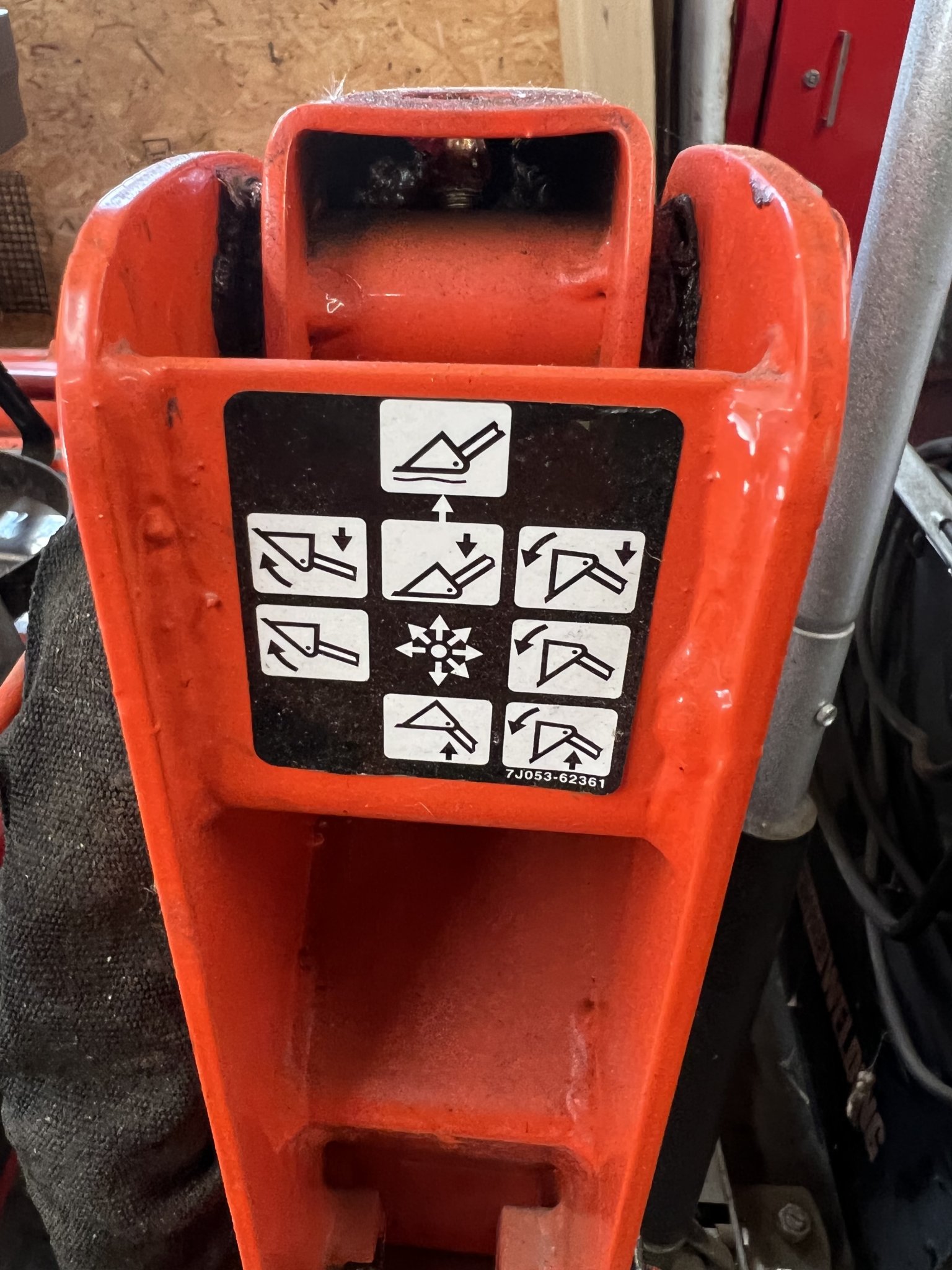

Many Kubota loaders don’t have a simultaneous lift/curl function. They really do, but it can cause some funky response if joystick isn’t feathered correctly.
Like Ed Ritchey said, a little practice can go a long way.
Note the 7 o’clock position on my loader. Lift/curl is black/not available. It will lift and curl. Just need to get it right.
Lift and raise works on an LA525 and frankly I was using it long before I realized it was missing from the label on the loader. According to my LA525 Owner's Manual the reason for that empty position in the label is:
Note:
The lower left position (Raise and Rollback) is not recommended because of insufficient lift force

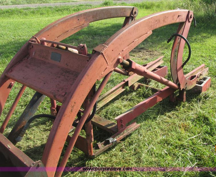

Skyline loader?

Skyline loader?
Dan - I honestly don’t know. My dad and grandfather bought it used at auction late-‘50’s. Except for hoses and cylinder repairs, haven’t dealt with manufacturer to my recollection. I’ll ask Dad if he remembers.
It does have a frame/rail mount issue at the rear axle. Would be good to know what original looked like. It’s solid, but was a farmer repair/improvisation from decades ago.
Sorry Bruce.
10,058
5,364
Sorry Bruce.
Just my first impression based on the curved lift arms - a distinctive feature of the Skyline (Davis) loaders of that vintage. Made for and retrofit to a lot of different old iron.
