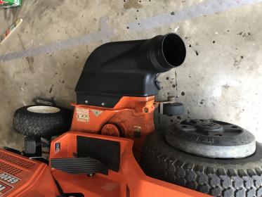

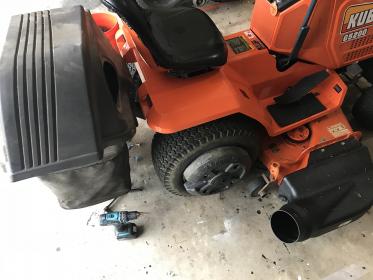

Looks like you went down the road I did when it comes to adapting a bagger to our older G series tractors. I ended up finding a newer RC48G-20S mower deck and a GC48G grass catcher locally at a great price. I got both in excellent condition for only $700. I attached a few pictures showing what I had to do to get it to work with mine and what it looks like now. I also had to trim a little bit of the right floorboard in order for the blower gearbox to clear with the deck at full height. I fabricated my own bracket that mounts to the rear end and in turn the bagger mount attaches to that.
I was so psyched to be able to get all this to work. I originally was going to try and adapt a craftsman bagger setup. Glad I didn't go down that road!
