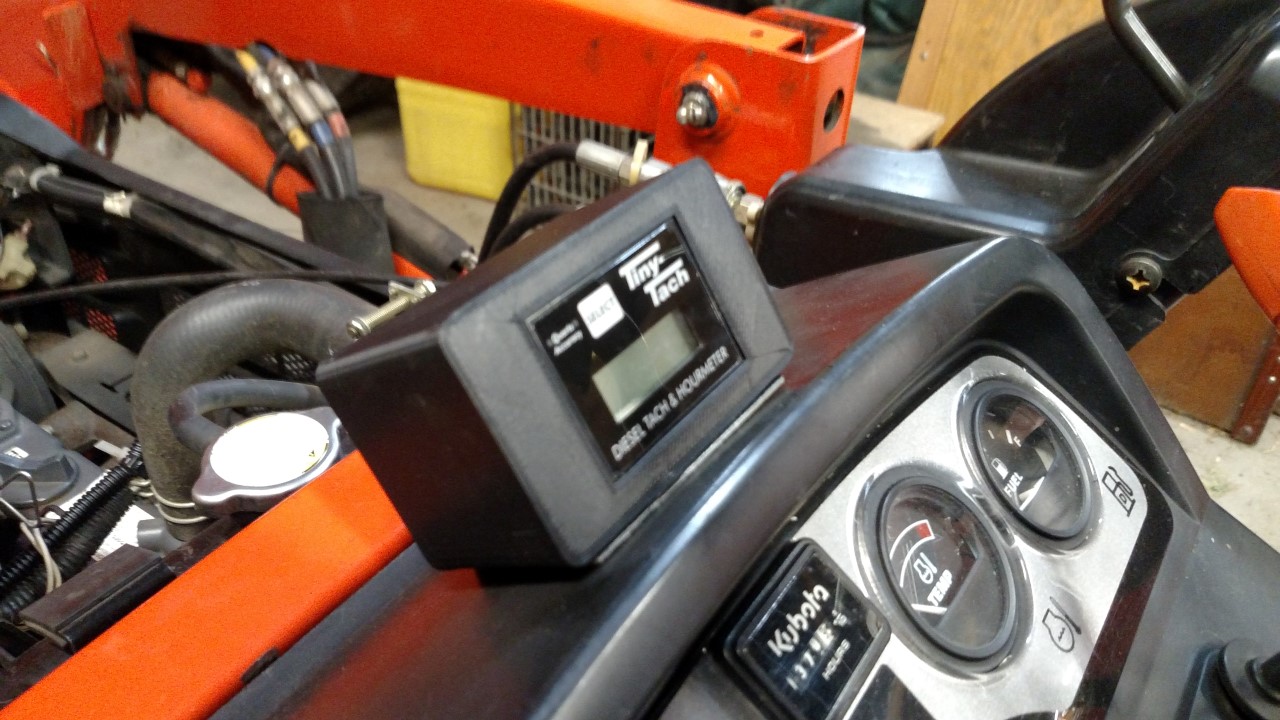

I put a Tiny Tach on my BX2230, and it works great. Like shelkol said, it just uses a clamp on pickup on a fuel injector line and a ground on the engine, plus 12 volts to power it. I 3D printed a box to mount it on the dash, rather than cut a hole in the dash.

That looks good on there. I just ordered my Tiny Tach, not sure how I'll be able to mount it though. The dash panel doesn't have a lot of room on it.

Don't do what I did. I wired it to 12 volts and found my battery dead the next time I went to use it, lol. wire the 12 volts to a circuit after the ignition switch :)

If you are one of us mere mortals who don't have a 3D printer, you can buy a project box and make a cut out for the meter.

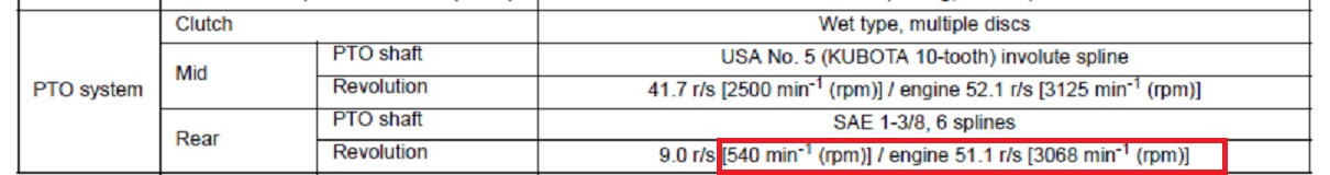

While I do not dispute the usefulness of a tach, looking at the BX1800 & 2200 spec's I see why Kubota did not feel the need to include one.
The engine is governed to 3,200 rpm.
The rear pto 540 rpm is obtained at an engine speed of 3,068.
In other words, run it at full throttle. That is what is is designed for. The same engine would be run at 3,600 rpm in generator operation so do not think you are stressing the engine.
