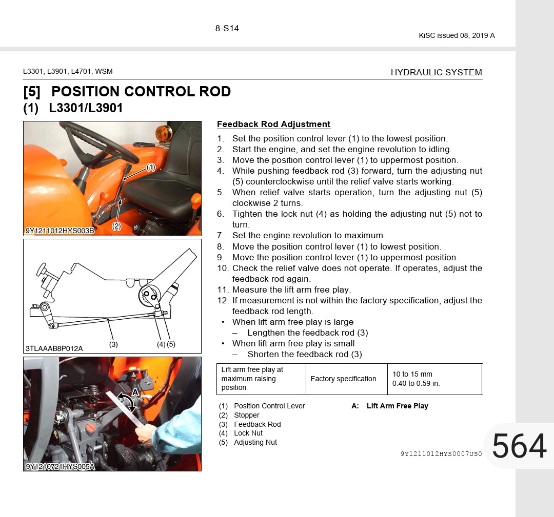

Here is what I think has been happening in your description of the past performance.
When the three point hitch is raised or lowered there is a feedback to the position valve that tells the tractor to maintain the position. If there is movement the tractor automatically adjusts to get back into the same position. Now if that feedback mechanism is improperly adjusted the small lift arms go so high the hit a mechanical stop and the relief valve in the three point hitch is activated (a squealing sound starts). The hydraulic flow is basically open to the transmission sump. If you then try to use the FEL valve it is unable to divert oil and pressure to the cylinder (easily) so it moves slower and can’t lift as much as normal.
There is also a relief valve in the FEL valve that may be set too high and that activates the 3PH relief valve frequently, but that just limits the amount of pressure that the FEL can lift.
So I think that now you should start by finding the feedback mechanism that should be attached to tabs on the small upper arms and other end at the tractor case. Then adjust it properly to see if that fixes your past and current problems both.
For your current situation it sounds like one or both of the relief valves are going into a bypass situation and dumping fluid that you are trying to use at too low of a pressure. Could be a broken spring or something caught in the seat of the valve.
I‘ll try to find a link to a similar problem that shows the adjustment

The only thing wrong is the adjustment on the 3pt feedback linkage. It costs ZERO and takes 5 minutes to adjust. Read your operators manual.
