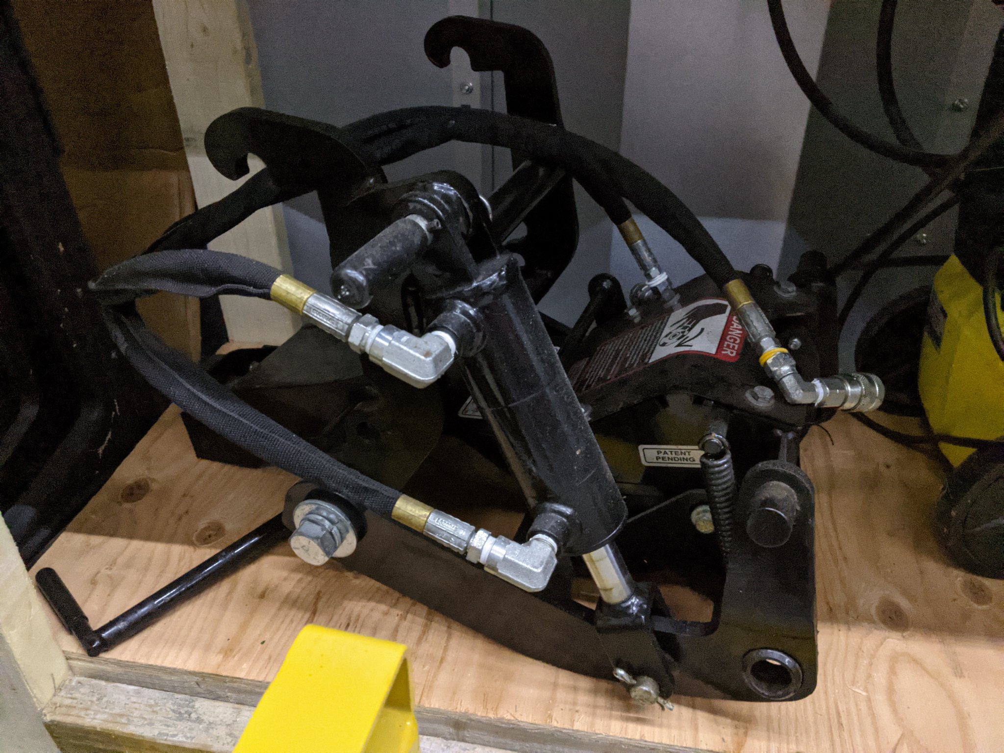

Not sure how close this is for a B series, but the BX 80 series looks like this. It hangs off the front subframe. A long drive shaft connects to the mid PTO. It's fairly heavy.
Hydraulics are for lifting. The implement itself could have hydraulics for what ever motion it needs.
