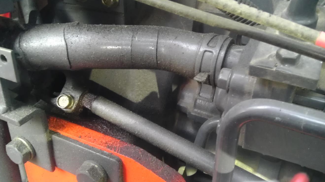

I reinspected my suction hose and found a crack that I had missed, I bet this is the problem as well.
