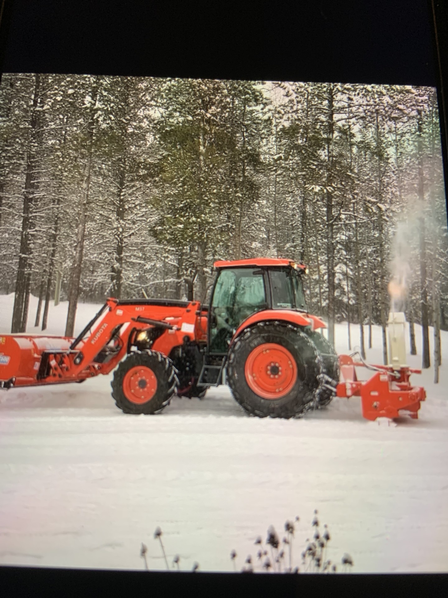

You're near McCall, ID so a very nice area for sure. My house is at 3,200 ft and even with wheel weights and loaded tires, a snow blower on the back and hydraulic angle snow blade up front, the MX6000 doesn't struggle one bit with the 200ft in elevation change on the driveway. That's 200ft in less than 400 yards to give some idea of the grade.
Extra hp buys you some wiggle room once the tractor is loaded down with weights and implements. I still think that an L6060 or MX6000 is the way to go, with the L being the fancier of the two of course. There's nothing that an L6060 can do that an MX6000 can't, at least nothing important, but it's a nicer cab and it has a superior hydrostatic transmission. I just can't get past the tiny front wheel/tire combination on the L6060, so even though I looked at them, I decided on an MX .... and an M6060 of course which is an entirely different animal.

The OP specified an L4479 (front mounted) snow blower; it will require a mid-PTO.
The only tractor options over 25HP are: LX, Grand L and L60 LE.
If you want/need the Turbo for altitude, your only choices are:
LX4020 or Grand L 50/54/6060. The LX4020 to L6060 price spread is about 15K, with the others in between.
Good luck with your choice.
