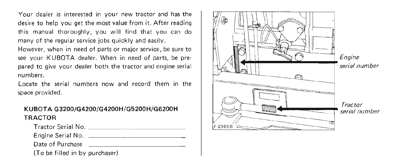

Hello all I am new here as I just picked up a new to me G5200 and have a ? re guarding parts I see a lot are serial number specific but the label where the serial number was is now blank any way I can figure out if it is an earley or late unit.
I also have not found the engine serial number any help would be great.

This reply does ot answer your question directly.
Start with downloading a free Operators manual for G3200 to G6200 tractors here:
G5200
The manual has this page showing where the engine serial number is located.
The wiring diagram at the back of the manual will be helpful at some time.
