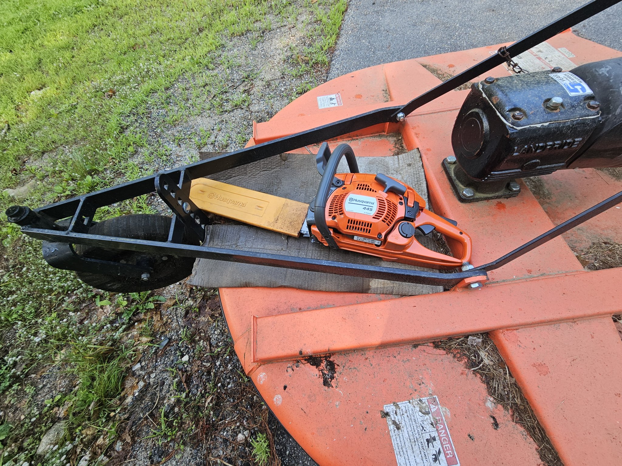

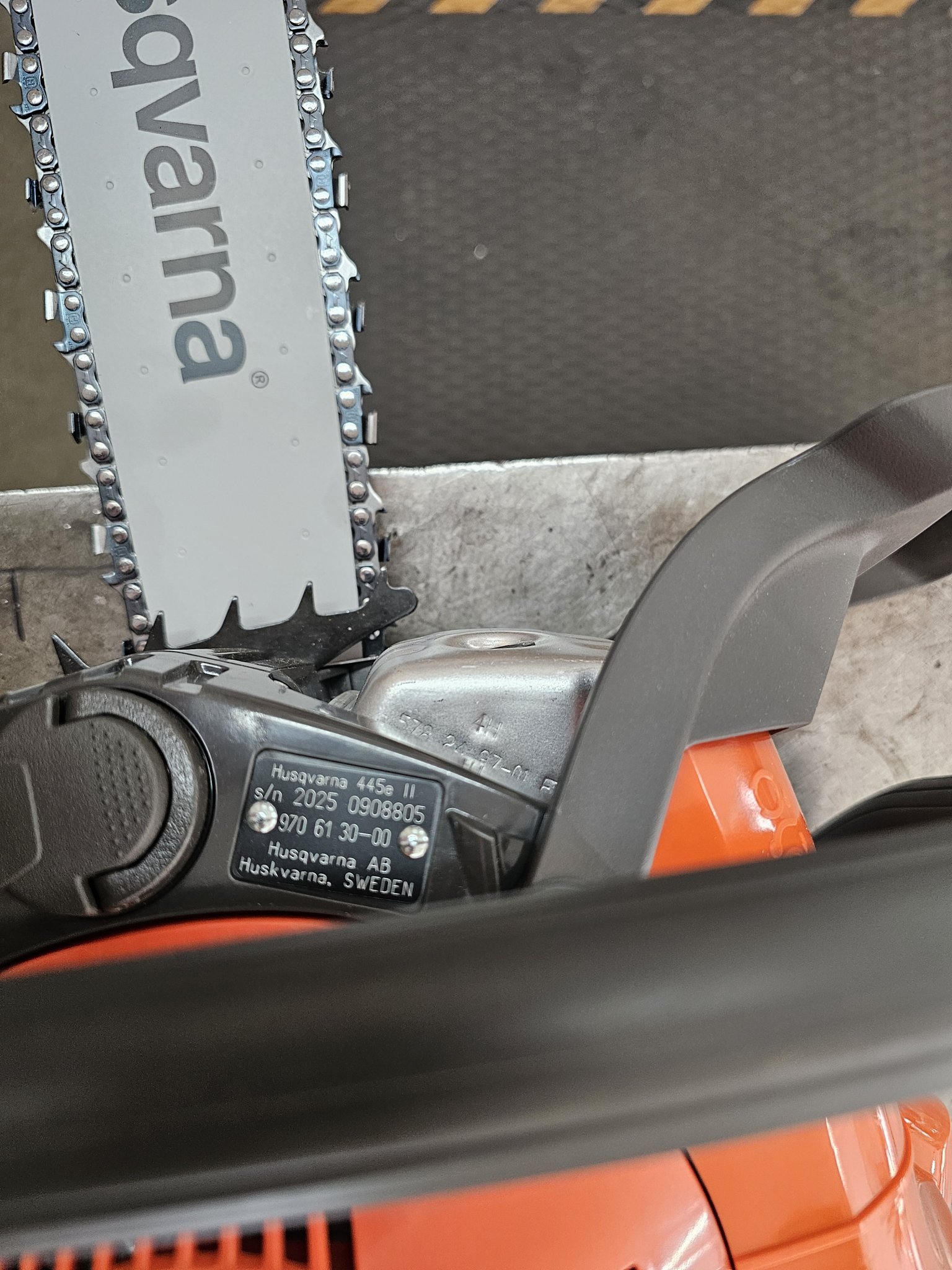

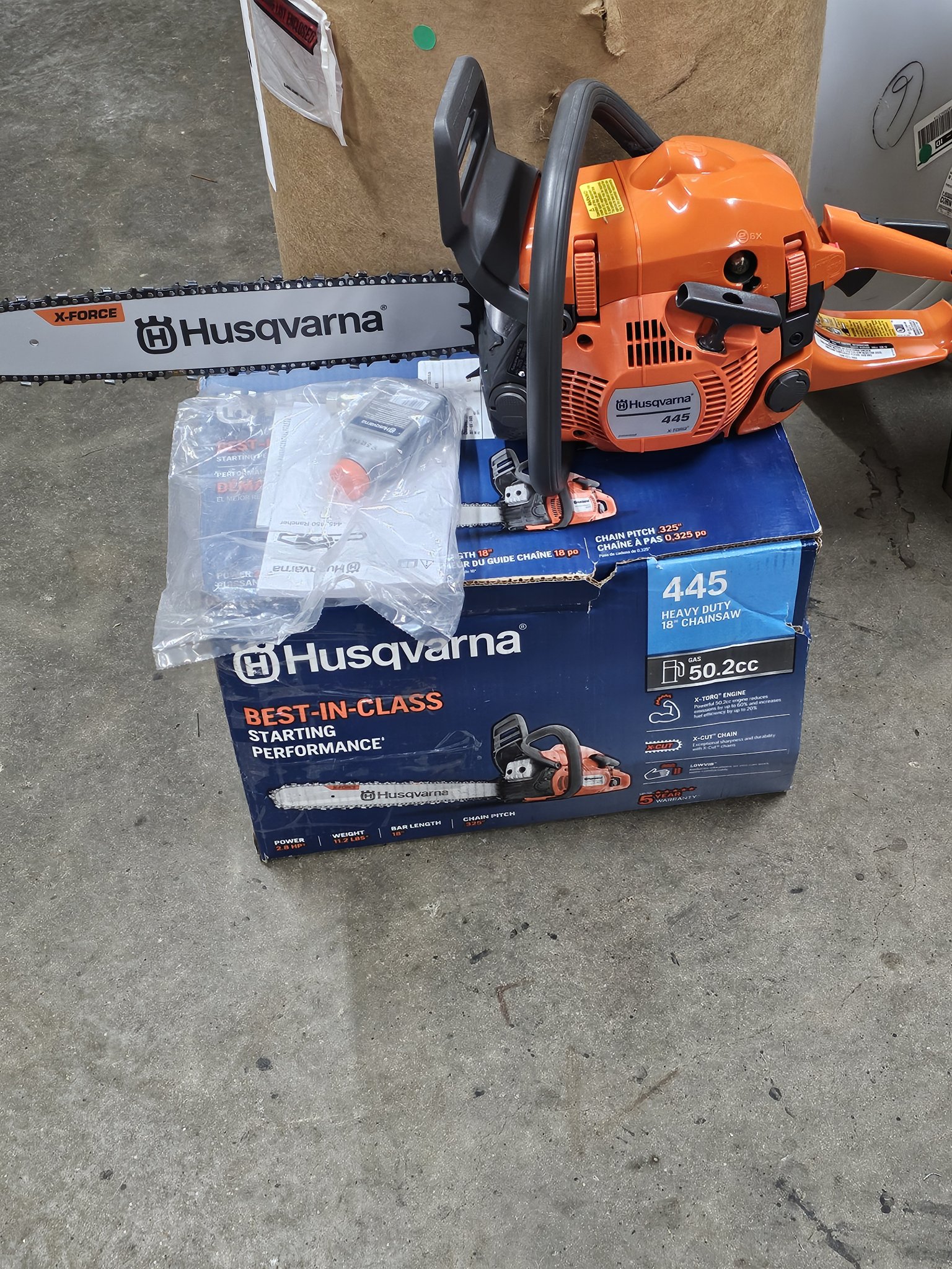

Im not near my saw. Ill take a better photo tomorrow.
But here's a couple photos.
It says it comes with a new design chain called the X-cut. And it does cut fantastic.
Except for one thing.
Best I can tell is it looks like semi-chisel safety chain.

X-Cut is patterned similar to racing chain, it's very fast/aggressive square-ground chain and is not sharpened per the instructions on the box. It's much, much better than modern Oregon chain (which I've encountered many chrome hard-spots on while hand filing), so it's worth the money. X-Cut holds the sharpness for a "long" time under normal conditions, hardness is between modern Oregon (Chinese "okay" chain) and STIHL chain.
