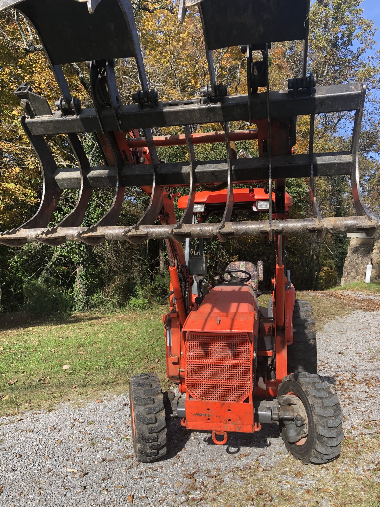

Move a lot of trees on our hillside mostly wooded farm. Grapples have been a blessing.
Like the dual lid for sure.

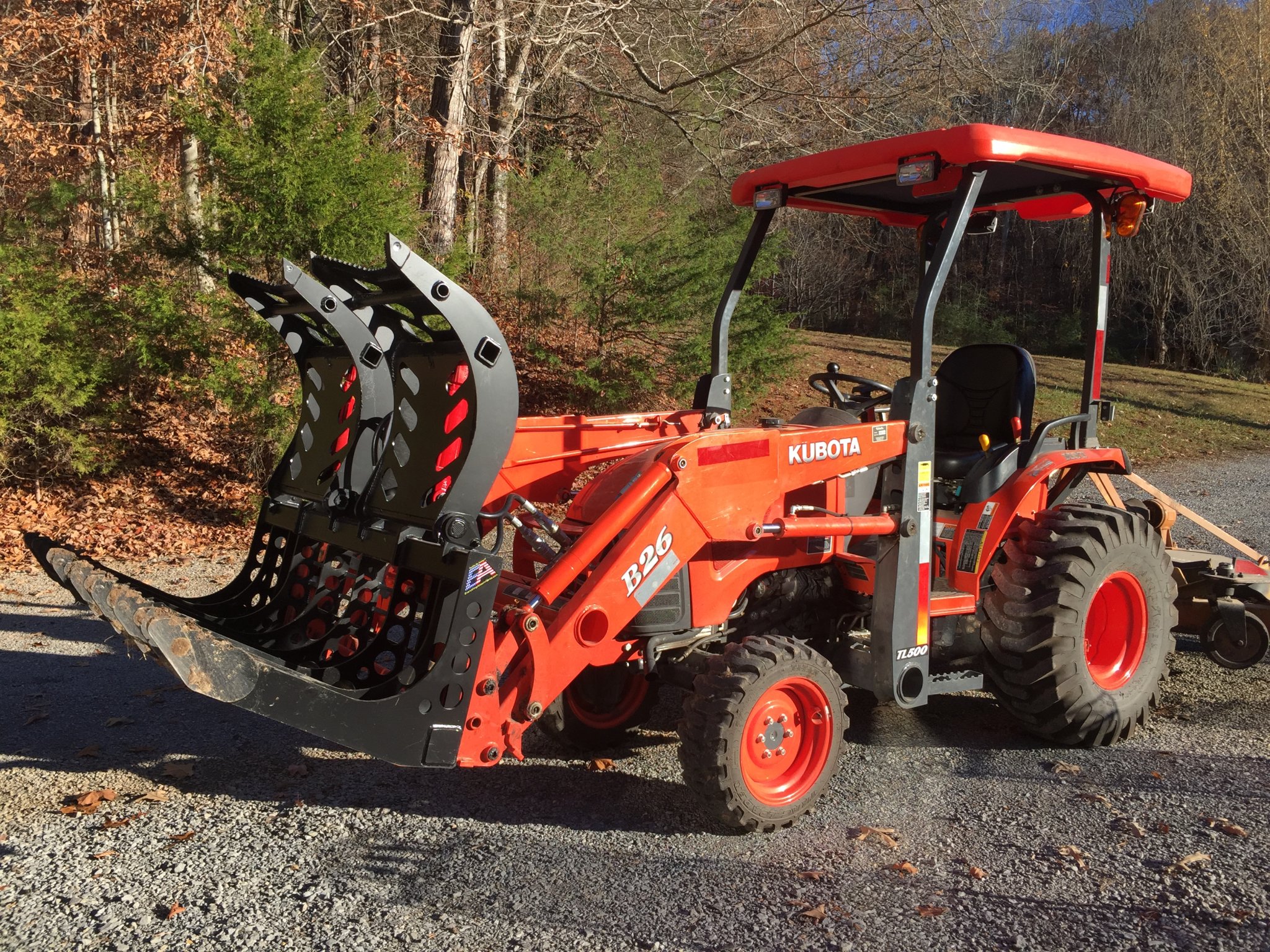

Wicked EA on B26 is best for size, weight and function.

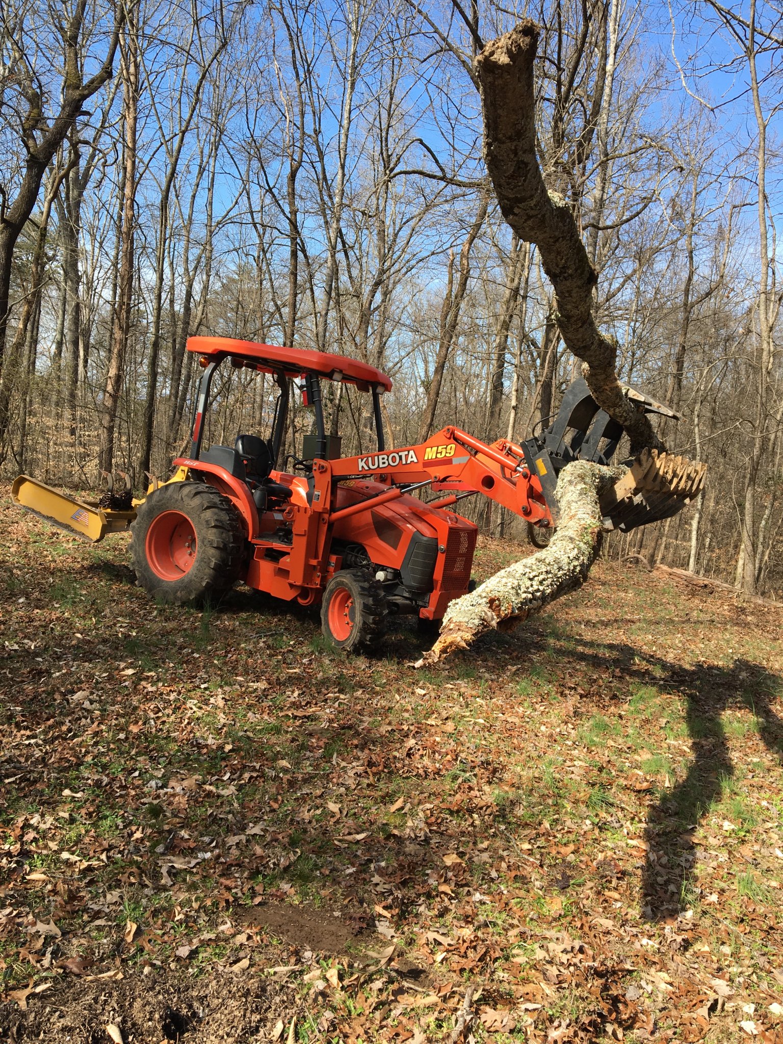

Skid steer grapple is 30+ years old on M59 has moved hundreds of tons of debris. Might be Blue Diamond brand but don’t remember. T1 steel.
Grapple 6-12” narrower than bucket. Don’t want a wide grapple.
Piranha tooth bar can clear and uproot small brush much faster than grapple. Can’t carry off debris and logs as well. Improves digging with low hp.
Do like the long bottom style for our use.

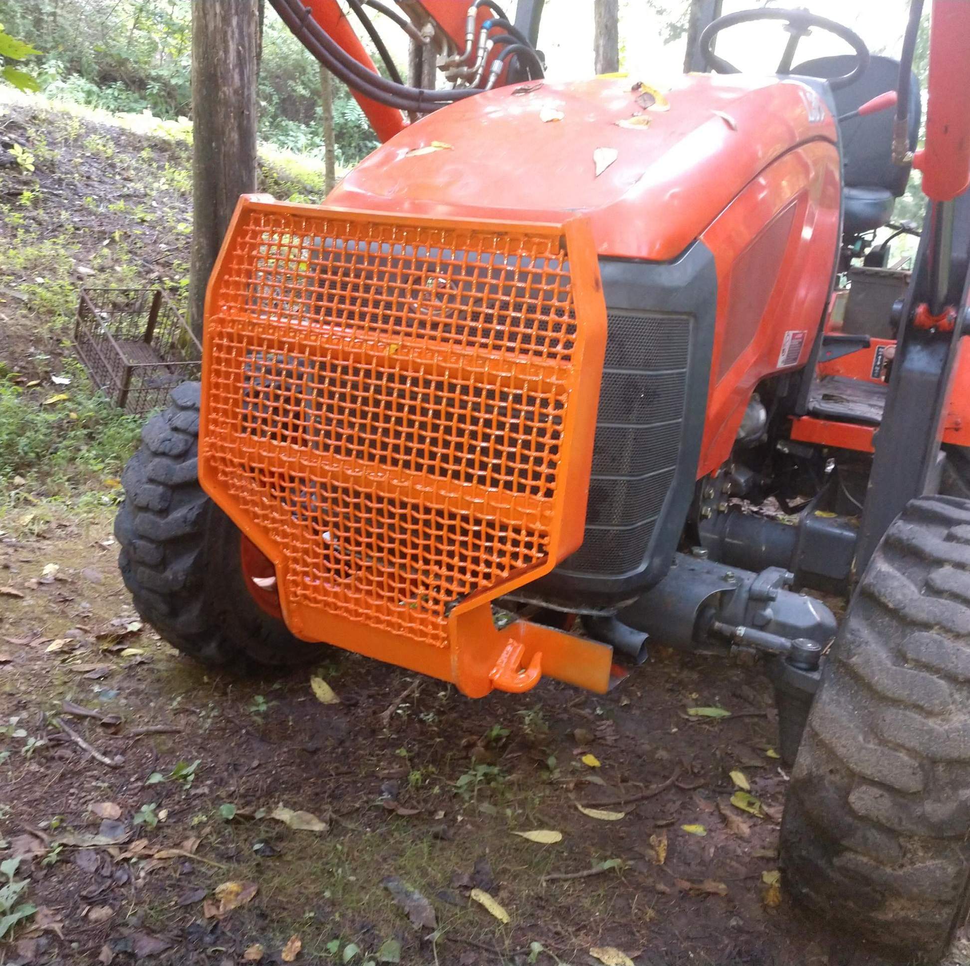

Must improve your grill guard. Do it before you find out why.
