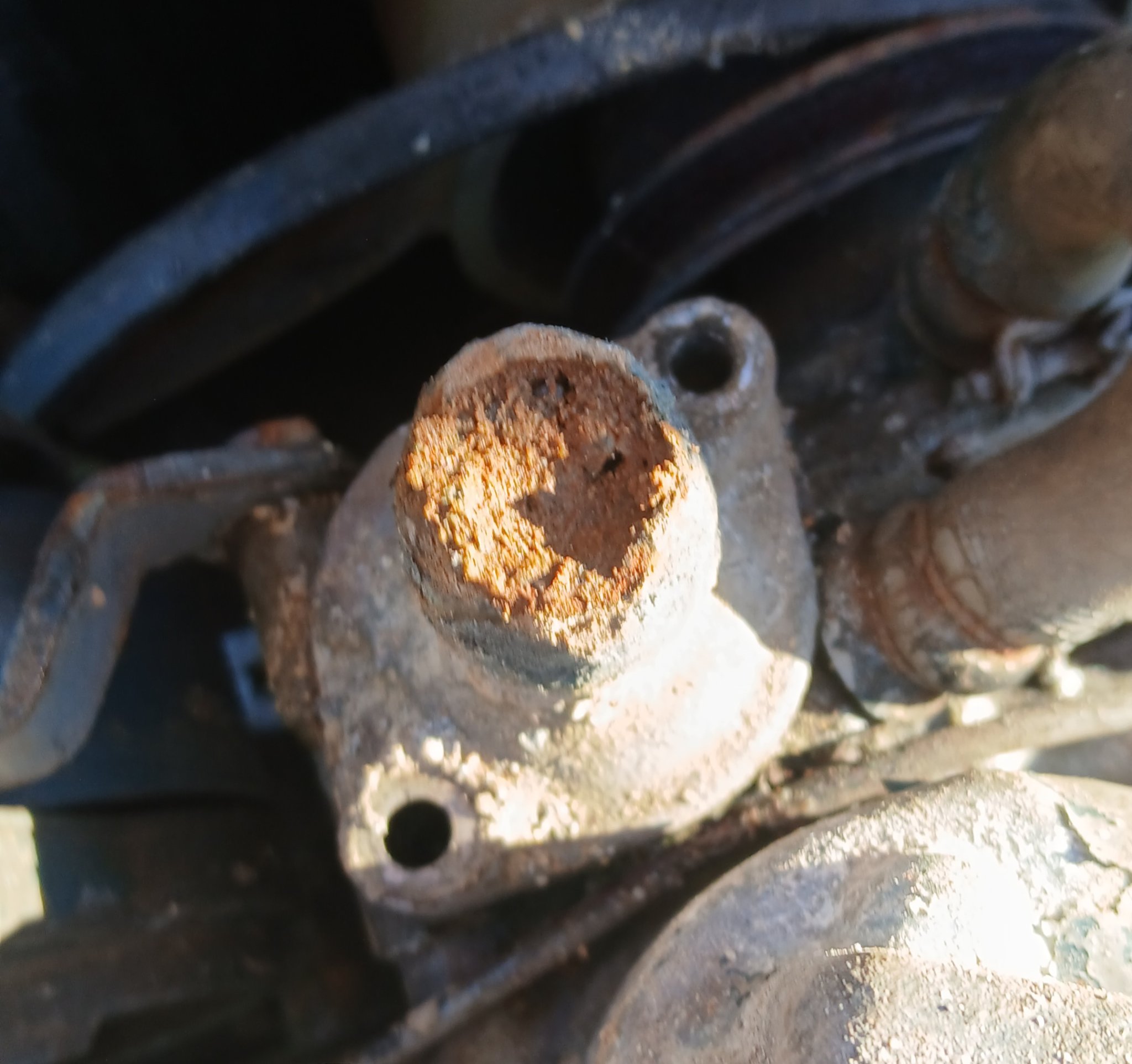

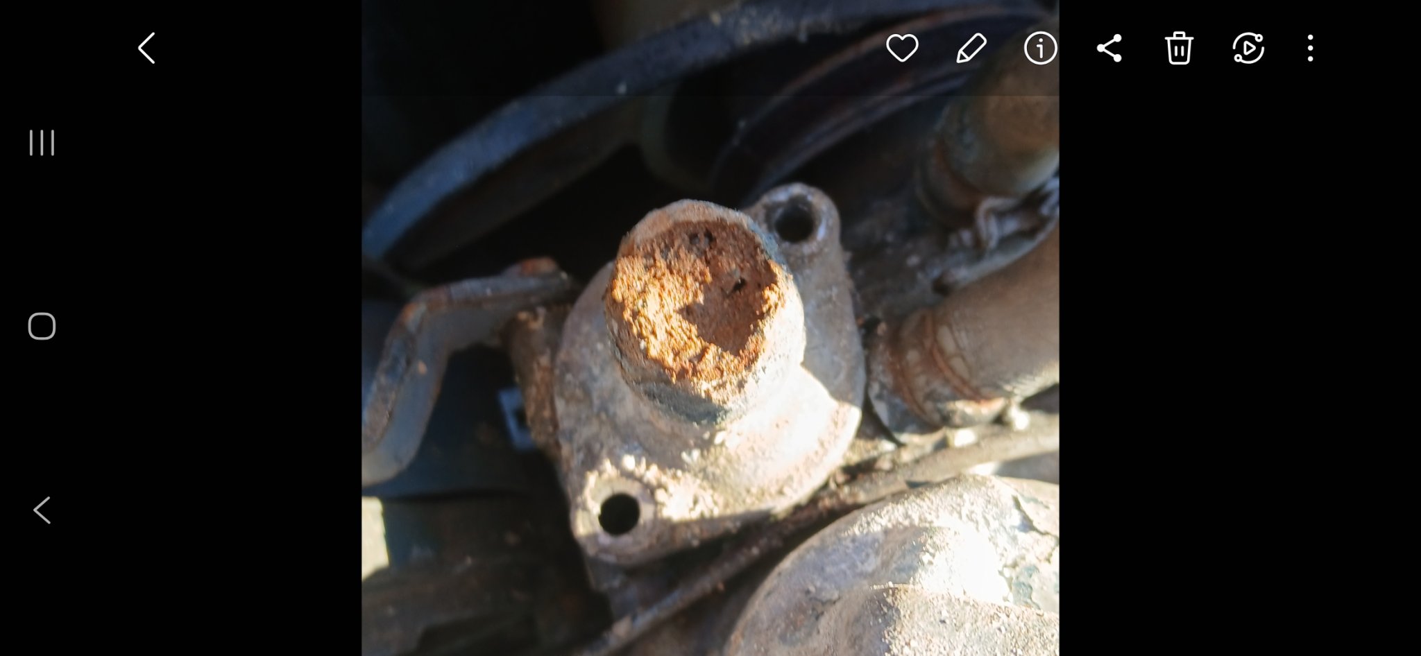

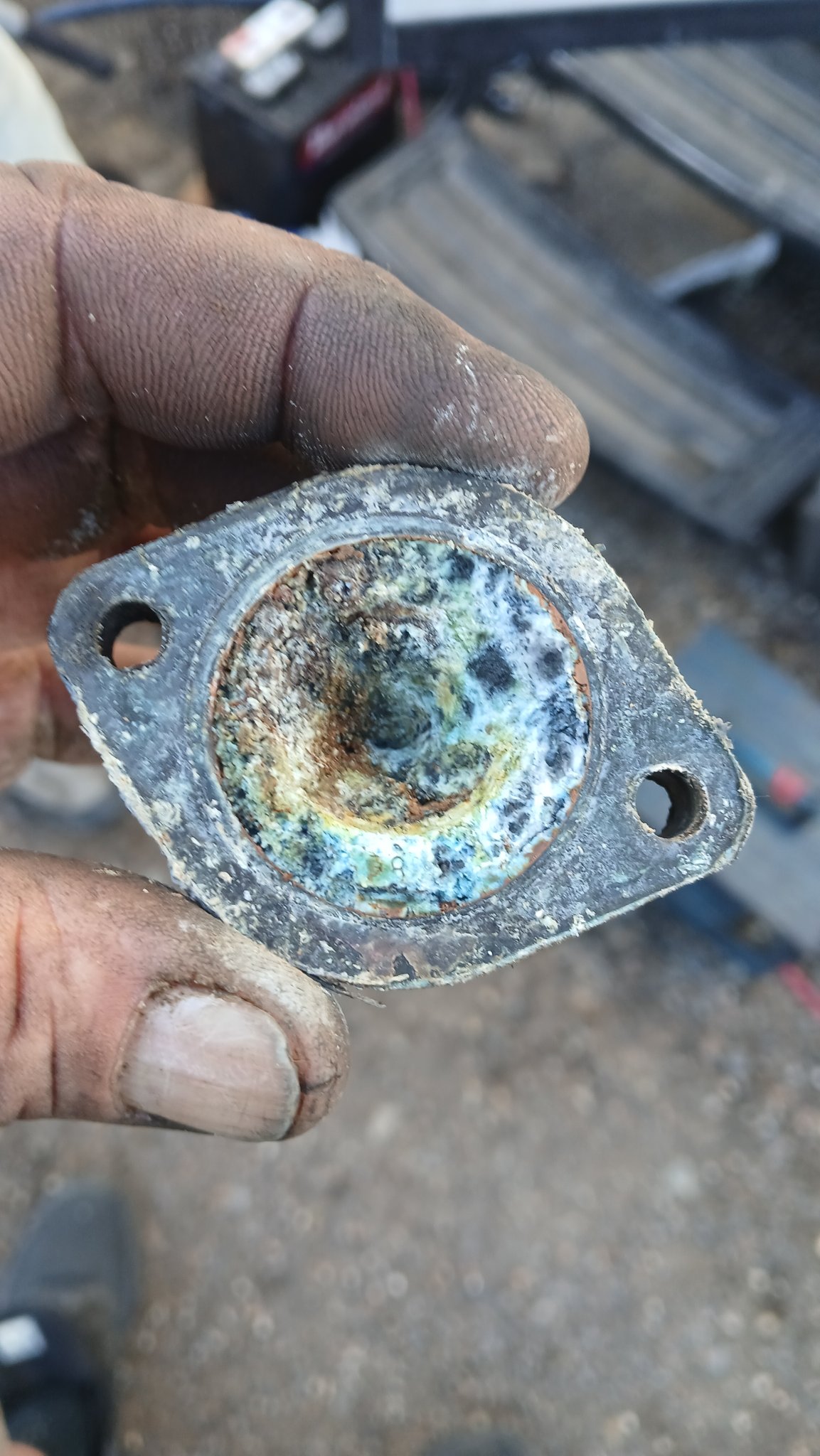

Bought new belts, checked the fuel system, electrical was charging, I greased everything, sharpened the blades and started running it through its paces. The first thng it did was began to overheat. I shut it down and serviced the cooling system and found the thermostat housing COMPLETELY stopped up with rust and oxidation. I replaced all the hoses and flushed and flushed and flushed, each time I ran it the little D600 engine ran better and better.

Pic of T-stat housing...
