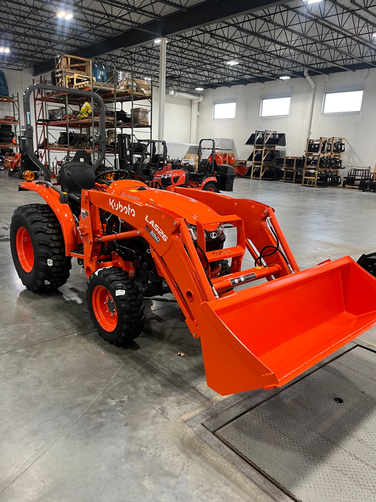

Awesome, thank you both for the quick replies! I dont even know what max rpm is on this at the moment, I think I read 2200 is max but unsure! Between being sick as a dog and delivering lp fuel during corn season I just put it in the shed and carried on til I could go about it with more info!

Phantastic, brand new !
And welcome to the Forum !
If this were mine I would be afraid to use it, not to put a scratch into the paint of this shiny front bucket :ROFLMAO:
p.s.: when lifting the bucket make sure to tilt the bucket forward as it goes up. Good few people put dents into the bonnet (hood) from stones falling out.

I appreciate your words of wisdom there!!! Luckily I've got a little experience on skid loaders and loaders! I'll be watching for it! Although it does seem to unlevel quicker with the arm angles...And its gonna be hard to use since there's not a scratch on it! I was very picky about wanting one out of the crate that Noone has played on yet! That's my job😋

Welcome aboard and very nice tractor!
That is the problem, it will be hard to use it because it is so new and shiny. I tell you what: you put this tractor into a glass cabinet in your living room and you buy a well used one for the work. :ROFLMAO:
