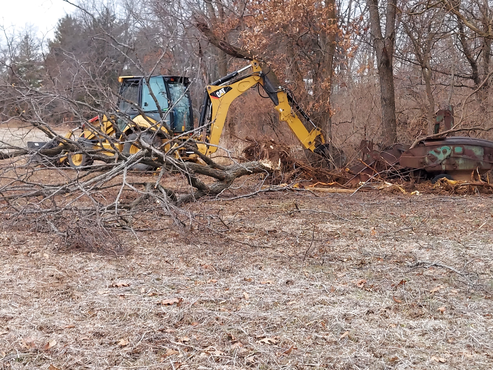

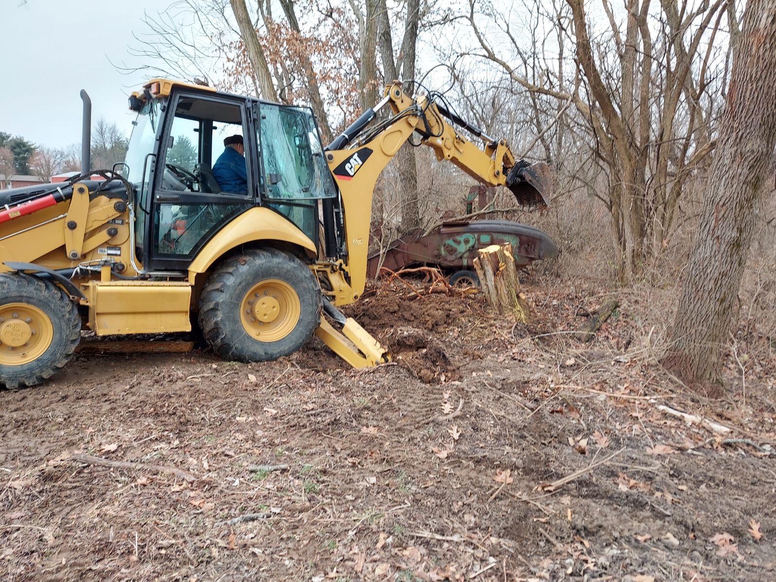

Unfortunately without a backhoe, removing a 15" stump is going to be challenging. I have tried to dig them up with my bucket and my grapple with limited success. I ended up turning to our retired neighbor who loves playing with his toys and having him come help me out.
