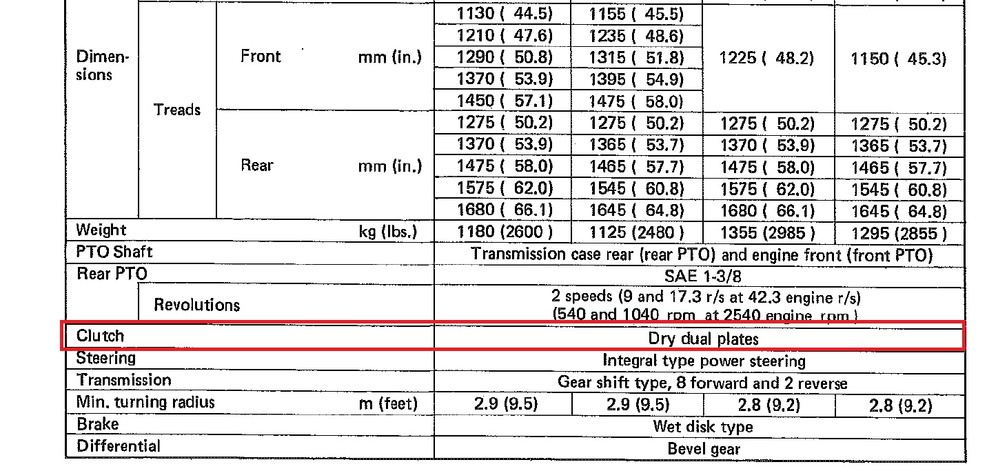

You need to determine if your tractor has an independent pto. Not all do and those that dont act like yours is now. The lack of a low pto speed may mean a shift fork is out of position internally.
Dave
p.s. I found I have a copy of the Owner's manual for your tractor and it shows a dual plate dry clutch setup.
The documents for tractors of this era are full or errors or incomplete info so I add that caution.

The L345 has a 2-stage clutch, one disk for travel, the other for pto. They are not separately adjustable like on other models. As the pedal linkage is adjusted for wear, it gets to a point where the pto clutch no longer disengages.
The good news is that when you split the tractor for a new travel clutch you likely wont need to touch the second (pto) stage. With a new full-thickness travel disk the pto will again disengage normally with pedal full-down.
