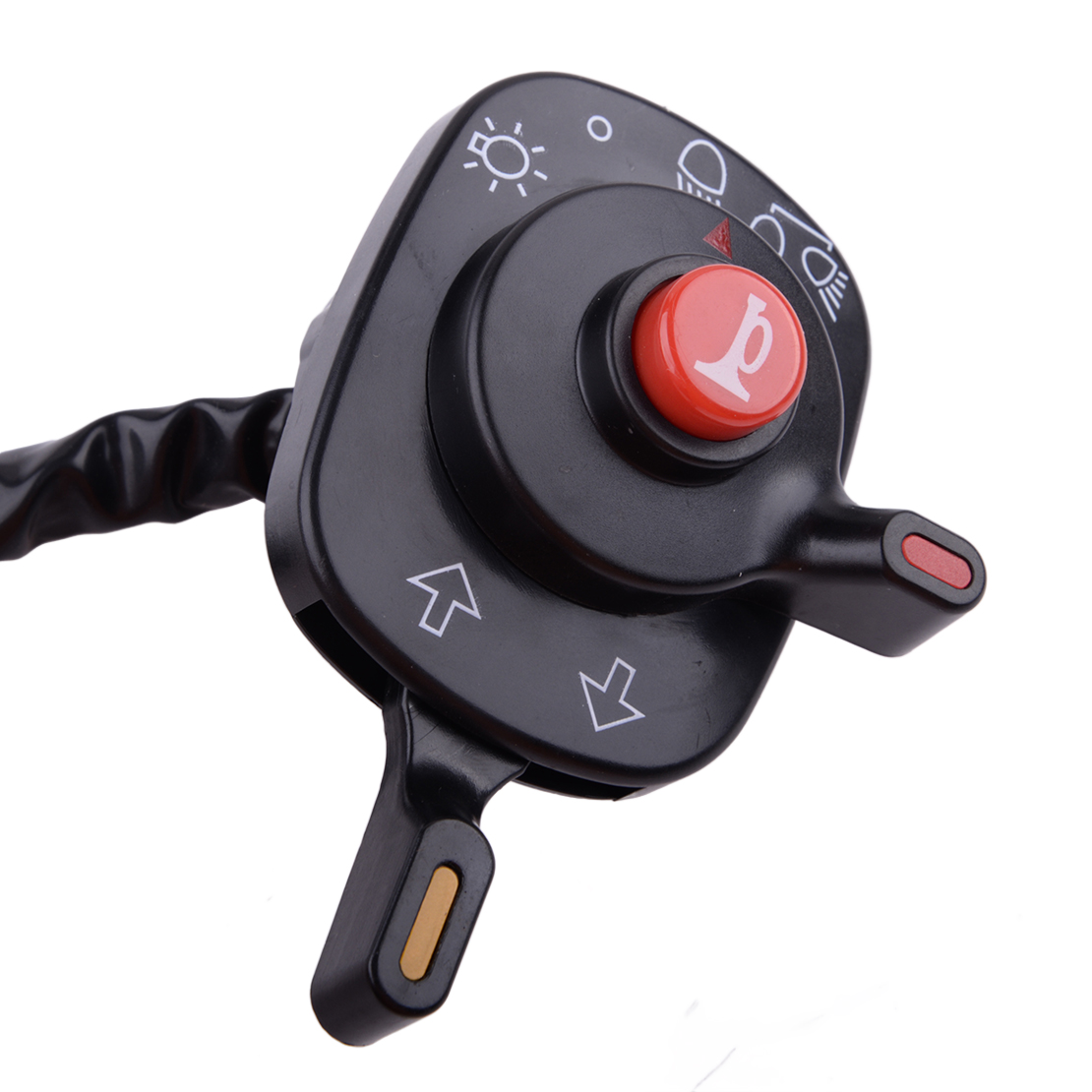

I am building an AC Cobra replica in Australia and am using an aftermarket combination switch that was designed for a Kubota harvester (picture attached) .
Doies anyone have experiance with these switches and could help identifing the purpose of each of the nine wire elements? Have run a multimeter over the wires to have a guess at what combination provides an output but still not sure i have this correct.

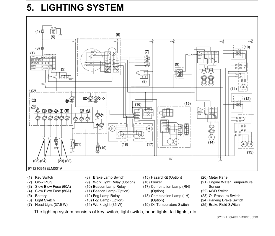

I know the connector is a Sumitomo, according to the BX23S WSM.

Thanks for that. I dont actually have the connector plug only the wires. Will have a go searching. Thanks for your help

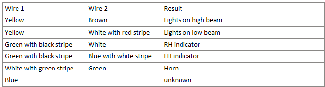

The Kubota part number is K7711-96130. This switch is used when adding the optional turn signals to an RTV-X1100c, and others.
It looks to be the same switch.

Mate, thanks so much this is just what i am after, however when i print it its so small and when i enlage it (on screen) all the detail is gone. Do you have a higher resolution version?

curious, I 'right clicked copied',saved to desktop, used IRFAN to open it , could see it OK,fine even at 217%.

Yep. thats the way to do it. I initially clicked on the message thumbnail rather on the attached file. Thank you for your help
