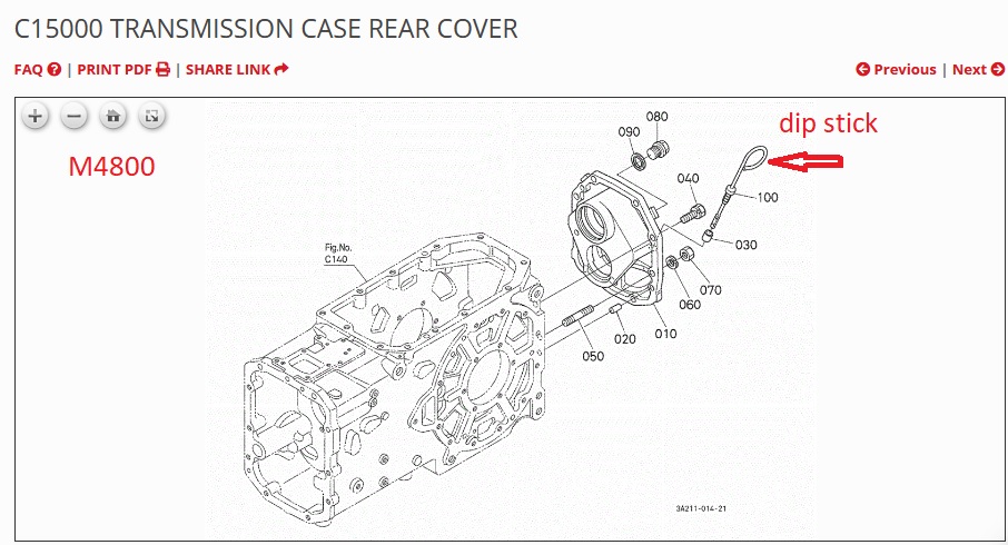

Need to know what the dipstick on back of tractor is for.

Did you check your owners manual?
From looking at the owners manual there is no seperate hydraulic tank or dipstick listed. Alot of tractors use the transmission tank as both the transmission fluid and hydraulic fluid tank.

On the M5660 I have 3. Engine, front axle and transmission/hydraulic. Tranny one is right above and to the left of the PTO.

Ok thank you. I dont have manual. I buyed the tractor used. Do you by the way have a image of it in a manual?
