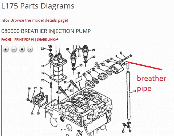

Looking at the L175 parts illustration the pipe in question appears to be a breather pipe for the fuel injection pump and should have a length of hose attached so any leakage drains unto the ground.

Yea I understand it's a gray market and for the most part I've been able to find what I've needed. I figured it was some sort of breather but I was alarmed by how much oil is coming out of there. Looking at that diagram you posted, is there maybe a diaphragm or something that would help retain some of the oil? Or is that much oil coming out an indicator that something is off time or worn out?

From looking further at the parts info, there seems to be some sort of media inside the housing.
The media etc may serve to block raw oil from exiting the housing.

I know on my L185 there is a similar vent on the valve cover. The media there is something like a Brillo pad.
If you take your vent off you can probably see what happens if you run the tractor for a little while. There should be some oil mist there or some oil spray but I assume the vent would be placed well above any oil level.
On mine it is the highest point on the engine but still has some oil dripping out due to blow by.
The Kubota tube is nothing special on mine, it just fits tight onto the vent and in a support or two. The material used is fairly stiff and hardens with age and contact with oil.

@Russell King this breather that @Dave_eng mentioned is indeed similar to what you mentioned having on your L185. I pulled the breather off this morning and inside is a piece of perforated steel, then a stainless brillo like media, then another perforated steel. Nothing was plugged or torn so I just reassembled.
