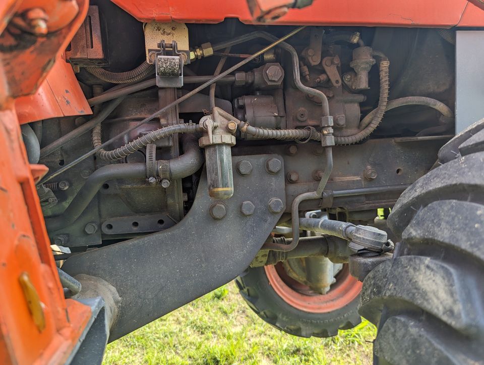

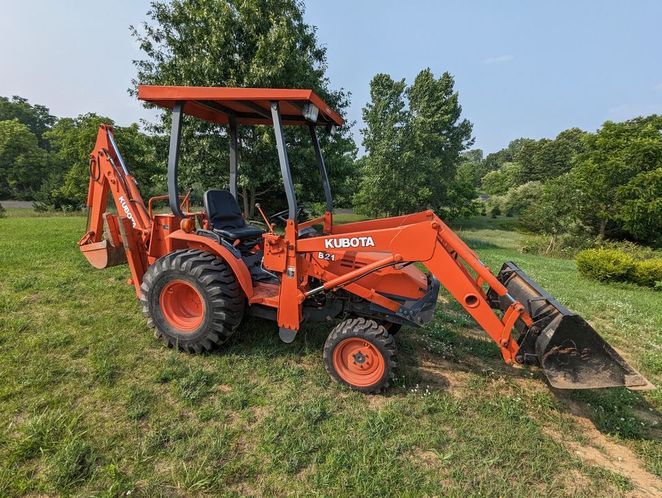

Hours bothers me a bit too. 600 hours but this owner said when bought 5 years ago tach was disconnected. So not real hours. The condition per photos, looks lightly used. But that’s mostly paint. Trying to attach a few photos.

Looks to be in very nice original shape. Fuel filter looks filthy, and boot on tie rod torn, easy fixes that have been neglected. What else has hmmm.....

It does look like the paint is in very good shape if original. maybe its the picture, but your last picture depicting the split tie rod boot- it looks like the inner tie rod has a bend to it and the front tire looks relatively new (it still has the new tire nubs). I call them something else, but won't write it here.

I was going to ask about the apparent bend. That’s why I attached that photo. I am leaning heavy to passing. It’s not the paint, it’s the bones that worry me. You guys have all be super helpful. Thanks!!!!

edit: forgot to mention that the loader has a direct pin on bucket (no SSQA). That would be a deal breaker (for me) right there.

600 hours sounds low, but it is possible. It doesn't look like it's been in a rental fleet, you'd typically notice that. Even if it had 2,000 hours, those TLB machines are tough.
SSQA only matters if you're swapping the bucket for forks or whatever. Some do, some don't. And you can get a pin on quick attach if you're so inclined - limits you to implements you own and modify, but it works. I did that on my B2601, and modified my forks to match.
Bent tie rod. Sure. My BX had lots of bent things. Didn't stop it running. I wouldn't pay new prices for a beat up machine, but again that's a price discussion, not a "don't buy" problem. Of course, in my part of the world these machines are hard to come by, you don't really get to decide to wait for the next one, you never get one if you do that.
