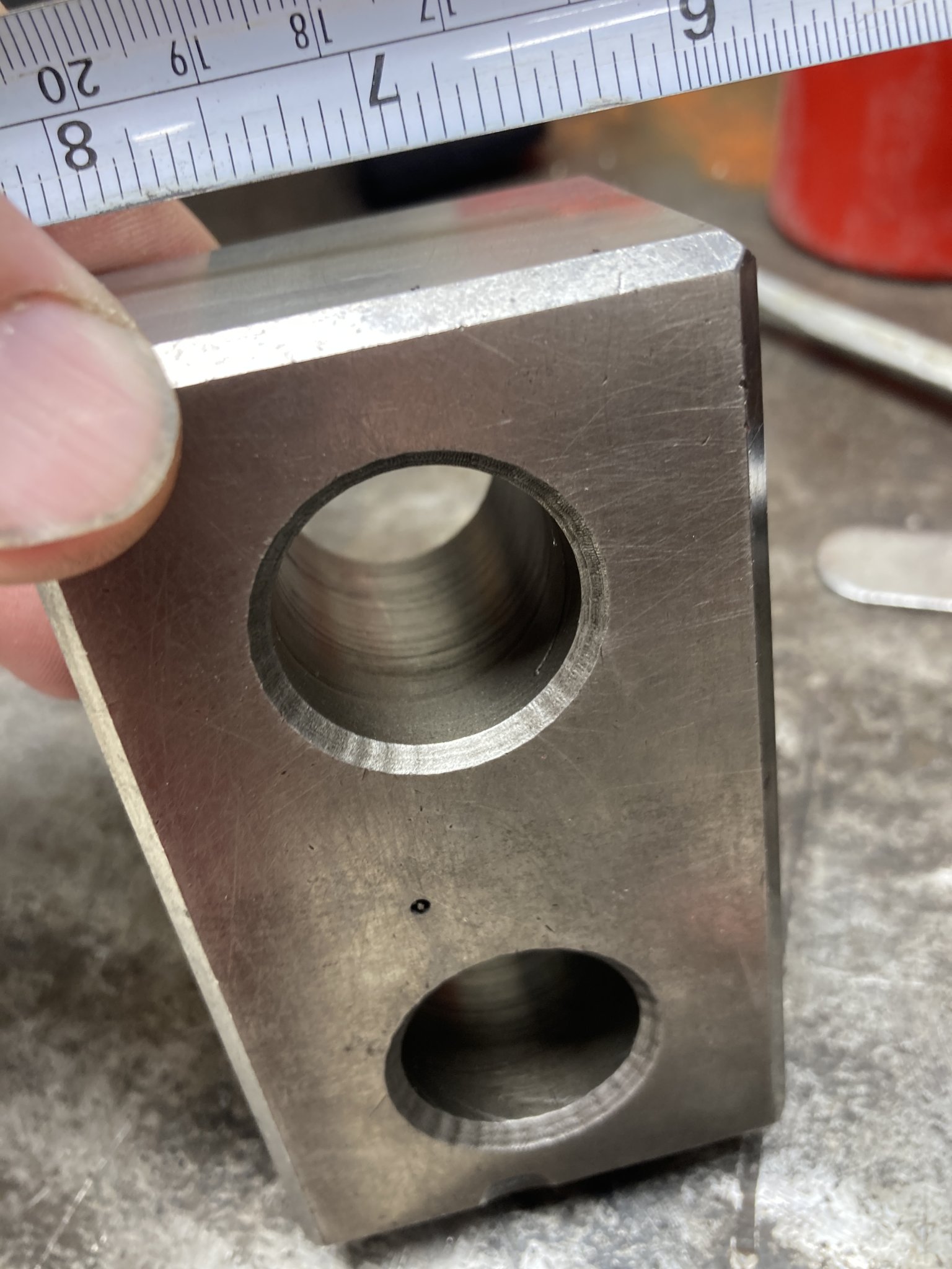

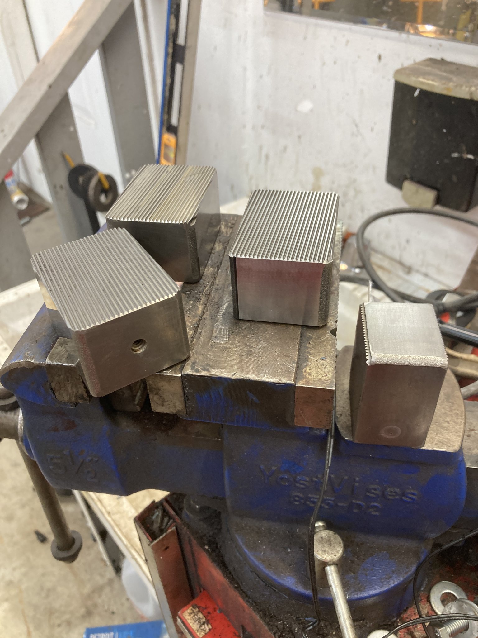

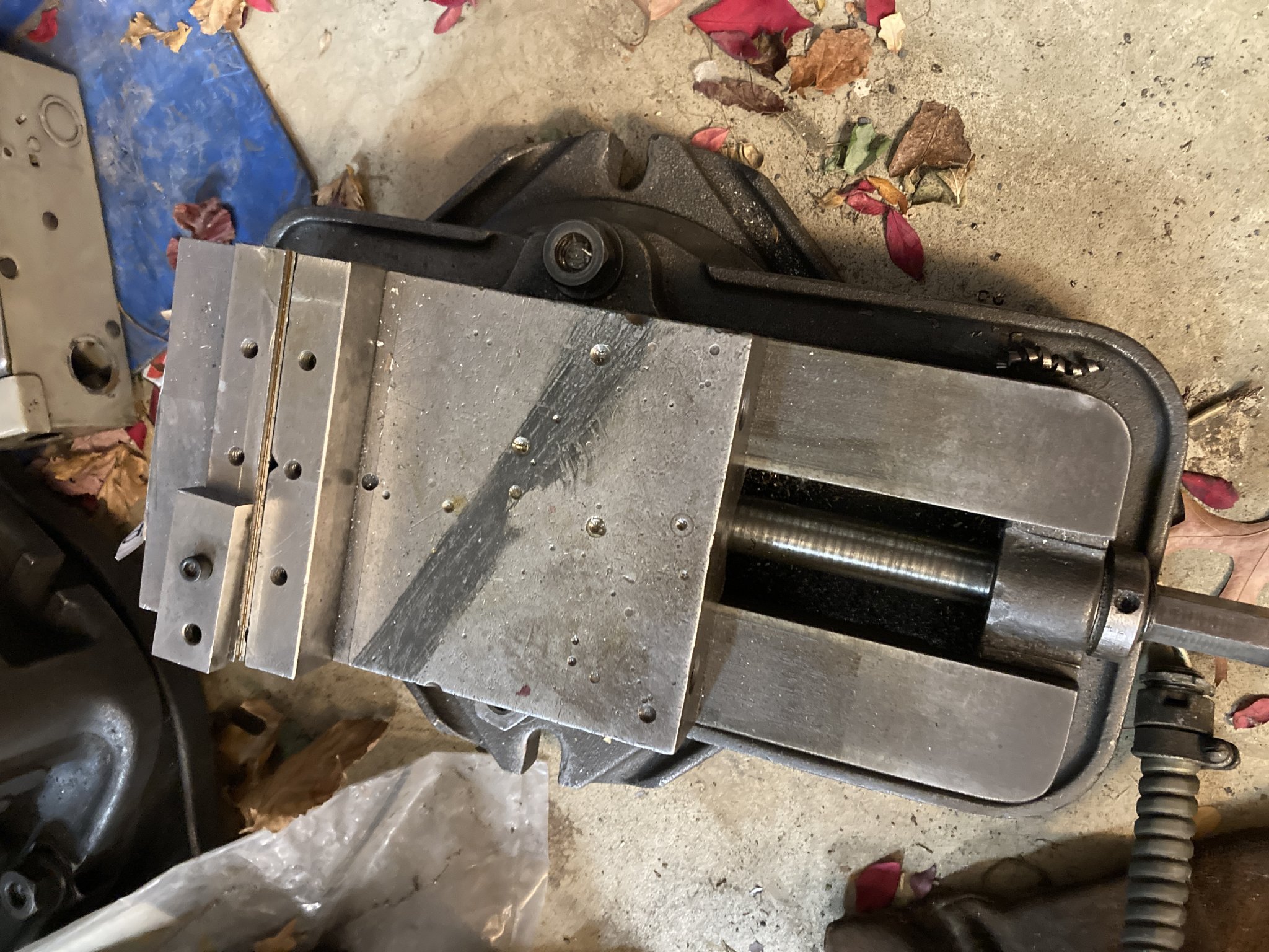

What “type” of vise(s) did I buy?
Here are close up’s of the “non-BP” one's that I got.

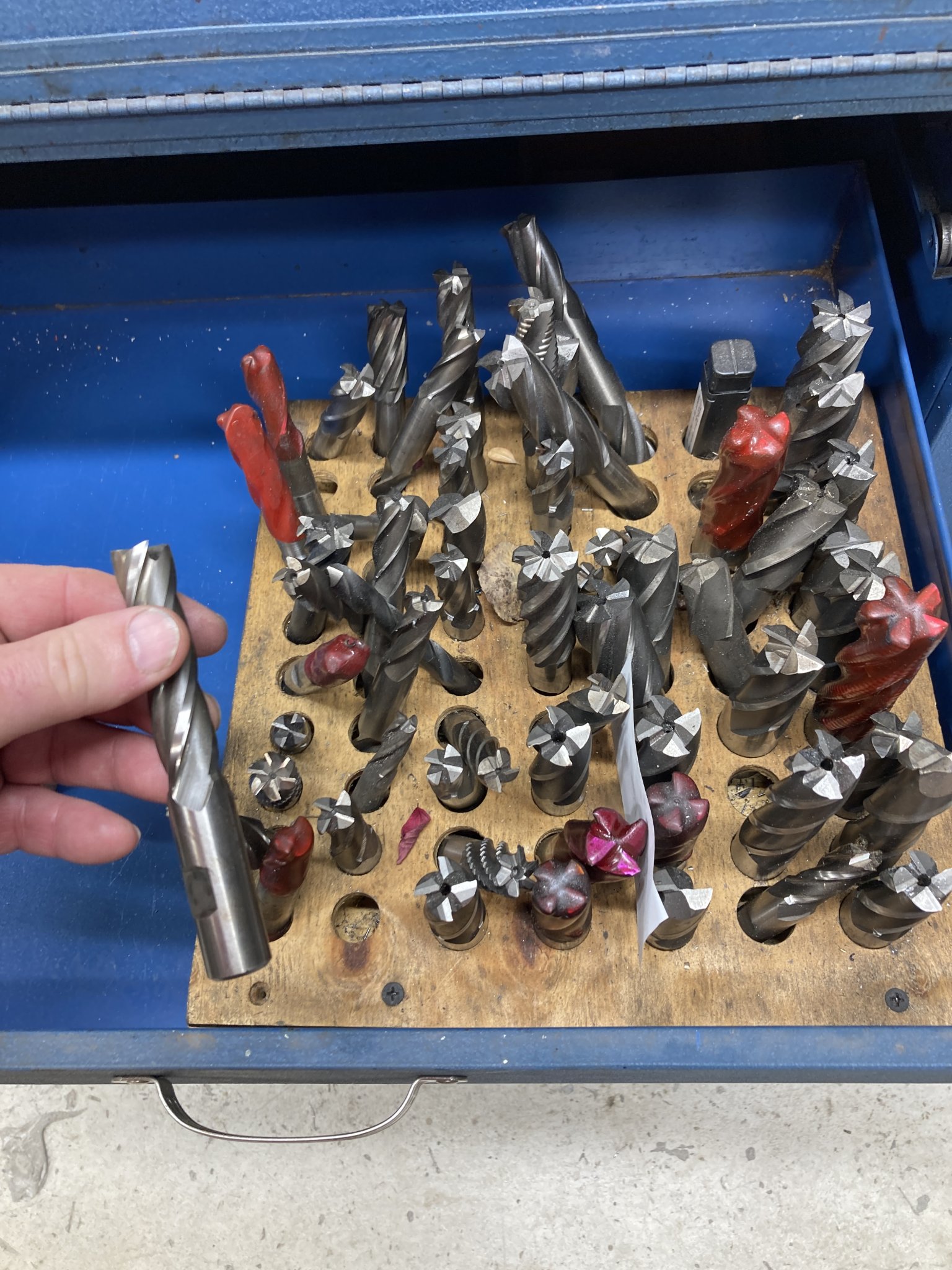

I got a little carried away with bidding on these end mills, (138 bucks) but after buying a small “Good Chi-com set” (is that a thing?) for 70 bucks off Amazon about 3 weeks ago, maybe I didn’t do too bad.

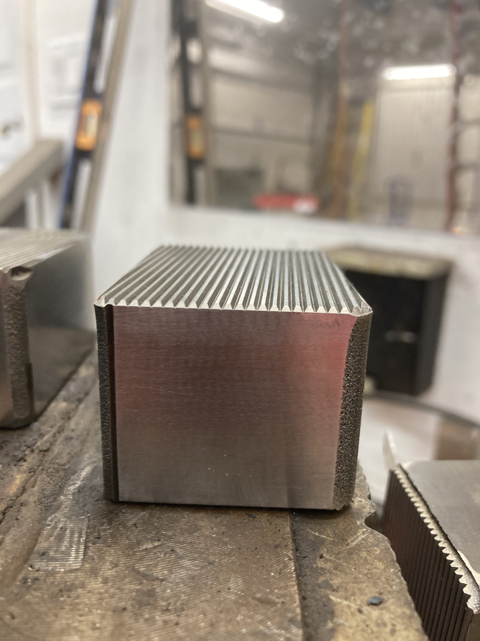

I have one Parlec brand vise that is a copy of a Kurt, it has been excellent. Your vises have been abused so check for wear by disassembling them for cleaning and inspection. I see one of them has bumps raised up from clamping junk, those jaws should be hard, you can buy replacements. Having two vises that are matched can be useful for long workpieces.
I went to an auction a long time ago and bid on a very large block of endmills but the yuppie outbid me. I cringed when he pulled each endmill out of the block and tossed them in a bucket one by one, what an idiot.

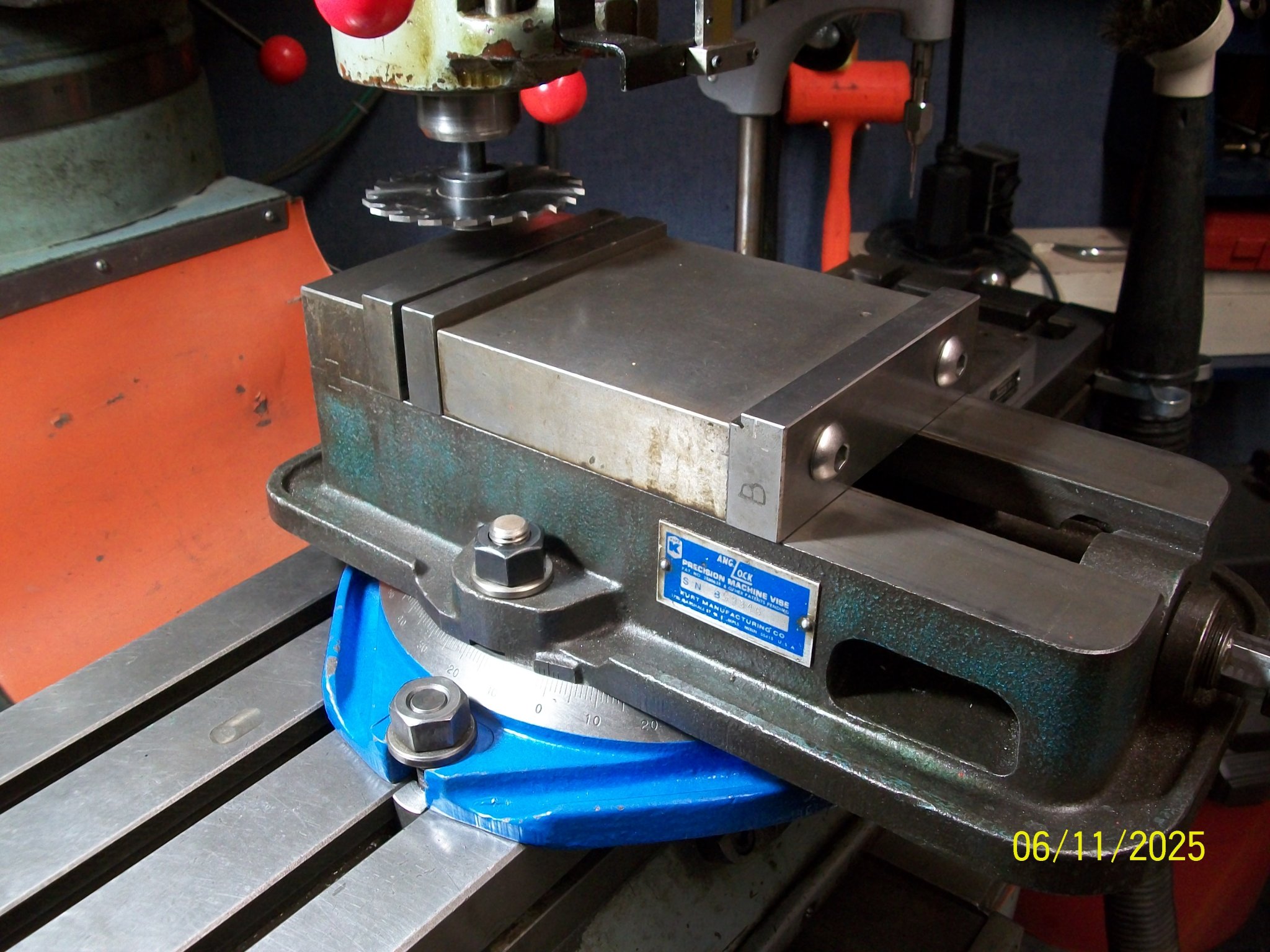

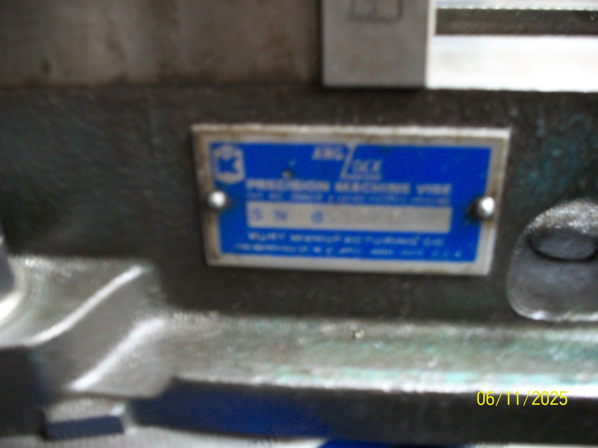

Here's a tubalcain vid on Kurt mill vises.
The two pictured above LOOK like Kurt.
I was once told by a Kurt rep that all Kurt vises and swivel bases have serial numbers that can be used to date them, but I'm not sure that applies to very early ones.
We had a couple old ones at work that had no serial number tags, but look at the sides for evidence of the rivet holes or adhesive residue. where the tags were.
If all else fails you can take them apart. (and you probably will anyway, I'm guessing :))

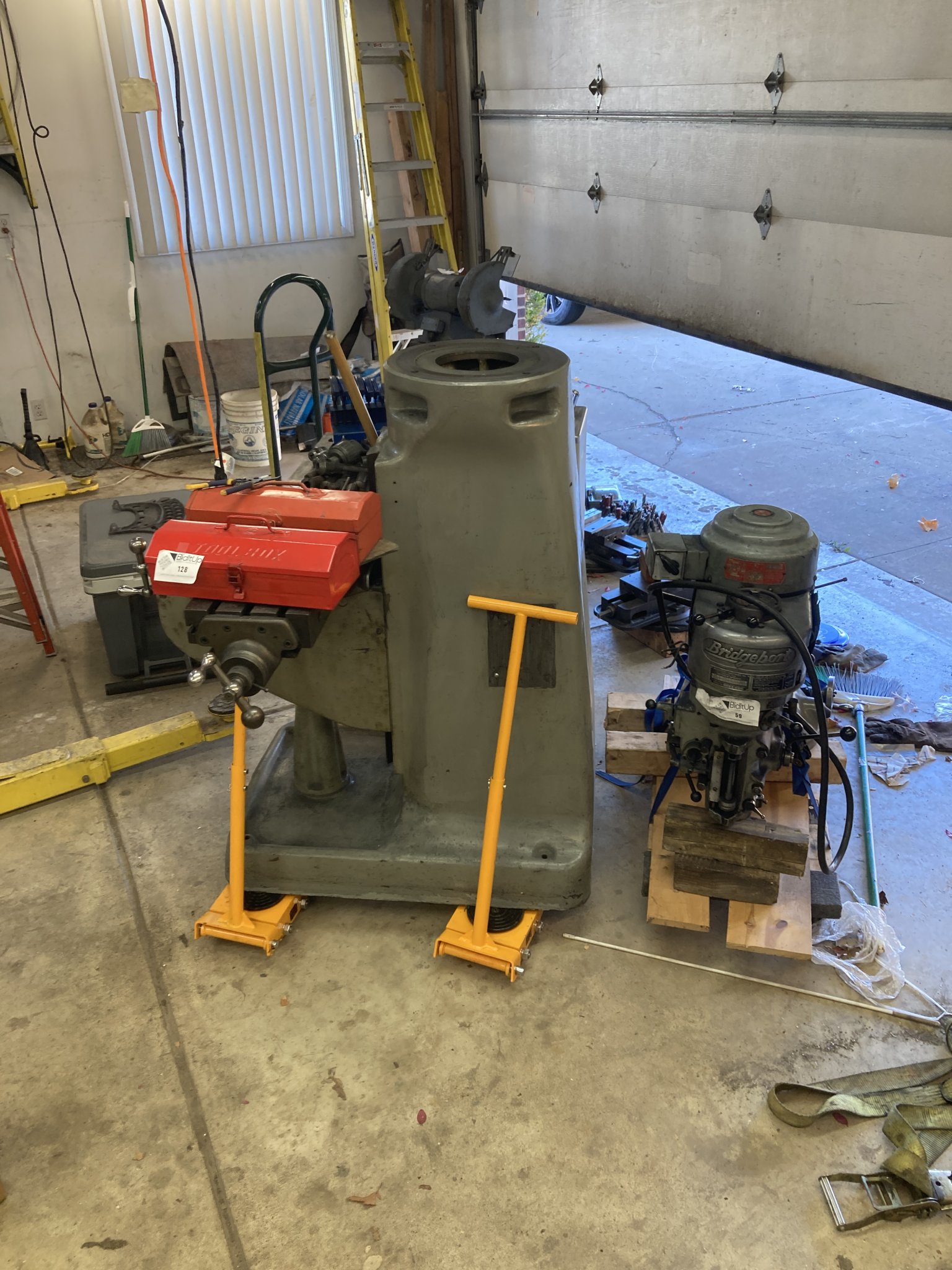

Congrats on the new mill.
You did great on the cutters, looks like a good variety, assuming they are not dull beyond use.

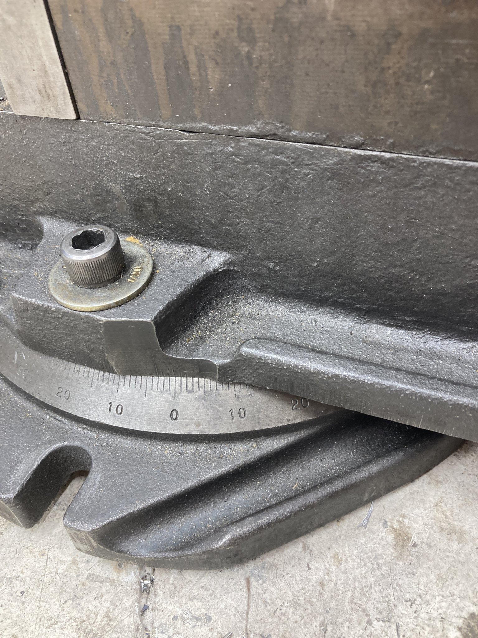

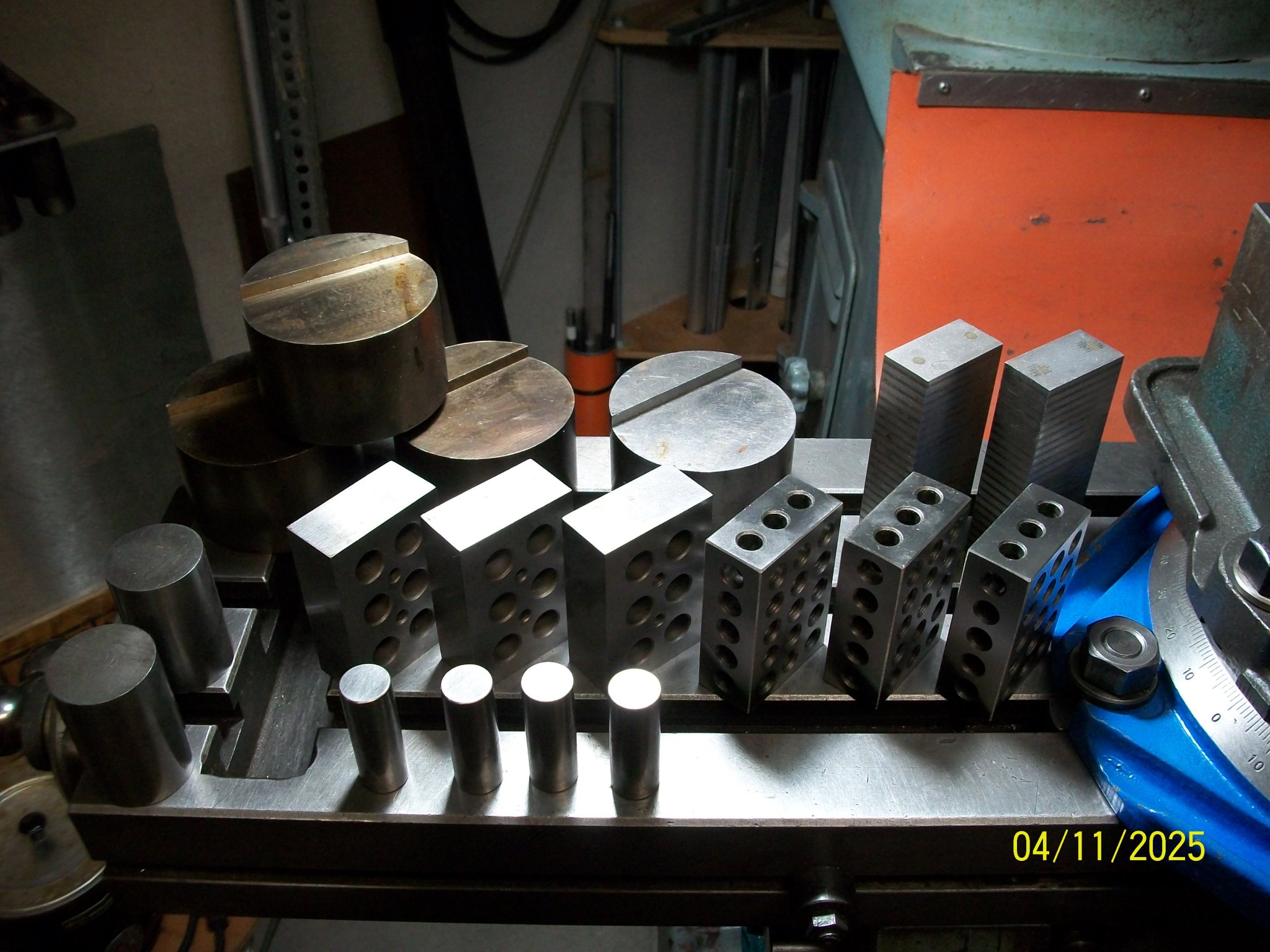

Quick observation- one of the vises you posted has allen head bolts & light washers securing it to the swivel base.
Probably need to upsize/upgrade those.
I have found those to be less than satisfactory under heavy cuts.
I like large heavy bolts/t-nuts with thick hardened washers. (as you can see in my pics)

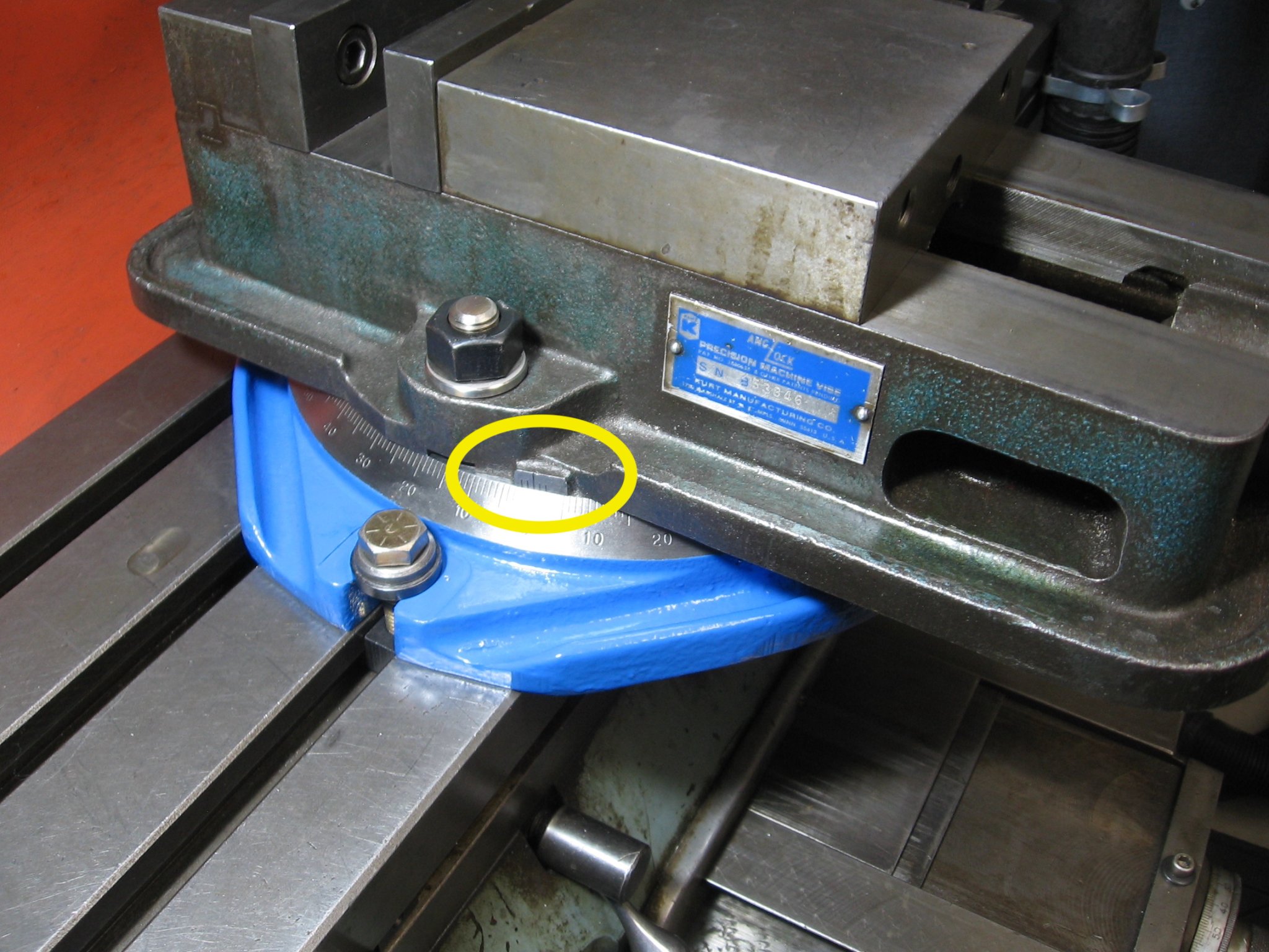

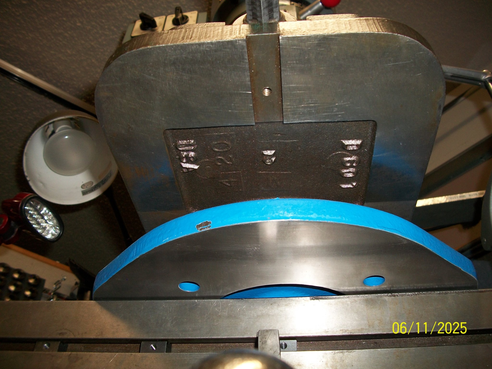

Another Kurt ID clue.
A buddy mentioned that all the Kurts have a boss with graduations for the swivel base.
Not sure about that, but I thought I'd pass it along. (yellow oval)

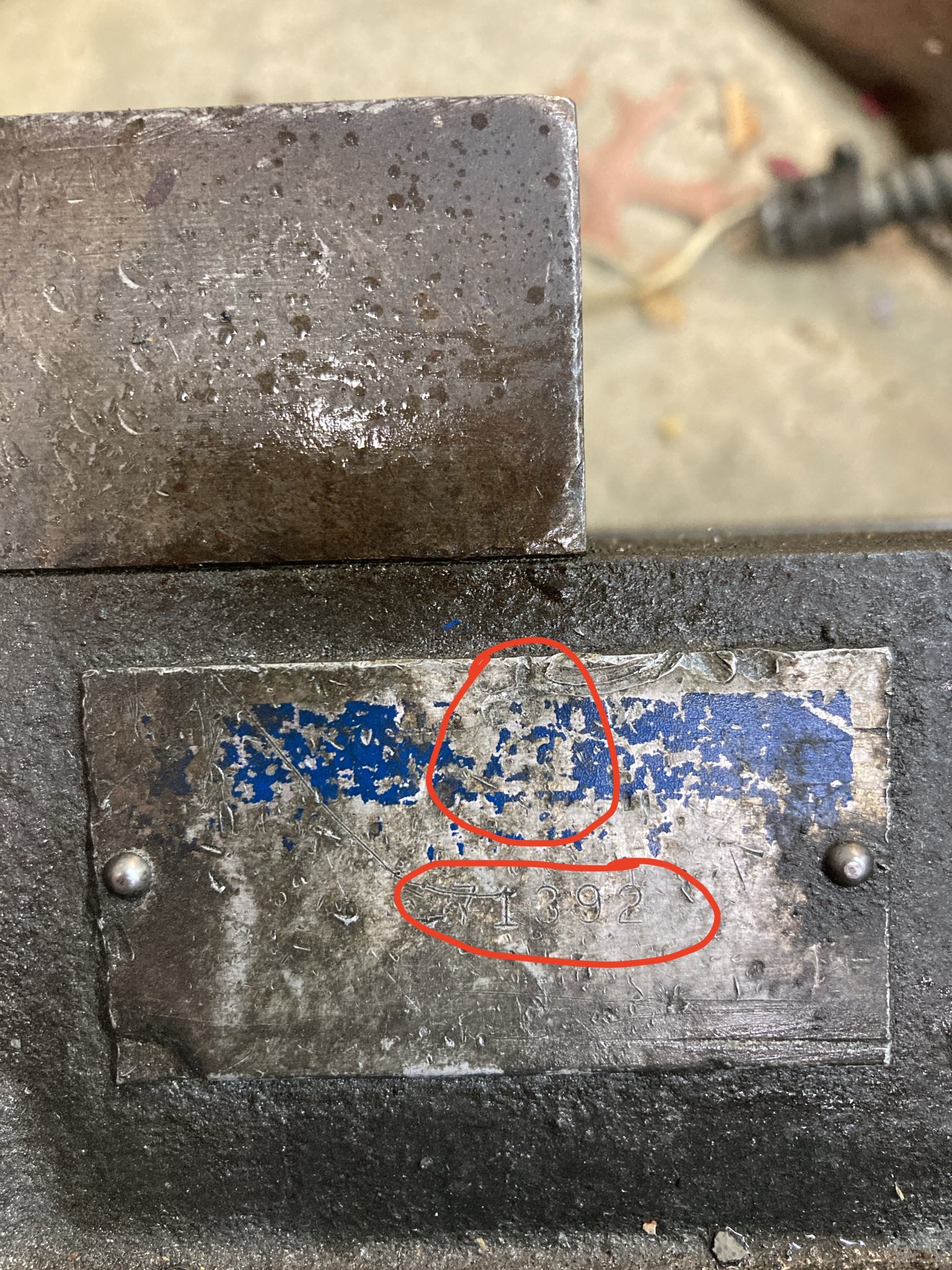

I went out and took a closer look at my vise(s) and one appears to be a “Genuine Kurt"
The tag is tough to read, but in the Tubalcain video posted by @Lil Foot , Mr. Pete points out the “slanted L” in the word ‘angle-lock’” at about the 3:29 mark
I see that same “slanted L” on mine, as well as the “boss” that Bill pointed out, and the tag appears to have a serial number and is clearly blue in color.
And although it’s difficult to see clearly in the pics becasue it’s so dirty, the vice appears to have a “blue tinge” to it.
I am going to clean it all up and we will see.
I don’t think the other one is a “Genuine Kurt” though; It does appear to be an “angle lock” style.
No boss and no tag…..darn!
Here is the bottom of the “Kurt knock-off"
