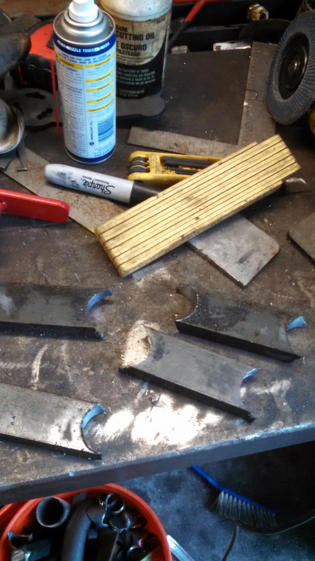

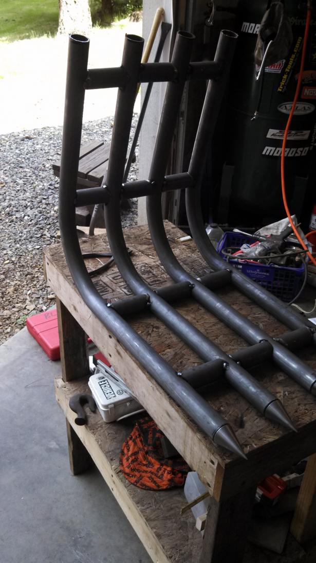

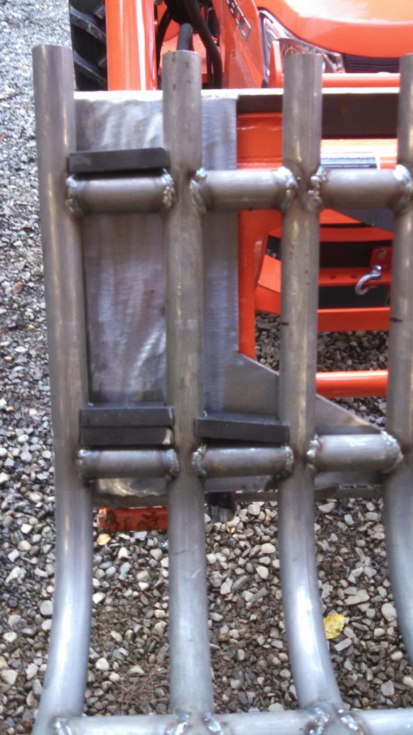

Allot of work left to do but this is as far as i got with my free time this weekend. Specs on the rock bucket..
Main material is 1.5x.120" wall DOM
teeth are machined from 1020 cold rolled, will be considered replaceable, I sleeved the 4 inches of the teeth with 1.25x.120 dom, in hopes to keep the teeth fairly straight. I'll post more pics as I move forward. I'll eventually be adding 5/8a round stock to minimize the gap for rocks to squeeze through. Just focused on the frame/structure for now
