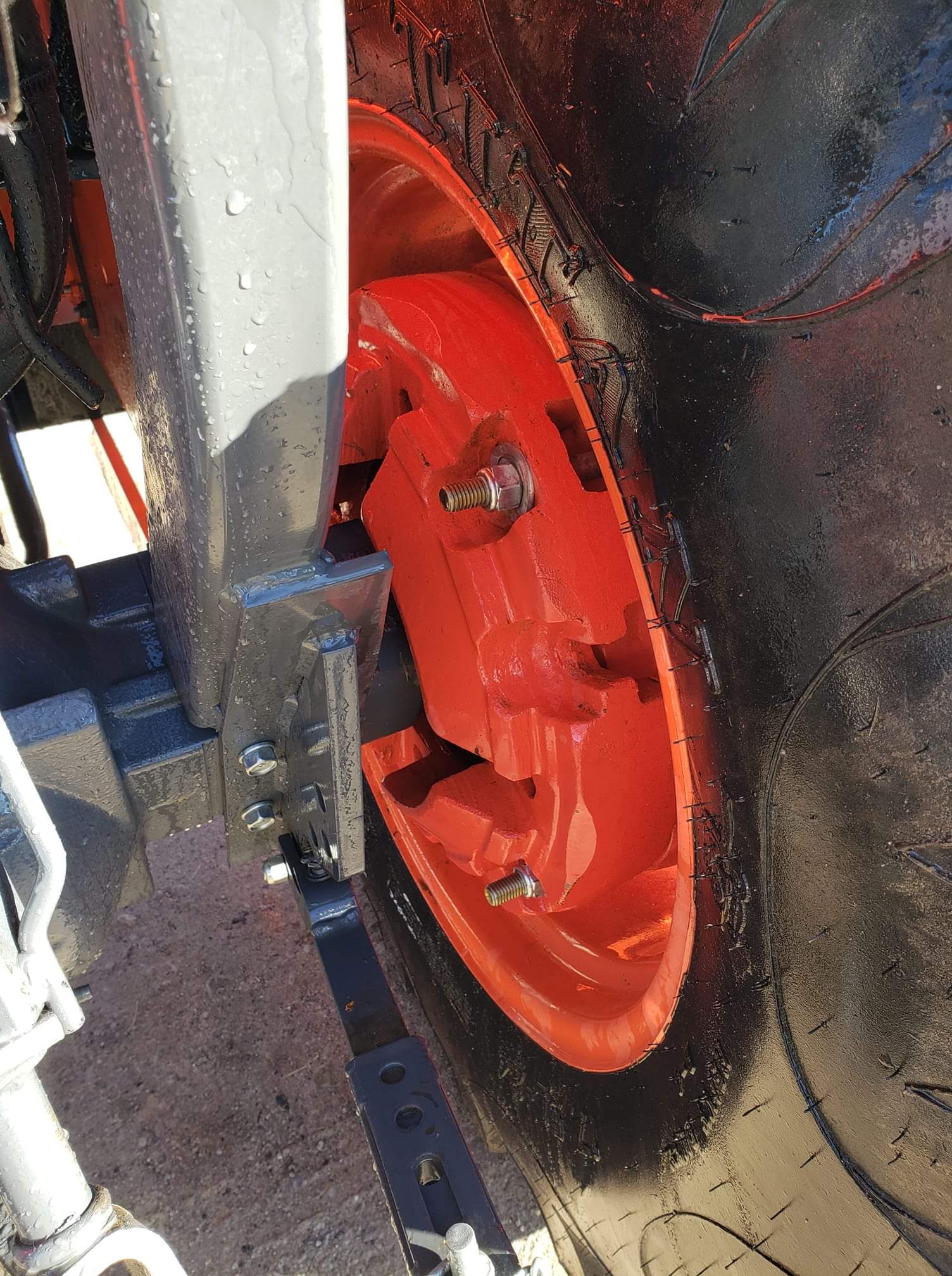

Thought about putting weights on the inside? This is from FB. A guy has 10 weights from EA on his MX. 2 on inside and 3 outside of each wheel. 53E69D98-FA15-4127-8959-0977B9C0D3D3.jpeg

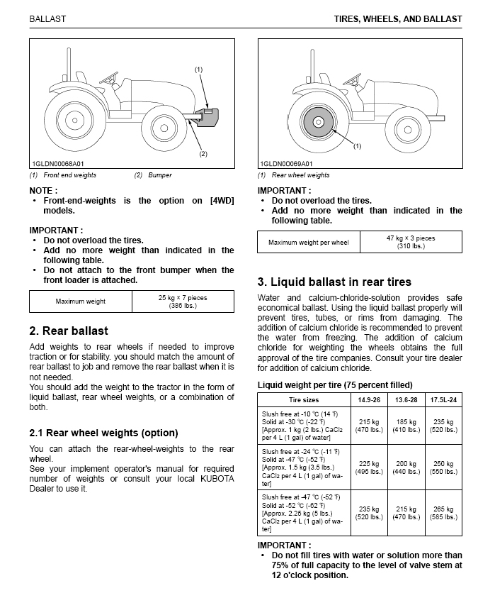

Kubota provides some guidelines for adding weight to the rear tires/wheels. They show 310lb as being the maximum added weight per wheel. The manual is for the cab and non-cab models but they don't make a distinction for each model.

Thought about putting weights on the inside? This is from FB. A guy has 10 weights from EA on his MX. 2 on inside and 3 outside of each wheel. View attachment 72264
That's a good idea. It would take some custom bolts to do that as the wheel centers only have one set of bolt holes on my MX-6000 to hold the weights on. We do run some inside weights on our bigger farm tractors but they are set up with two sets of holes in the wheel centers to bolt the weights to. One for the inside weights and one for the outside.

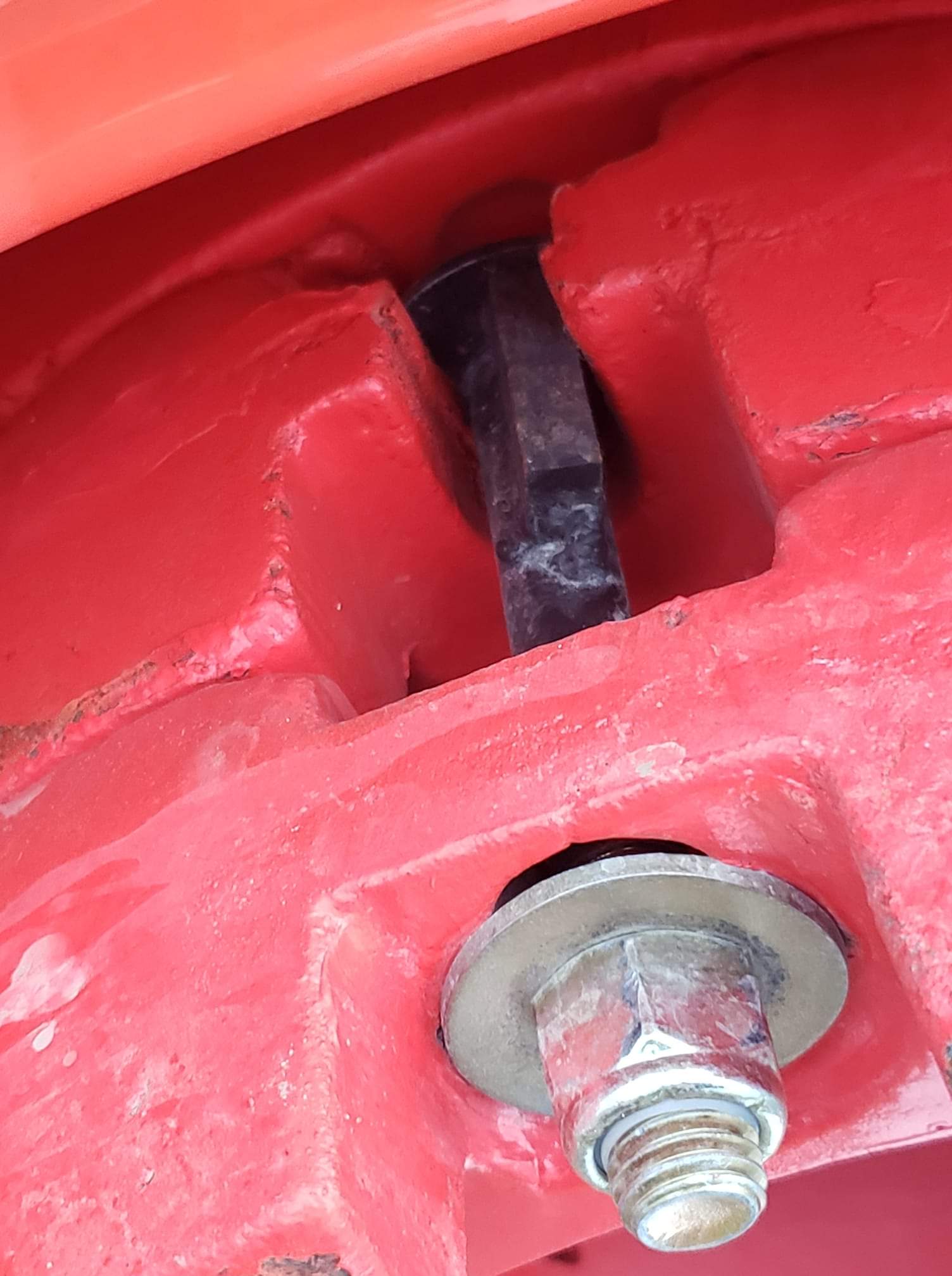

Here’s the other picture he posted. Says he welded square stock to the bolts. Not the best picture.
I was thinking some grade 8 all thread and clamp everything together through the square holes in wheel would work.

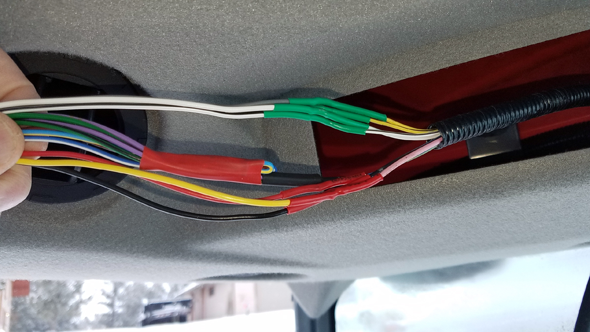

When I was at the dealership the day of delivery, I was given a Jensen JHD1630 head unit at no charge. The general manager claimed that he could install it in 2 minutes. Well, 10 minutes later he was still struggling and I was getting a little irritated watching him mess with my new tractor. When I was an engineering student many years ago I had a side business installing high end audio and alarm systems in cars and trucks so I really don't need anyone else's help. I asked if I could take a look and I could see that the screw at the rear of the head unit was interfering with a bracket and rubber grommet up in the headliner. I told the manager to let me take care of it.

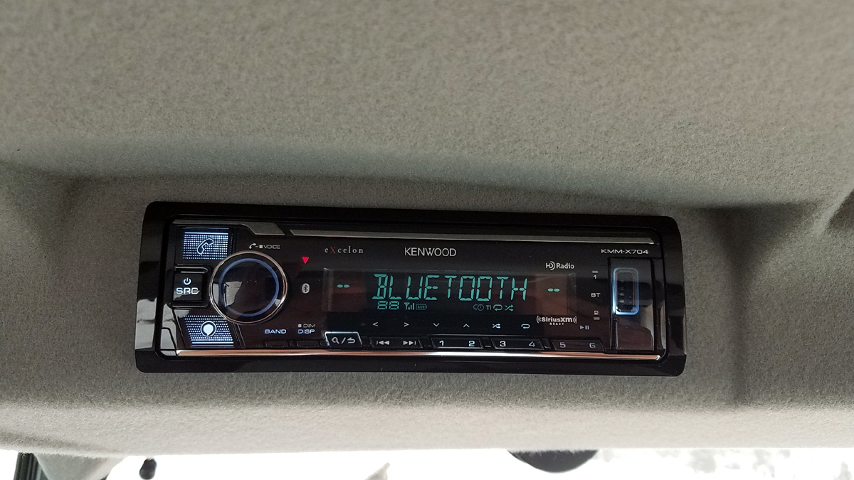

A few days ago I ordered a Kenwood KMM-X704 digital media receiver from Crutchfield that arrived today. It's much shorter (depth) than the Jensen and will drop in without any issues. It has Bluetooth, a microphone, USB and auxilliarly ports on the faceplate as well as a USB cable at the rear but I won't use that. I'm not expecting anything great but it'll be good to have some music if I don't want to use the Isophone earplugs. I'll post a couple of photos once I have the head unit and microphone installed.

I managed to get the Kenwood receiver installed this morning. I was going to use the wiring harness adapter that the dealership provided (KUB1 REV. A), but when matching up wires noticed that there was no provision for 12V constant in the harness which is weird. I decided to cut off the factory connector in the MX and solder/heat shrink the Kenwood receiver connector to the factory wires. I also installed the microphone but might move it to a better location (closer) once the weather is nicer.
This Kenwood has a lot of functions so I'll need to read the owner's manual to figure it all out but I did blow/push snow off the driveway after installing the receiver and I can easily hear music over the sound of the engine and engine/blower. I'm pleased with the purchase and the installation.
