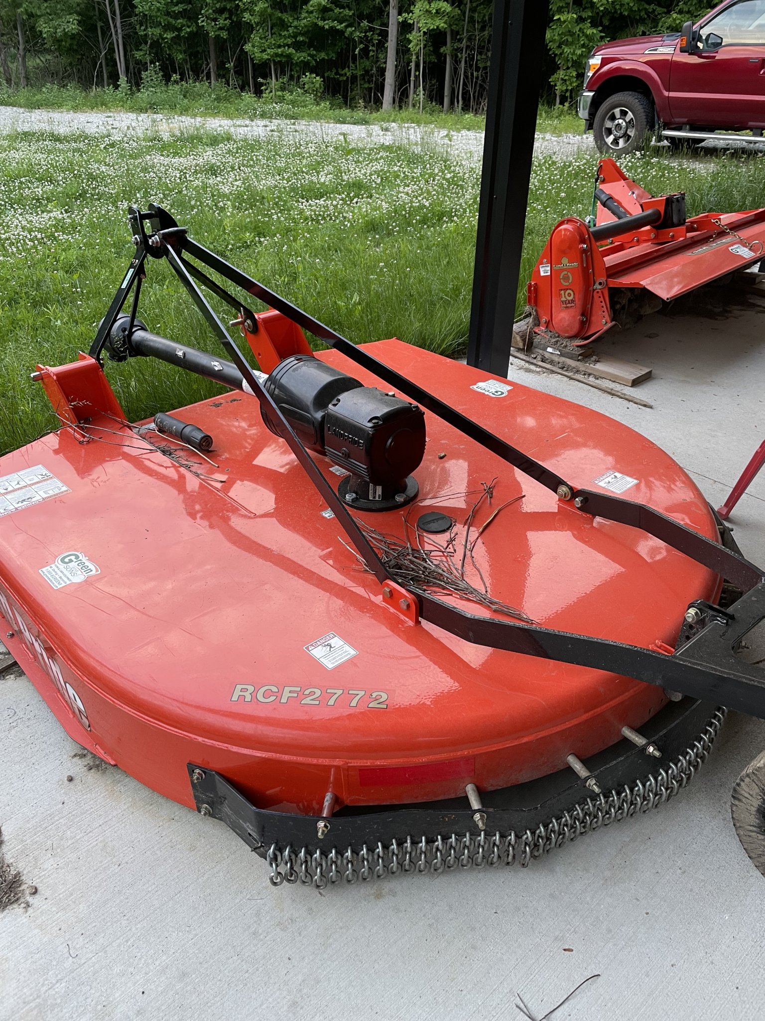

The LP 2772 has done all I have asked. I have bought more property since getting the cutter…originally it was for woods and trail use mainly, now I have a pasture. I wish mine was wider now and believe Mx has plenty of power to handle wider. I would buy a wider cutter now with no hesitation.

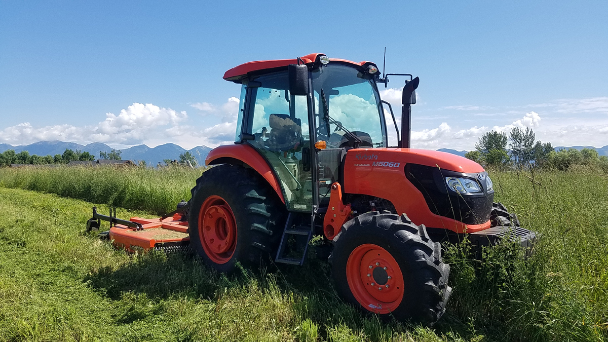

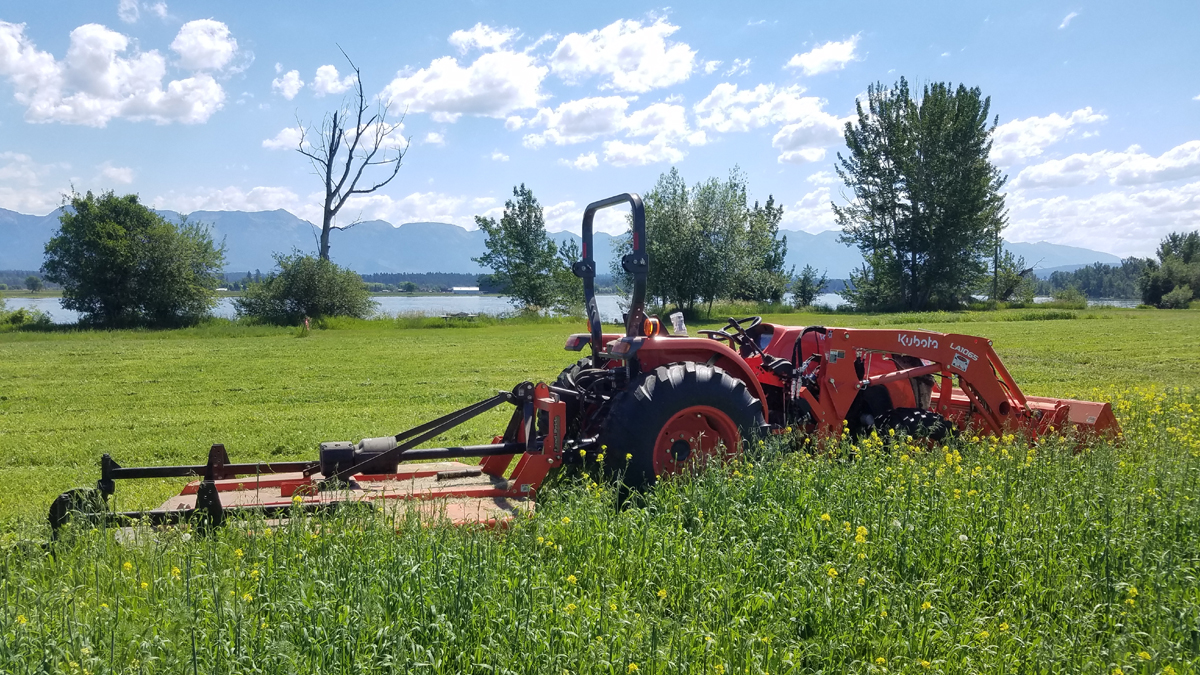

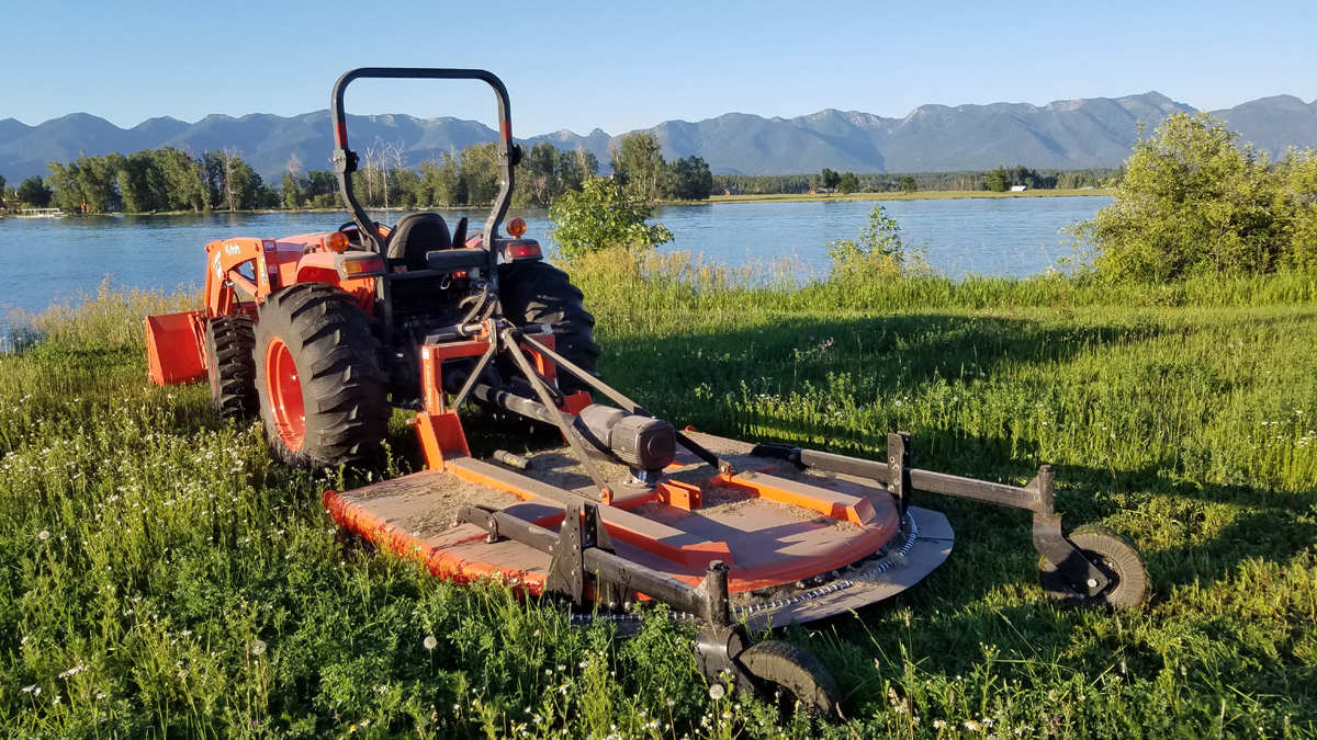

I've owned and used an RCR1884 for four years now, and have run it behind both MXs and the M6060, and although I've had no issues with the 7ft cutter, I would agree that a 7ft rotary cutter increases the chance of scalping vs. a smaller diameter cutter, but that's not exactly a shocking revelation. The RCR1884 is listed at 850lb without driveline or chains so it's in between the weights of the RCF2017 and RCF2772. Sometimes I think I should have bought a smaller but more robust model capable of handling abuse, particularly since I offer my services in the spring, summer and fall cutting unknown properties where obstacles are hidden in tall weeds or grass.

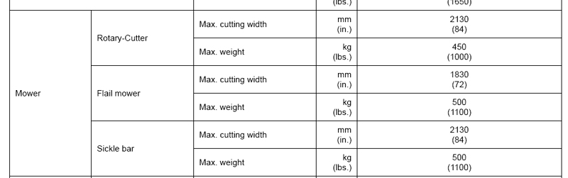

Here are the cutter specs from the MX5400/MX6000 owner's manual. You can see that the RCR1884 is fine according to Kubota, and the MX has sufficient power to meet the 45hp - 90hp recommendation for the cutter.
A bit of a tangent, but let's be honest about rotary cutters that are pulled behind a tractor. They aren't exactly the best way to do things. First off, you're driving over stuff before you cut it, and the blade cuts towards the tractor on one side and away from the tractor on the other. Both of these limitations to rear mounted rotary cutters can produce less than ideal results. The larger the cutter the more significant that affect can be. Flails result in a better quality cut i.e. more consistent regardless of ground speed since the hammers or knives are all cutting in the same direction i.e. towards the tractor.
I've never found the MX lacking in terms of PTO or engine power for the 7ft cutter and my place is very hilly, but I'm not hacking through 2" woody stems either. The only time that I raise the gauge wheels off the ground is when I'm driving on/off a trailer, or navigating an obstacle or weird transition, but at those times I'm moving slowly and not bouncing the cutter up and down on the 3-point.
Last year I bought an RC3712 which is kind of like pulling around three 5ft rotary cutters (6" of blade overlap). It does a much better job than the RCR1884 because the wheels of the tractor are rolling over less vegetation per pass, the cutter is better able to adjust to changes in the terrain, and there's less likelihood of scalping. Anyone wanting to cut or clear large areas in significantly less time and with better results might want to look at folding rotary cutters. The RC3712 has been a game-changer for me.

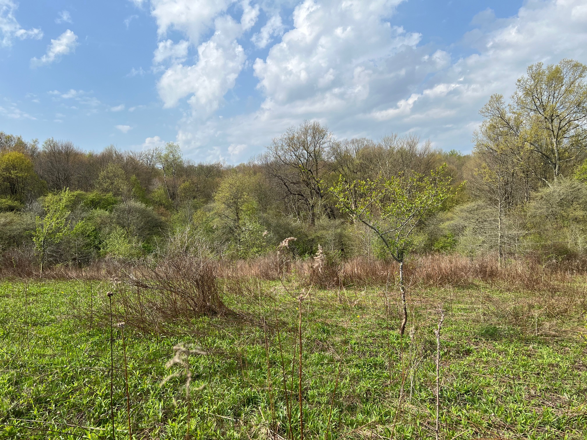

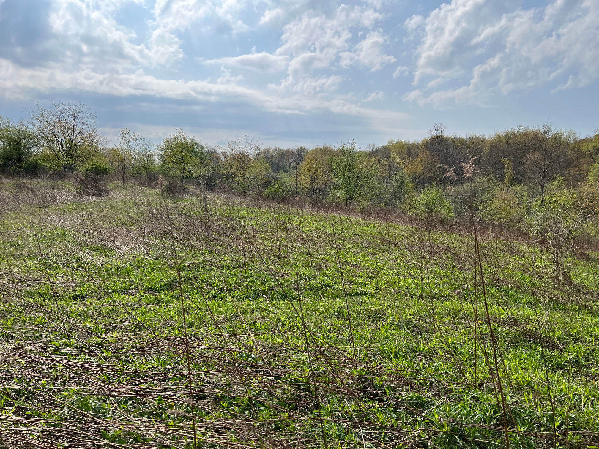

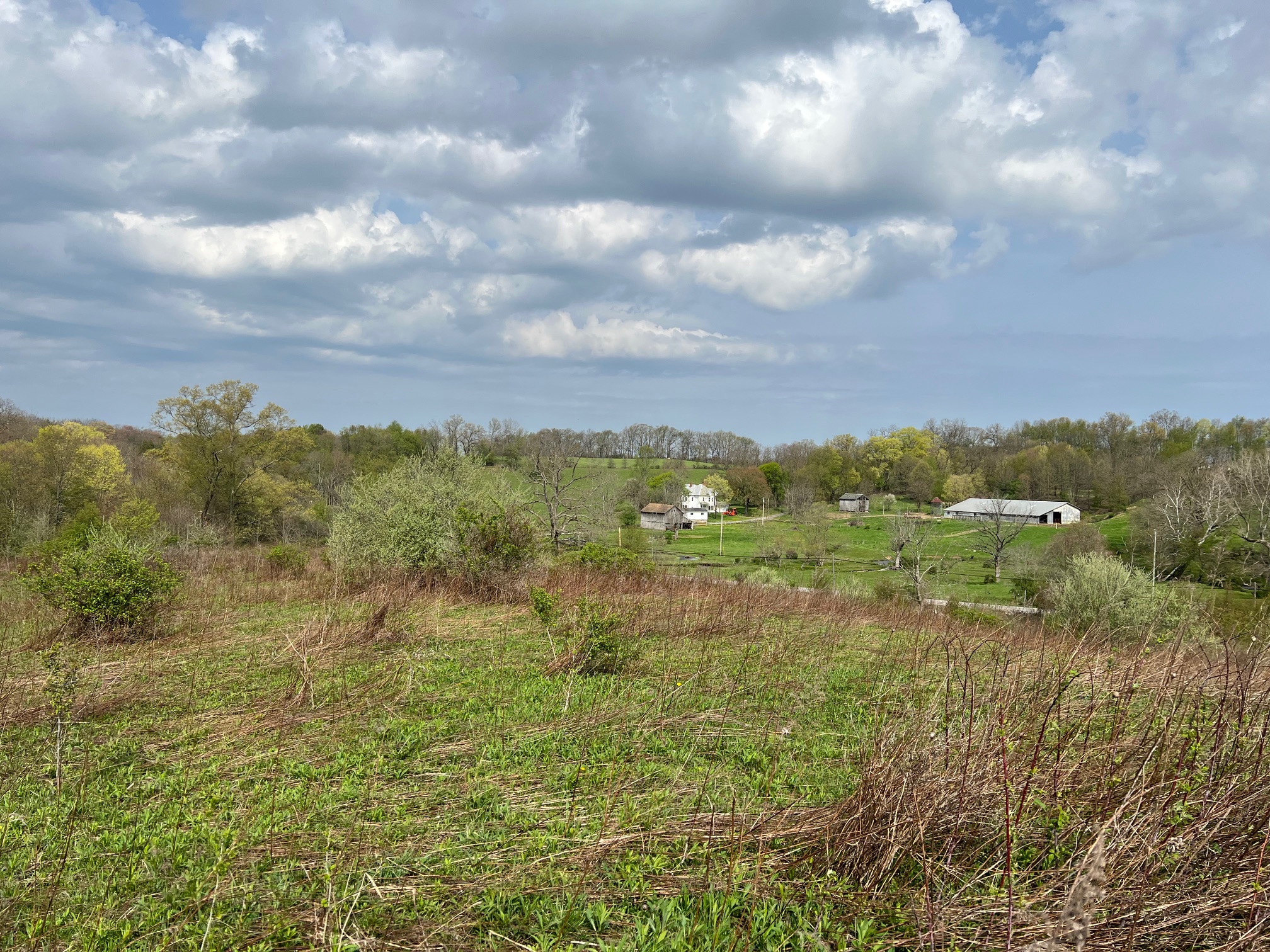

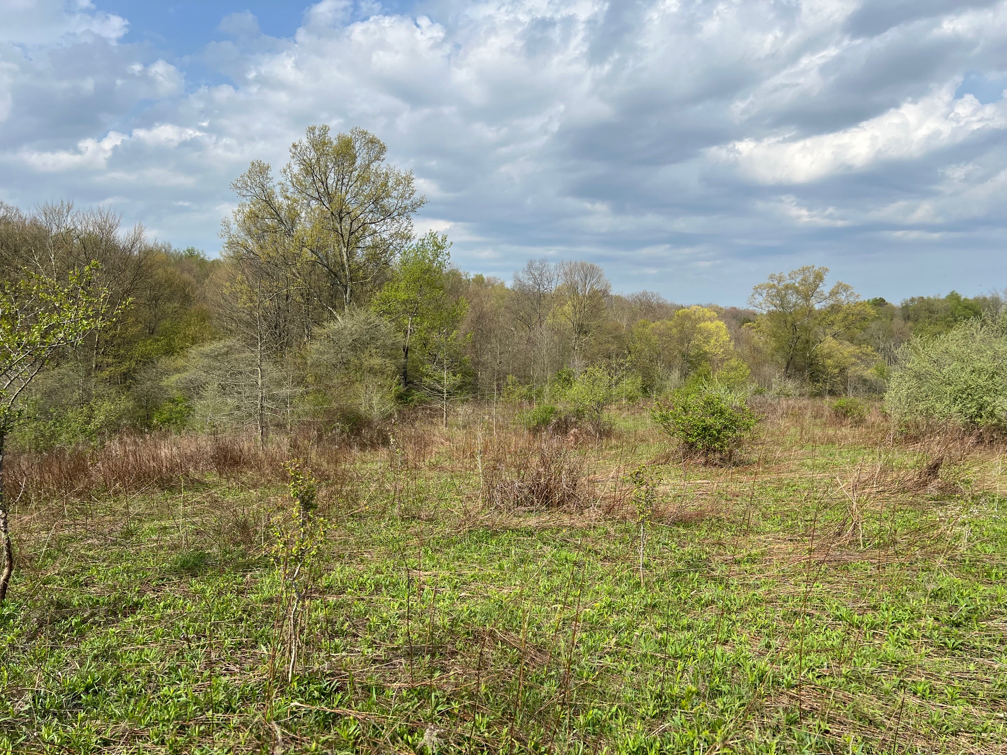

I appreciate the reply on my post. Attached are photos' of some of the acreage I will be cutting. It is very rolling. Any further comment is appreciated.

Nice property, and from where I sit it doesn't look that challenging, particularly for your MX.
I bought the RCR1884 on the advice of the local dealer and it has worked very well for me with no scalping issues of any kind cutting 50 or so acres. The specs state that it can cut as short as 2" but I don't use it as a lawn mower. I'm typically cutting down to the 3" to 4" range, and obviously the lower the cut height the greater the chance of the blades contacting the ground.
If I were buying a rotary cutter again I would most likely opt for the RCF2772 that @GrumpyFarmer has (or a similar model from Woods etc.) not because I'm against a 7ft cutter, but because I'd want a tougher, heavier cutter that's built to handle more abuse. I faced a similar decision when I bought the RC3712. It was a few thousand more than the RC2512 but it's around 1,000lb heavier because most every part is beefed up.
