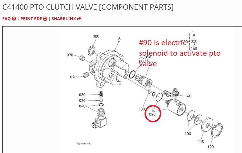

Instead of working through some of the systems, instead I entered pto and was presented with a list of the sections with a pto connection.
Clicking on one of the options provided yielded:
Since you are trying to figure out why your pto is not engaging, likely it is possible to check for power reaching the solenoid inside the valve. Power to the solenoid is going to be controlled by safety systems.

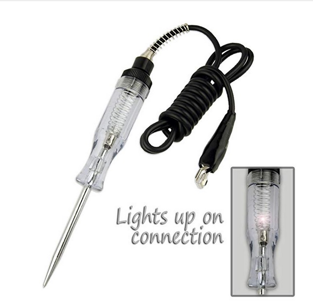

If you do not have one, a volt test light is the easiest way to check for power. cost less than $20 on line or at auto parts stores.
