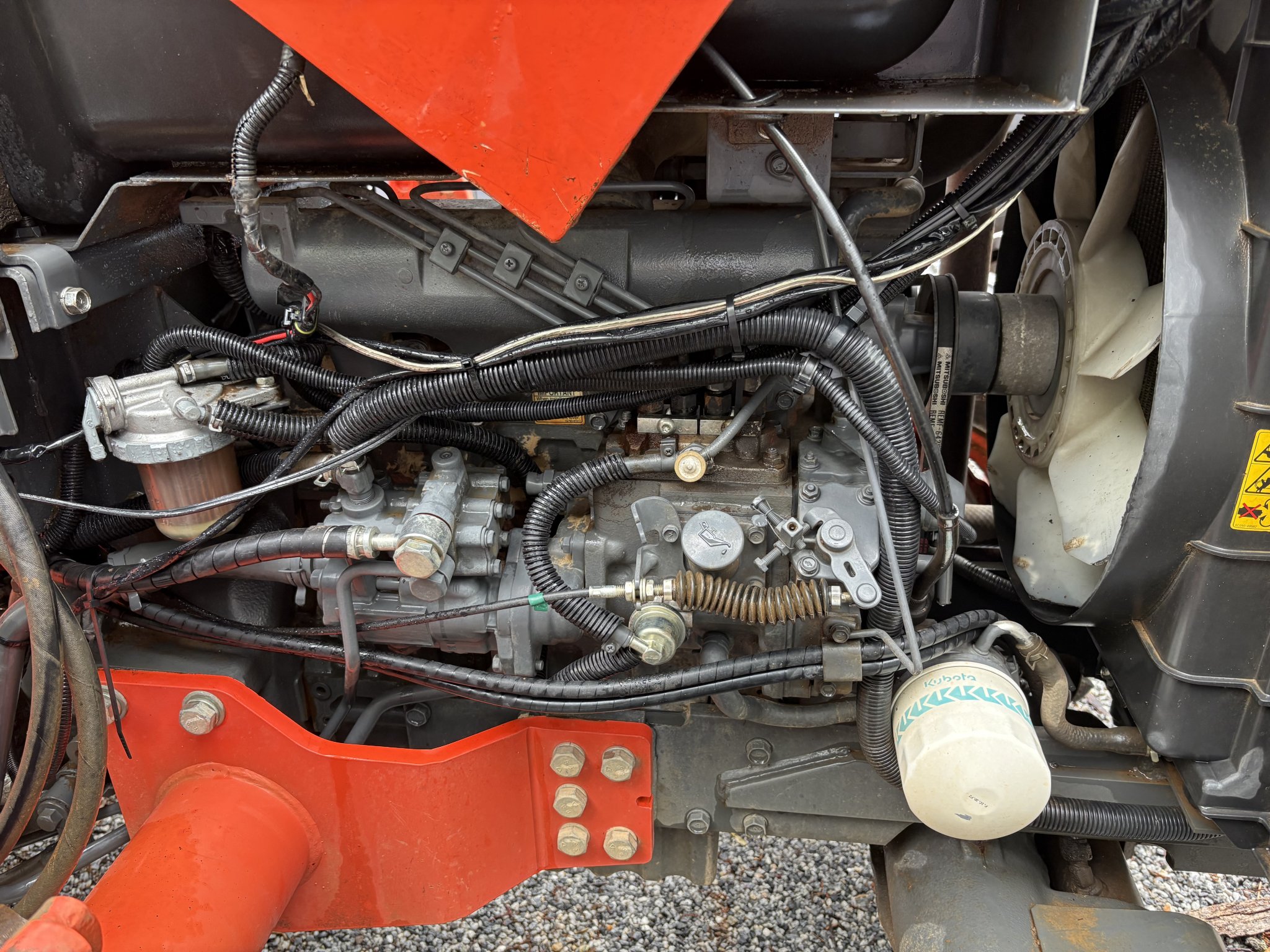

I went and bought fuel filters from the local Kubota dealer and I only have one filter in my tractor and neither filters they gave me are correct. Here’s a shot of the fuel filter setup I have. One single filter similar to a car style. Thoughts. Production model changes I’m sure but want your opinions. Thx

Title says MX5200 but your profile says MX5100. Picture looks to be a MX5100.

MX5200 is a common rail and takes two filters, whereas your MX5100 is mechanical injection, which only uses one filter.

Thanks everyone! I had a brain fart thinking my tractor was a 5200 and while doing my oil change I looked at the hood emblem and was like “Duh”! Senior moment I guess.
