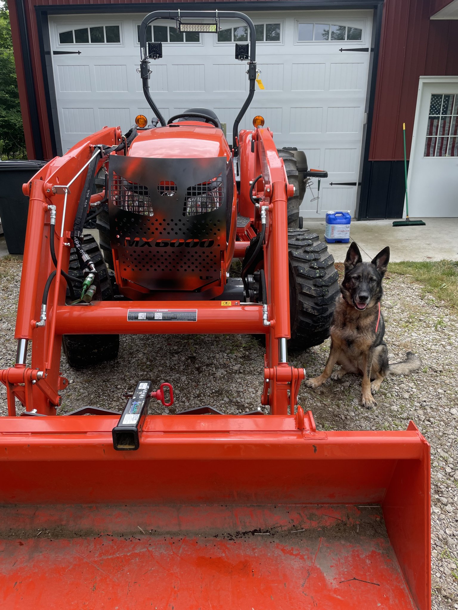

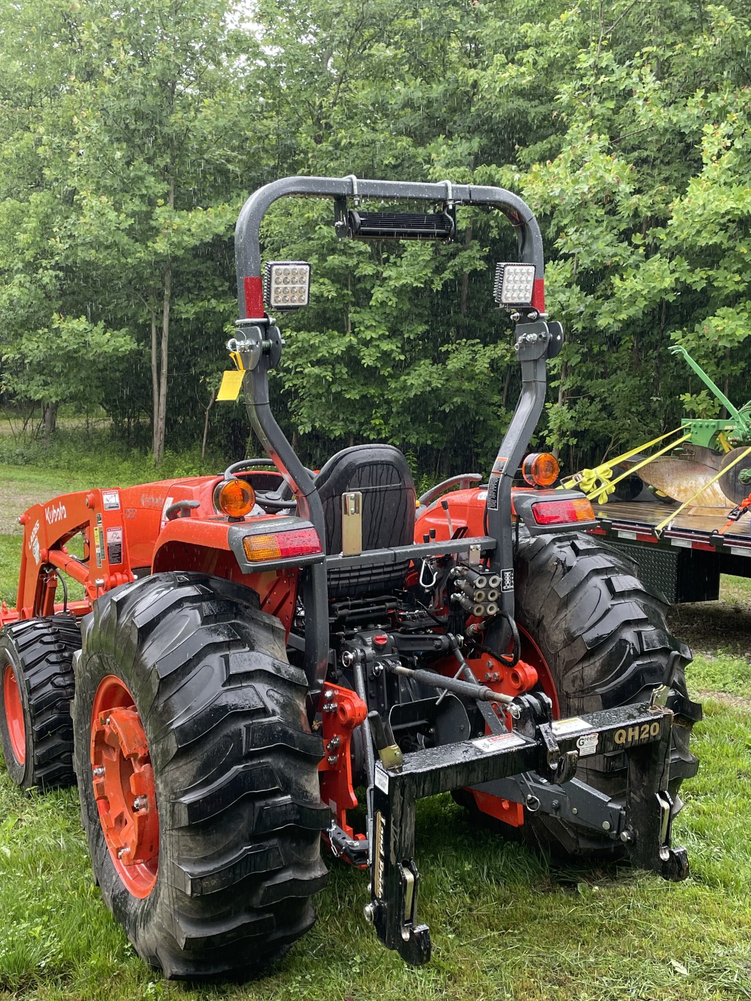

I don’t really know what is recommended for your machine, or how the plumbing works, and I don’t know the spec differences between your machine (that’s right I don’t know much 😂)and mine…but I bought this in Ohio (I see you are from the great state as well)…Green and Sons set this up for me and it has 3rd function, 3 rear remotes and a BH92. So I think your original post is possible. You asked for pics, here are the pics…I don’t know how to do myself, but I would absolutely recommend that dealer mentioned above. I hope this helps. 🥃

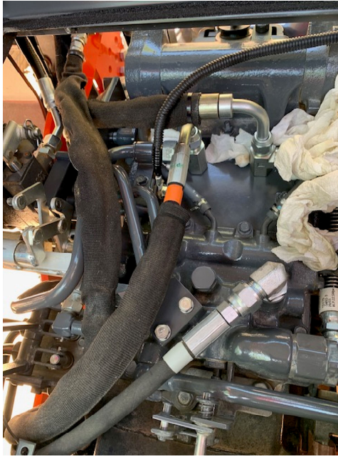

Seems to come up often. This is of a gl60 however, functionally it is the same. Gray is optional direct to tank from third function. The hose elbow from the left(orange) is from the pb of loader valve. This feeds third function solenoid. The pb/return from the solenoid block will then go to inlet of bh(far left west hose). The outlet/pb of backhoe goes to right inlet elbow, this feeds the three point. The two hoses going to the top left of the picture form the bh loop...
This is on my tractor I just used the other day. The tractor has front third function with remote hydraulic ssqa, factory backhoe, and three rear remotes. it all works just fine. Just MAKE sure to put the backhoe just before the three point in the pb circuit otherwise you can mess up the seals from the pulsing pb pressure loading, which is why they prob say you cannot do this. However if you install it the way I describe it is no different than the loader>bh>three point. Dealers mess up trying to give more priority flow to the bh, and that is a mistake.

A picture of the plumbing. with 3rd function and backhoe. Quick couplers for connecting BH92 all the way on the right:
